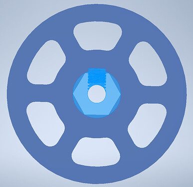

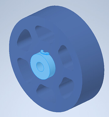

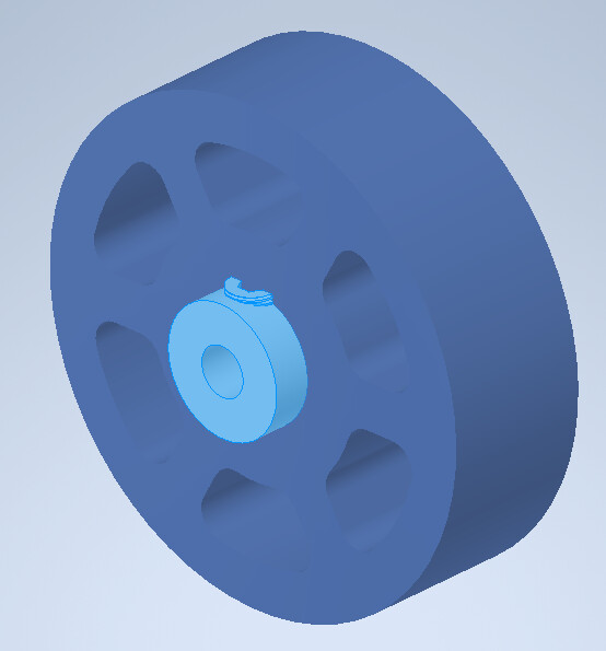

It may stretch over a shaft collar.

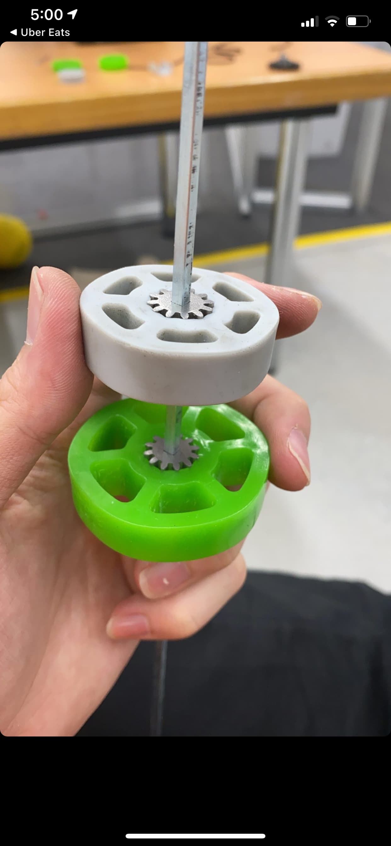

They easily fit over a 12 tooth HS metal gear.

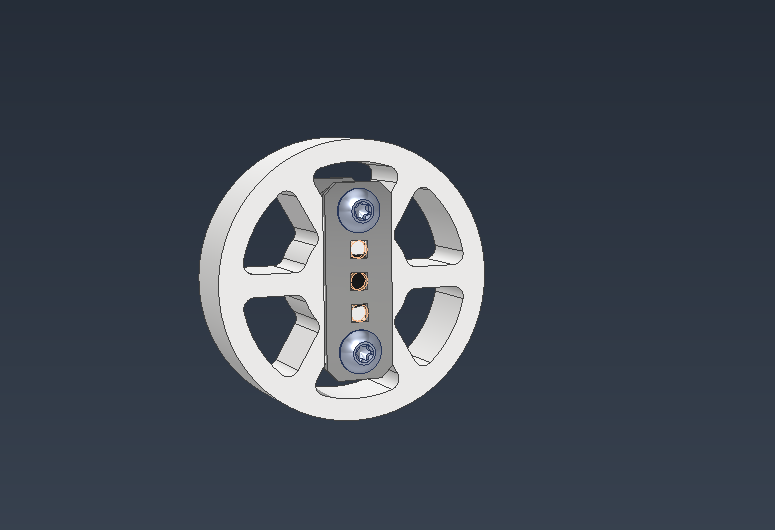

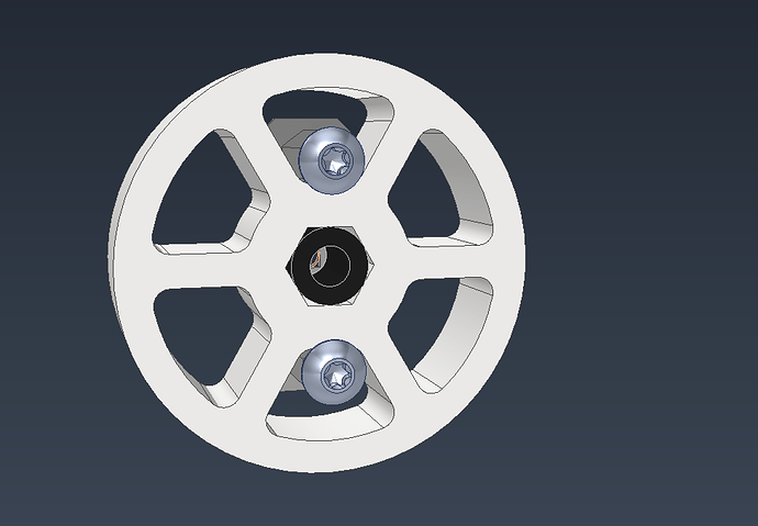

Here’s how I like to do it:
put a HS 12t metal gear in it and sandwich it in between two polycarbonate circles (≈1” diameter)
can confirm
Sliding them over the low strength clamping shaft collars without the clamping hardware works pretty well. Seems really hard to slide off.

  • 12t HS gear

  • LS clamping shaft collar
  • lockbars and screws through spokes
