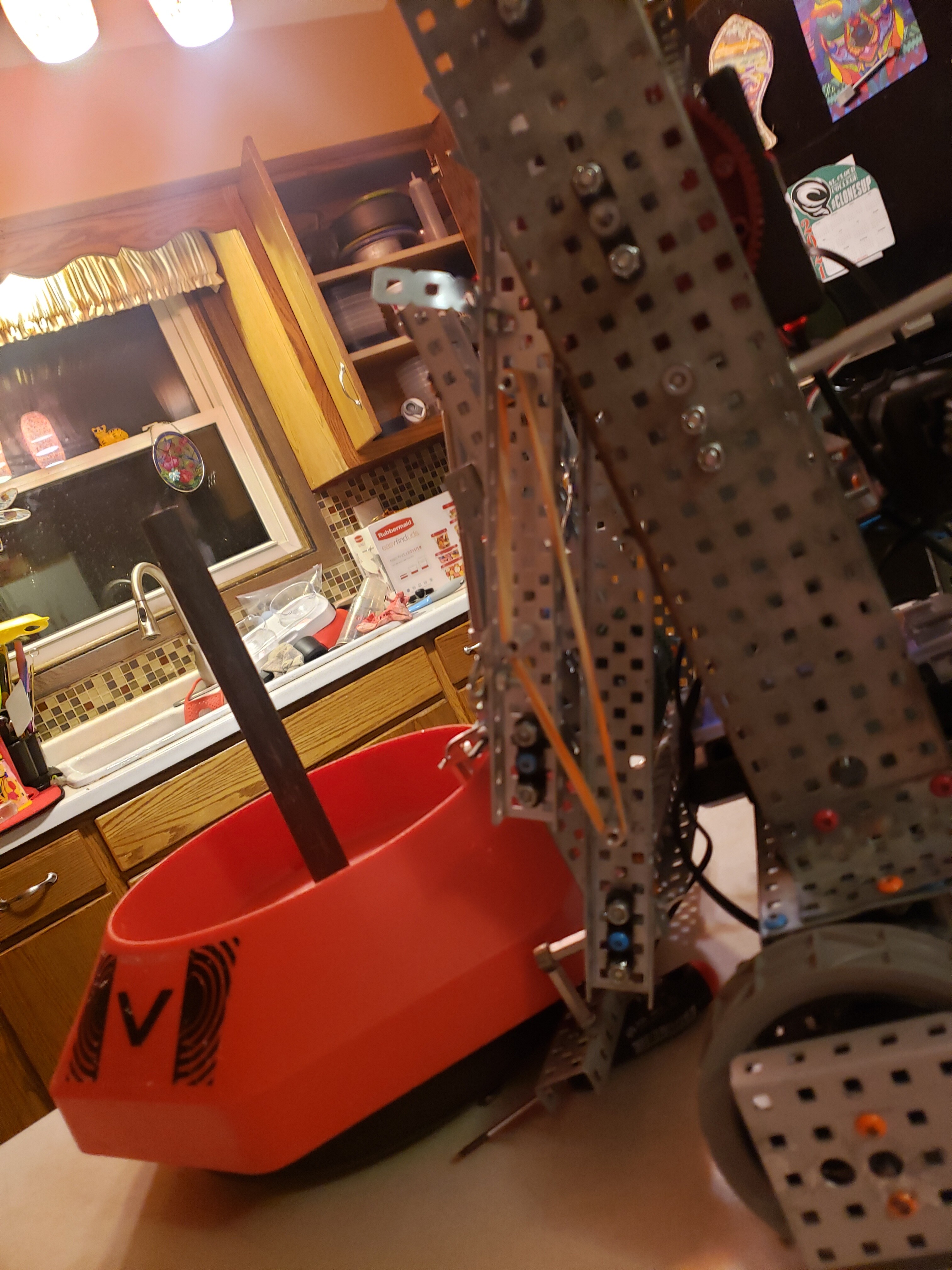

Hi. Is it possible to make a basic 4 bar to lift a mobile goal with no struggle with normal axle? I do not want it to be too slow, and I have no access to long high strength, and they have their own issues too. Thank you for replying.

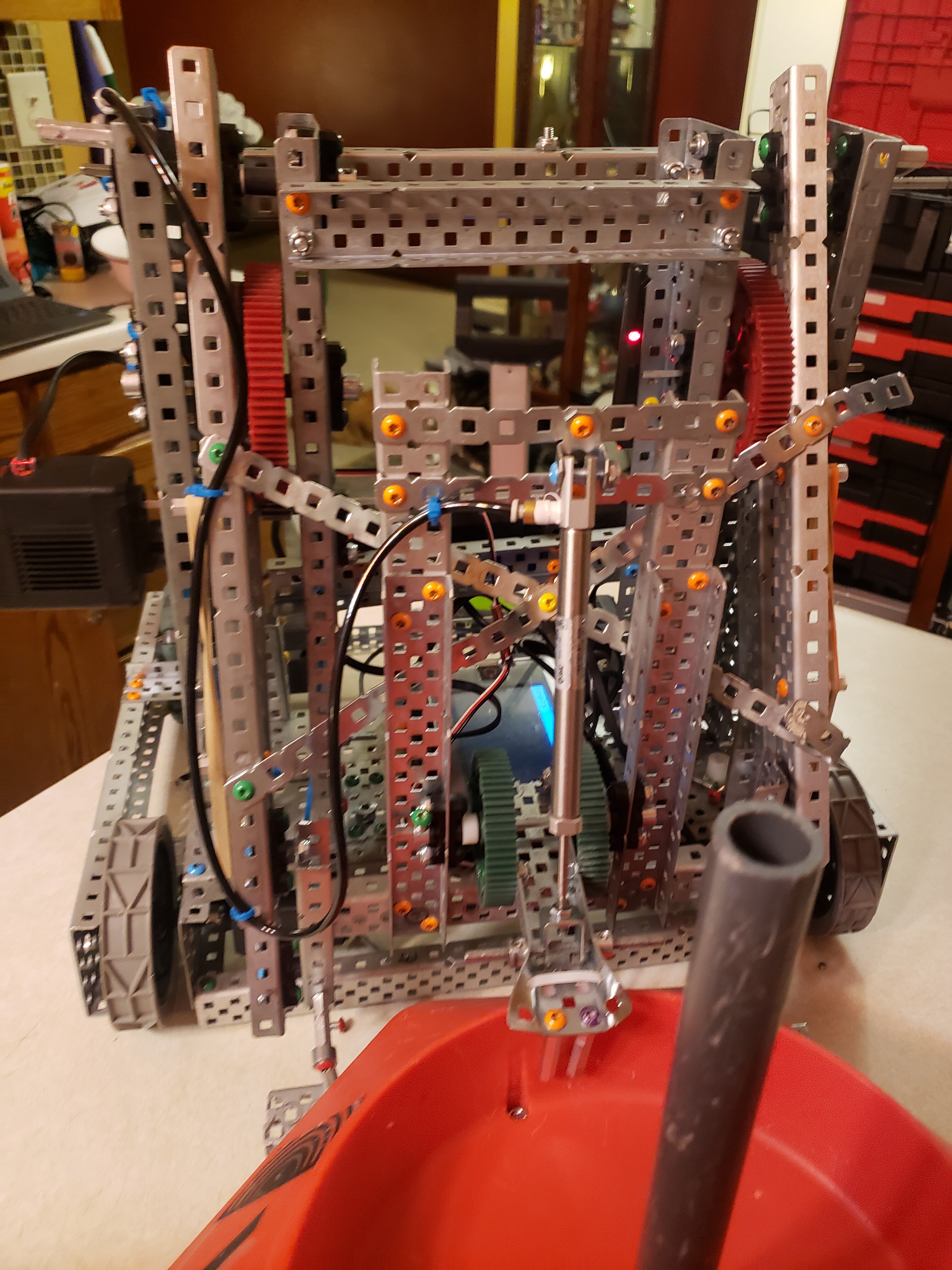

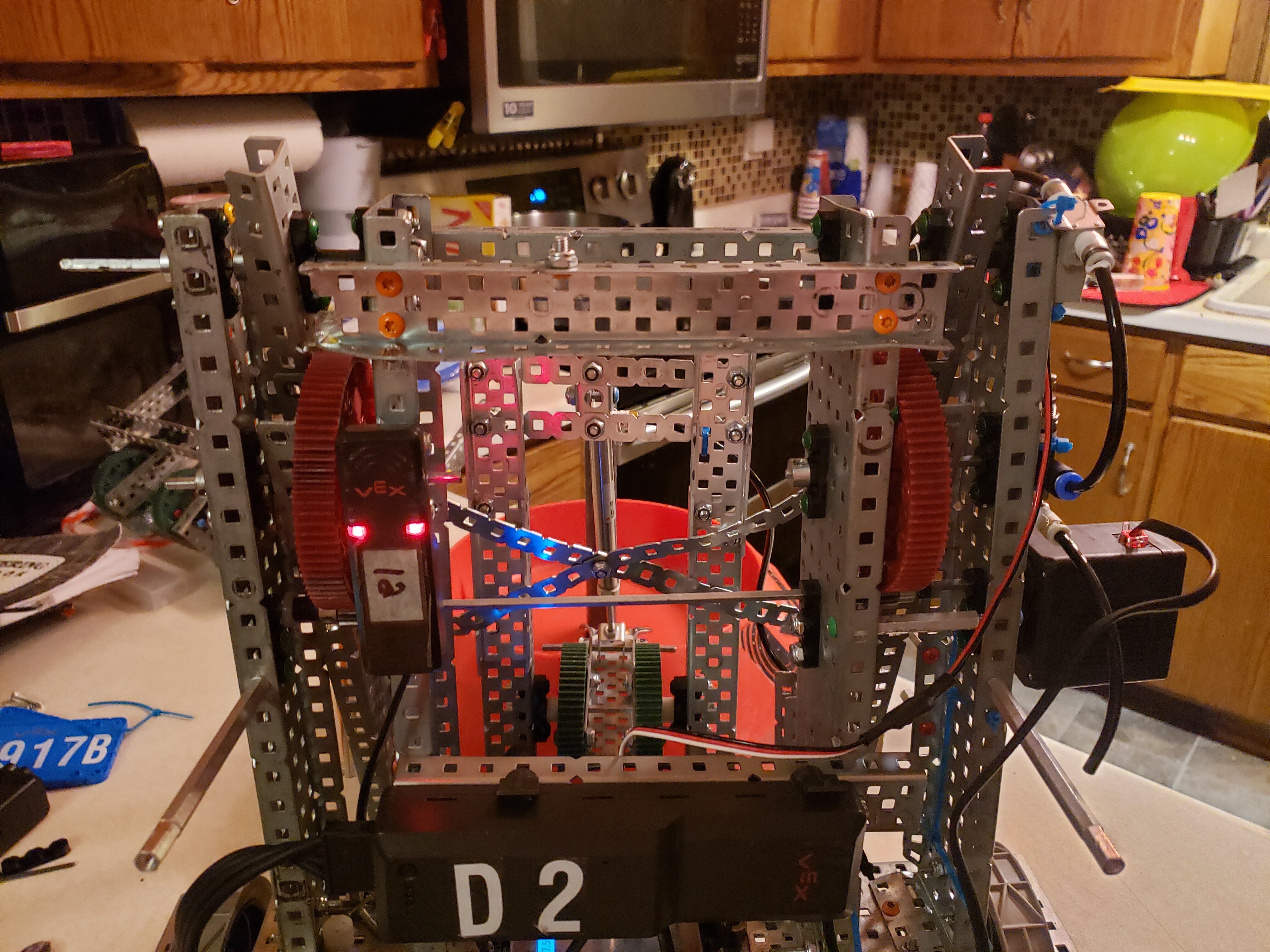

Currently, with everything as it is in the pictures, at 100 rpm, on a green motor, it does not work. I tried whatever I can think of. Any suggestions?
Thank you for reading!
setting a green motor to 100rpm does not increase the torque. By 100 rpm, we’d meant to use a red motor cartridge to halve the speed but double the torque compared to a green 200 rpm cartridge.
Oh. Lol. That is my fault. I will try again!
make sure to add some more rubber bands to the 4 bar but your setup should work pretty well.

increase the gear ratio you can compound it if your already at the 12 to 84.
that could be an option, you would want to screw the gears together because a compound ratio might bend an axle by the motor.
something like 1:7 and then attach a 36t to the 84 w/screws and then 36:84 and the 84 that connects to the bar

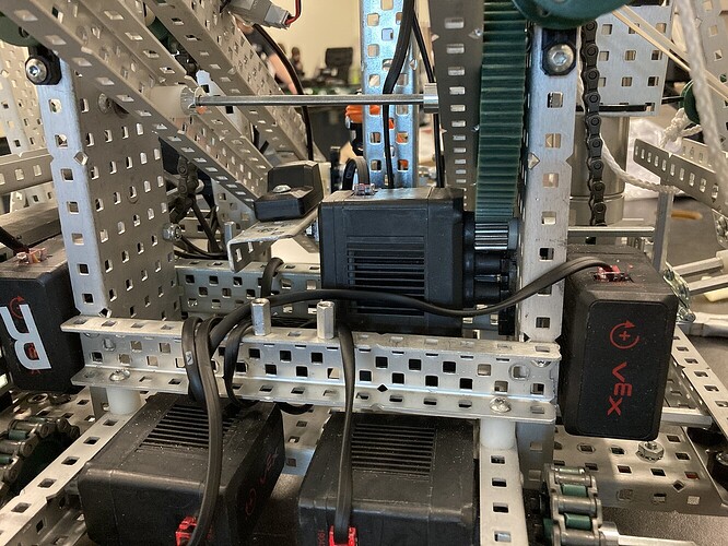

We did a 1 motor 4- bar like this, it was fairly fast and had little to no struggle ( I believe it is a red cartridge)
Full robot: 7996B mid-season reveal (videos coming soon)
That gear ratio should be able to lift with a 100 rpm motor easily. We use 100 rpm with a 12 to 60 and we have no problems, you are using 12 to 60 so you should be fine.
You might want to look into how you’re retaining this shaft. It looks like there is nothing holding the shaft in the motor
I wouldn’t be surprised if you had unnecessary friction here too from the gear being squeezed between the spacer and the motor. In fact it looks like the gear is being leaning towards the left
We fixed that after this picture, we put a small c channel over that shaft collar to stop it from falling out. It never fell out, but just to be safe we added that.
That is just the angle of the picture, we noticed that it was close, but it never rubbed the spacer, I think the spacer wasn’t bigger than the gear, but I can’t remember
