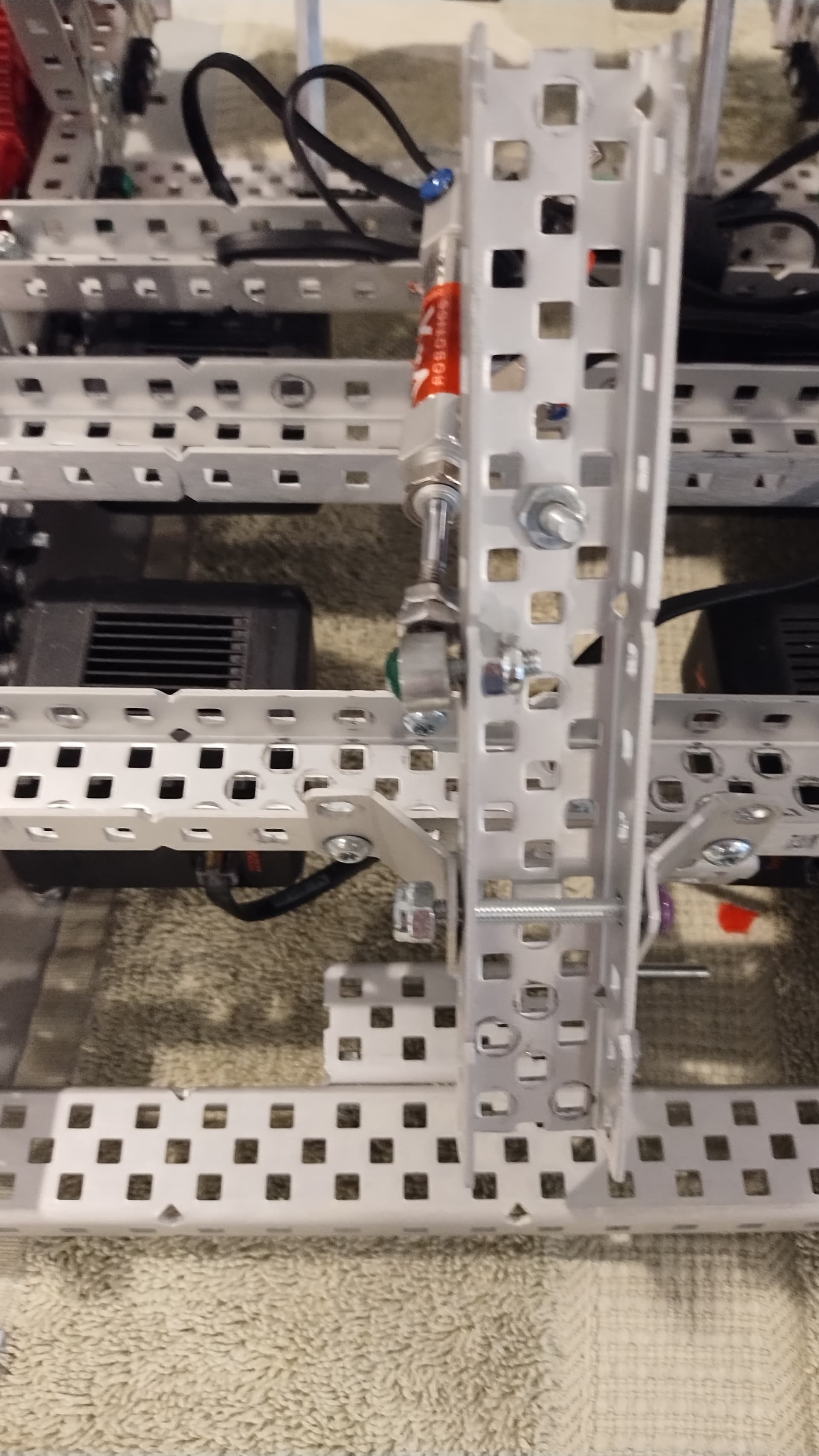

I have been trying to design a 1 cylinder mogo clamp but no matter what I do, after 3 or so actuations, it is no longer strong enough to tip the goal. I have tried rubber banding and adding an ‘upside down’ ramp for it to slide down but it just isn’t working. (I can add pictures later if wanted)
Yes please add pictures, need to see what is going on. Where you placed the piston, for example can make a big difference.

(Yes always send pictures if you can) inferring here it’s probably that you piston does not have enough leverage but that’s just a guess.
In addition to trying a pressure regulator, I would also check your pneumatic tubing for leaks.
ok I’ll send pictures when I can. I am currently using a pressure regulator. When I try giving the piston more leverage, it then doesn’t move the clamp far enough for the mogo to fit underneath is the problem I’ve been having. I could possibly use a longer piston, but that will use even more air when I only have 1 tank.

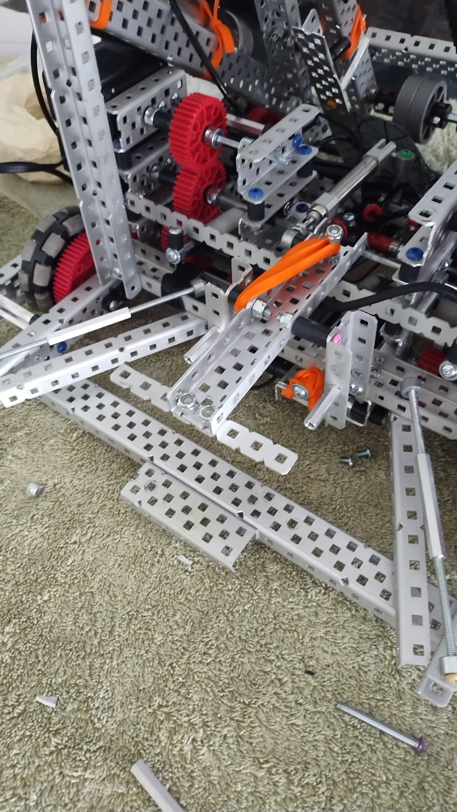

Ignore all the jank. I’ve been messing with it the screws aren’t tight

my best guess is you’re losing air through through one of the tubes, or maybe the piston itself (they don’t last forever, especially if they’ve been mistreated on previous robots), so try replacing that stuff first. if not, you may want to try supporting the arm on both sides to avoid torque twisting, which could even be the reason you’re losing air.

In basic lever logic, the further you move away from the support point, the easier it is to lift, so try to hold the part of the piece you are trying to hold the mogo that will connect to the piston a little longer.
connect the piston a little higher
  1. Mount the pistons higher up on the clamp
  2. Unjank it. Tighten every joint. Doing this will make your power transfer more efficient and gets more “bang for your buck”

Thank you for all the advice. I recently fixed the problem and it works really well.
In case anyone was wondering, I basically redesigned the whole robot and not the clamp is farther back into the robot (so the mogo requires less force to tip) and I added a horizontal plate to better align it.
It actually works now with still a single cylinder and the pressure regulator down as far as possible.
I can get tons of actuations up until about 20 psi and can lift a full mogo up until 60 psi
