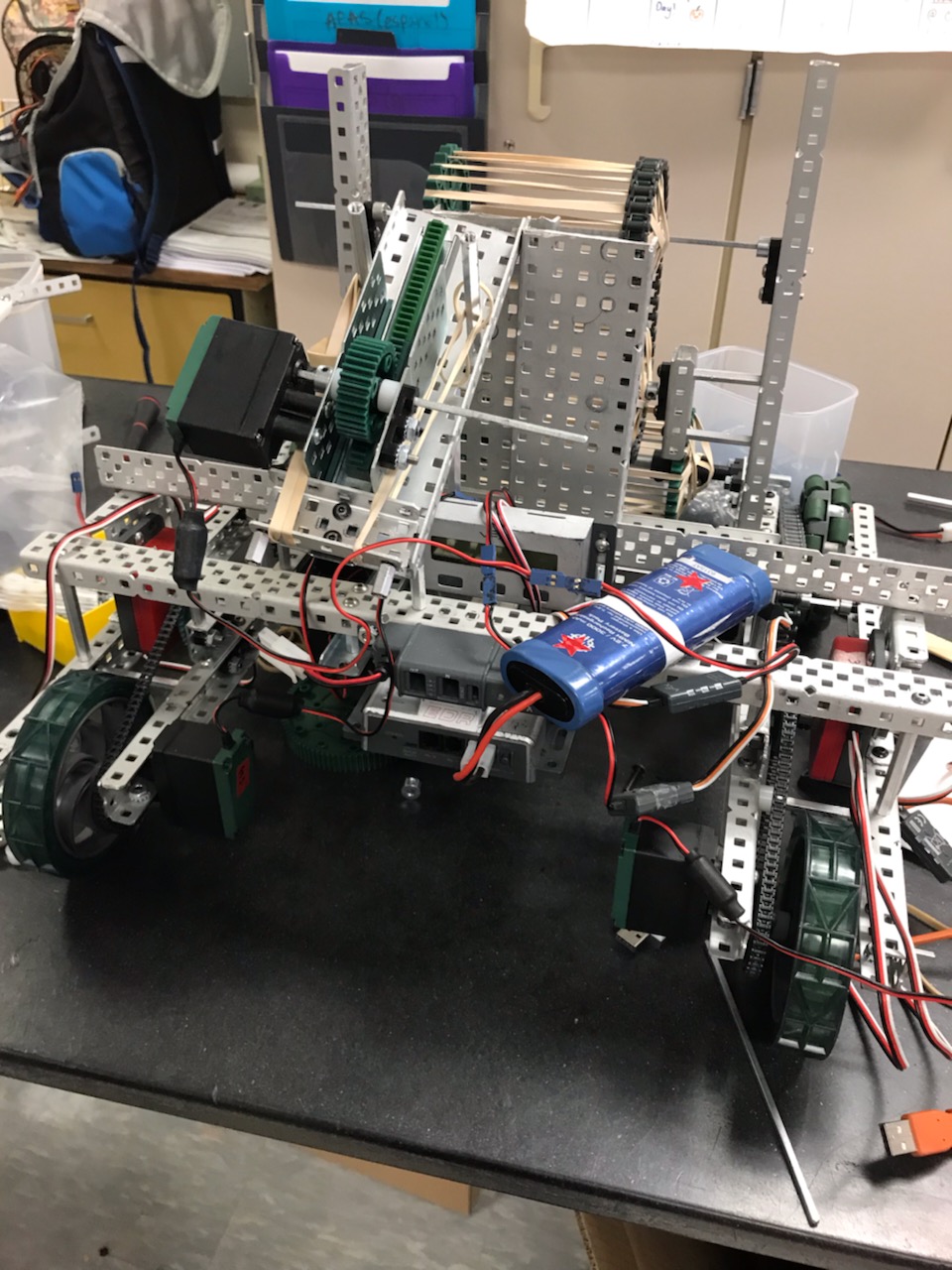

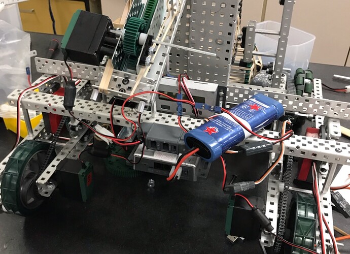

Heres a RD4B during the ITZ season as I was testing designs:
Would a 1by dr4b help support an offset two tower dr4b at all?
It would likely help the lift with horizontal stabilization but may cause other problems if you are lifting caps from the center since only on side is providing power.
Judging by what I see it would just add more weight and friction and not really support much with stability. I would suggest linking them all together with high strength axles if you’re going to be doing that.
