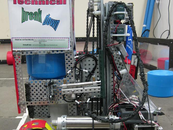

Our Robot consists of three major components: The Chassis, Lift, and Intake. All were built dependently for accuracy.
Chassis:
Our Chassis consists of 4 393 Motors (geared internally for Torque) chained at a 1:1 ratio.
We use mechanum wheels for our drive train which allow us to maneuver easily around goals.
Lift:

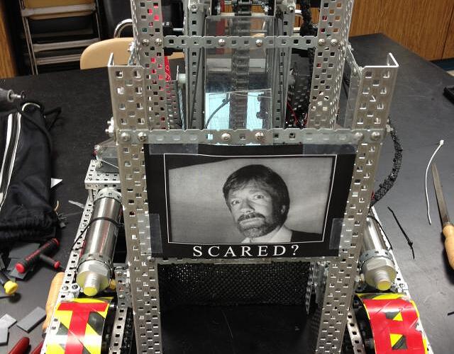

We have a 2 1/2 stage lift. The lift is run by 6-269 motors at a 3:1 ratio.
Our half stage is due to an extra 4 inches we need which proved unnecessary to add a full two more slides to give us 16 more inches.
Intake:

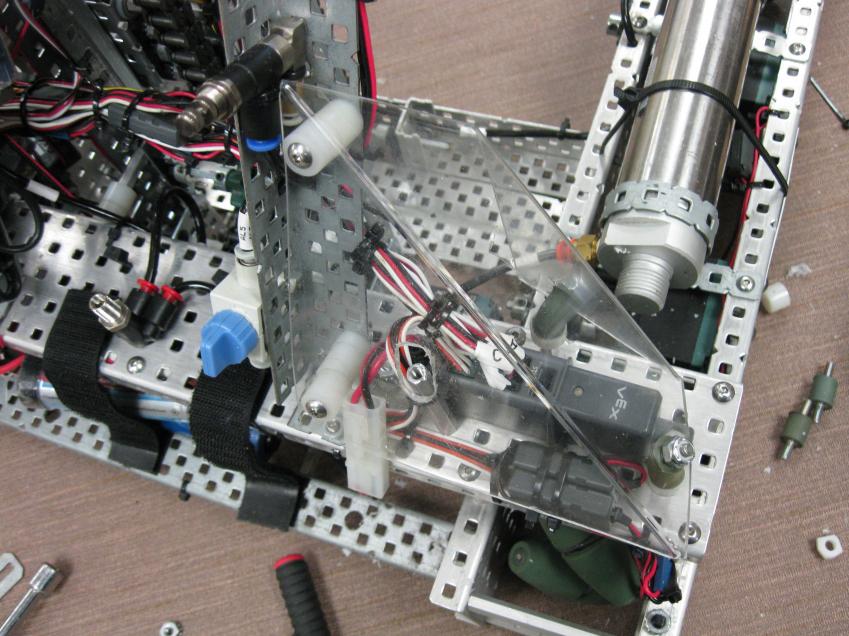

Our intake is 8 inches wide and 6.5 inches long. The front of the intake is open to allow us to drive directly into a stack of two objects without having to lift over them.
We have a pneumatic clamp which uses two pneumatics to pull the objects back inside the intake to prevent them falling out the open front.
Our intake allows us to hold approximately 4 to 5 objects.
Feel free to ask any questions or specs that we may have missed on our bot.

We have added a close up video of our intake on our facebook page which is the link on the first post. Watching it on full screen is the best view.
Our intake has four modified standoffs to line up objects very quickly for our intake.

Can you breakdown how the 2 1/2 stage lift goes together/works? For whatever reason, my brain has never been able to wrap around this lifting method…
So the motors are driven by three 18 tooth sprockets.
The chain runs over the top sprocket to the bottom of the “first stage” which has a 6 tooth sprocket.
It then runs back up to the top of the “First stage” again and around the sprocket at the top of the “First stage”.
Then it is repeated from the first stage to the second stage. The chain runs from the top of the “First stage” with a 6 tooth sprocket to the bottom of the “Second stage”.
The chain runs back up again from the bottom of the “second stage” to the top of the “Second stage”.
Finally, it runs over the top sprocket of the second stage and attaches to the intake which runs on another slide to give a couple extra inches, then down to the base of the chassis and back to the motors.
It creates a lock that allows each stage to pull up separately. I will try to get a picture of it tonight.
Hope I kind of helped with description. :smiley:
