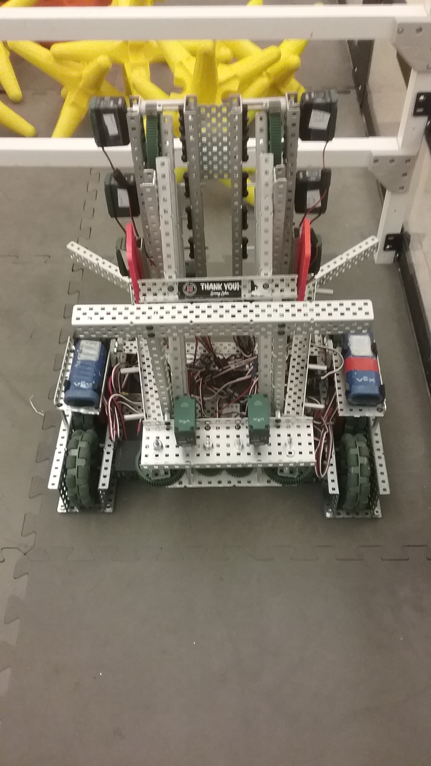

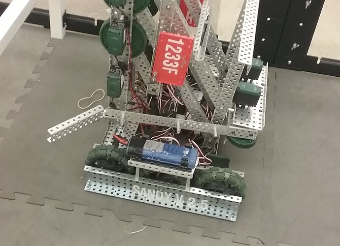

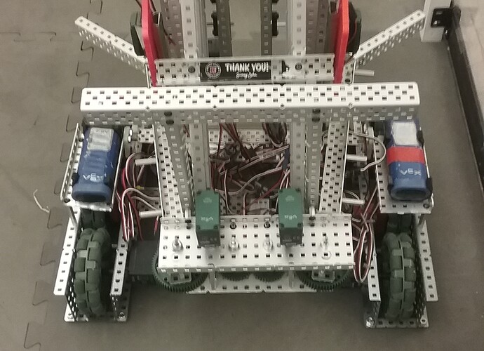

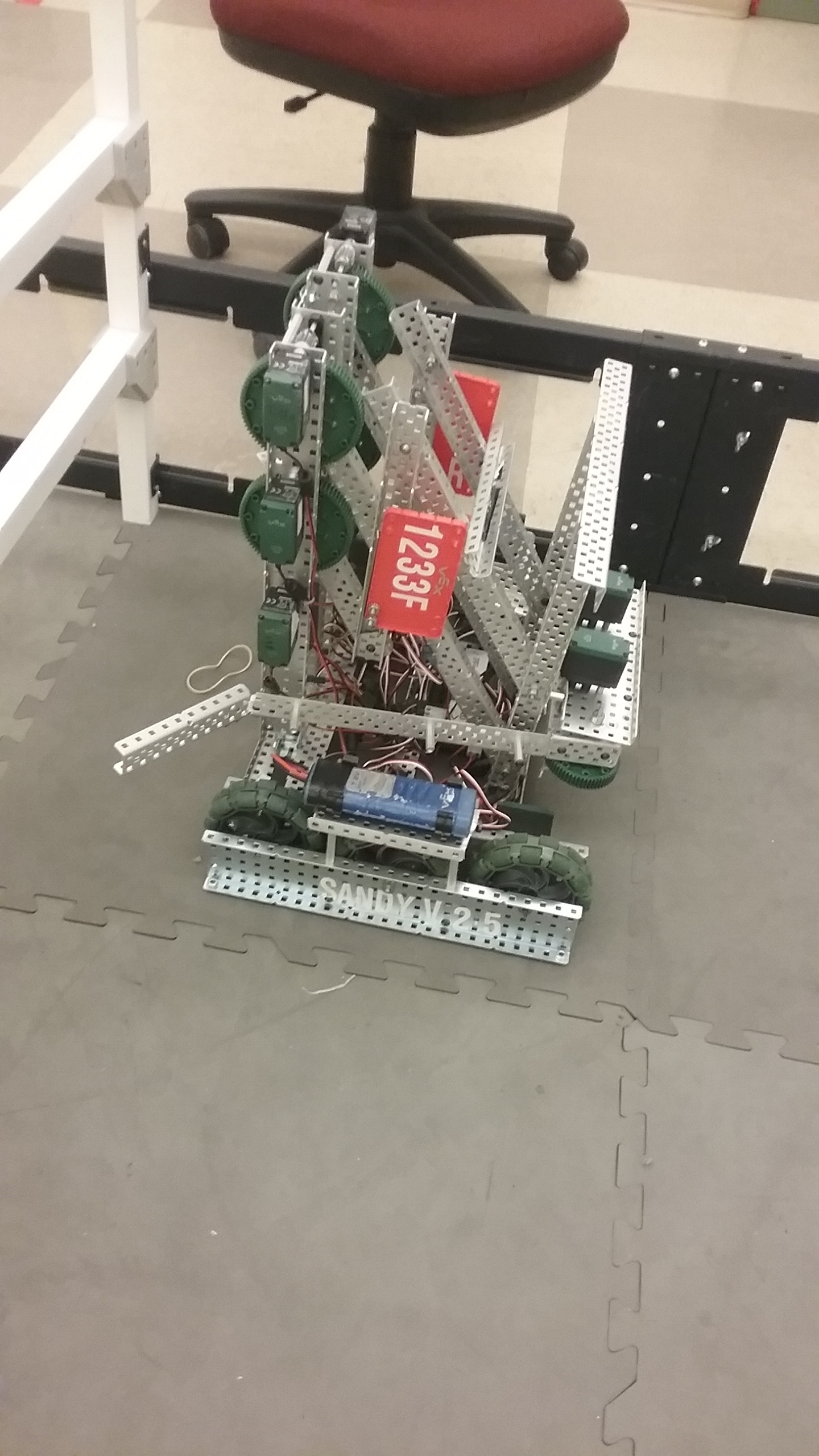

This is our nearly finalized bot. We have a two motor claw, six motor lift, and a four motor high speed drive

Word of Advice, you can lower your lift gear ratio to 1:5 if you have a six motor. I have a planetary 1:5 6 motor lift and it can easily lift 3 stars and a cube in one go. A planetary gearbox is basically having your motorized gear right around the gear attached to the arm, instead of a elongated gear train (if you didn’t know).
But also, have you had any issues with parts of your robot stalling? My robot has a 2 to 1 drive and after like 40 seconds of driving it stalls, and only if I have been turning a lot. Thanks, hope it helped.
