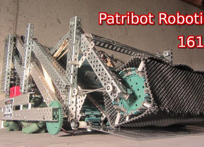

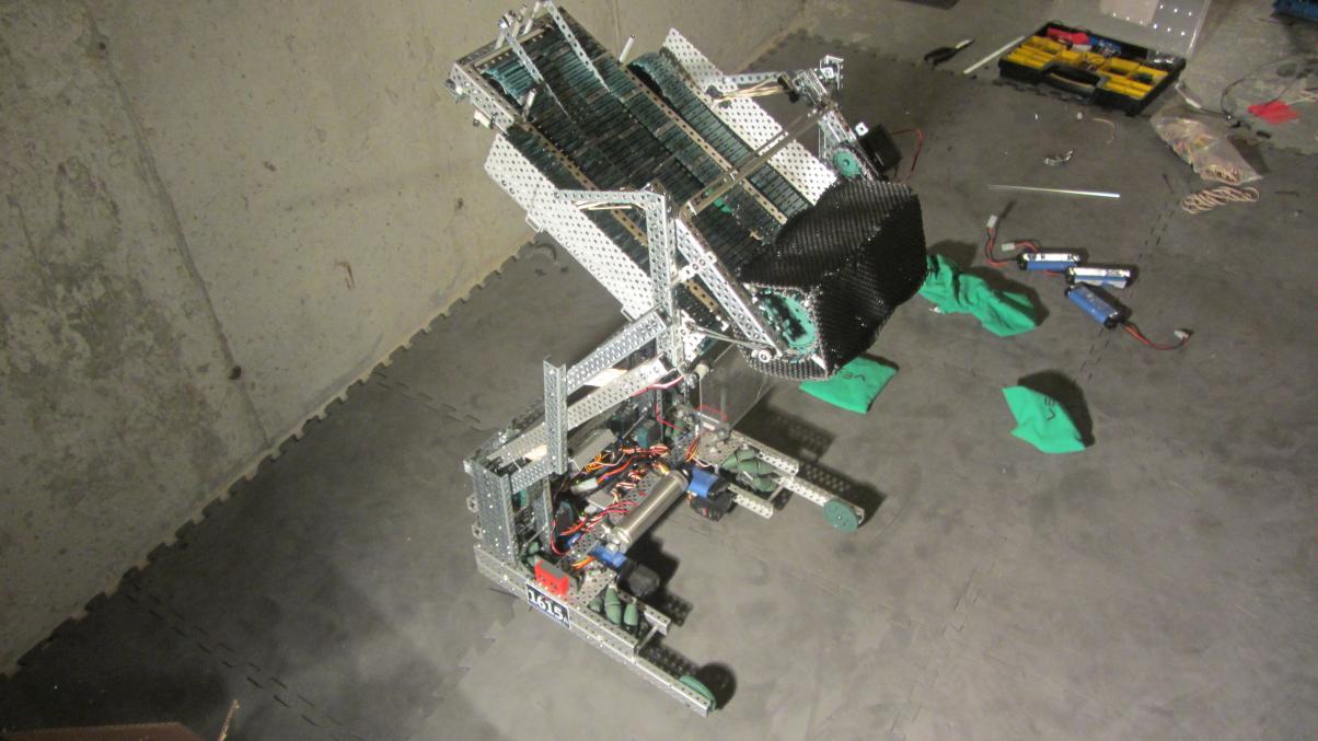

Hello everyone! We’re Team 1615 Patribots from Massachusetts, here’s our current robot.
Stats :
Mecanum Drive at 1:1
6-bar lift at 1:15, lifts around 16-17 sacks
Table can usually intake around 20 sacks at a time
Intake (gearing changes depending on the match, anywhere from 1:1 to 1:3)
Can intake individual sacks at full speed, and intake pyramid stacks of 5 nearly full speed.
Can score/descore high goal via pneumatics
(Unofficial)Programming Skills : 105**
(Unofficial)Driver Skills : ~175
**Today I made a quick 105 point programming skills routine, but it only takes ~20-25 seconds to run, so I think I can improve that up to a 150 by this weekend pretty easily.

Sweet! I can’t see your high goal scorer… where is it? o.O
It’s hidden under the table, it’s tucked in there pretty well. It’s simply a piece of metal that actuates back and forth. There are standoffs that work the same way my intake works that stick off of it that can drag the sacks off the high goal if needed.
What is the motor layout. Assuming 4 4 2 all 393s in high torque?
4 393’s torque on Drive
2 393’s torque + 2 269’s on Lift
2 393’s on table/intake
I only have 8 393’s in total, but should be getting 2 more once we find some extra cash :stuck_out_tongue:

Nice looking robot. How well can you strafe with your mecanum drive? We actually had to remove our mecanums because we found that when we held too many sacks, the strafing didn’t work well.
Thanks, so am I!
I normally never strafe while on the ground, only when I’m scoring over a trough, so it’s not a big problem since I’ve already emptied most of the sacks.

How fast does it intake/outtake?
How many do you put up in the High Goal?

Note: this is comparing to 4886A from several weeks ago, so they might have changed since then.
Intakes very fast, considerably faster then 4886A.
Outakes about the same, probably a little faster.
Descores quite a bit slower, but we’re still improving over time.
We can consistently get 4/5 match loads in the high goal, 5/5 once in a while.

What is the time for your lift to get to max height??
