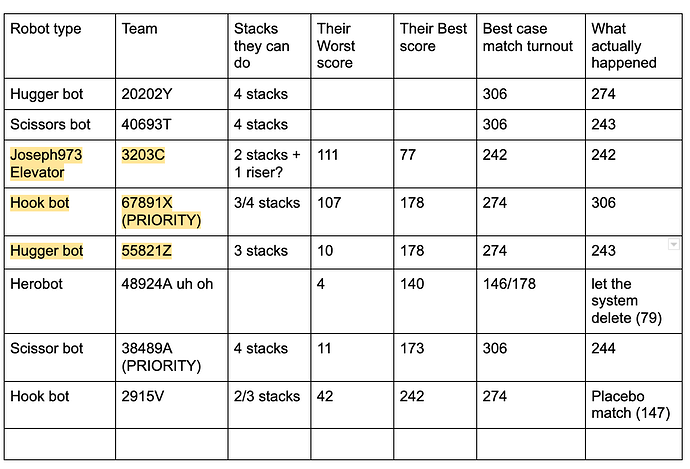

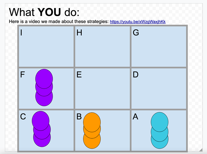

Communication:
I think in LRT, effective communication was key to optimizing the score. At our first two LRTs, we had bad communication and often didnt explain the plan well enough to the other team so there would always be a couple “wasted” matchs when the rows dont line up so we get like 12 points because rows are crucial in Rise above. So at worlds we prepared and made google drawings of the plan then sent the link to the other team because pictorial explanations were easier to comprehend and not misinterpret.
our plan sheet
Screen Shot 2021-06-16 at 10.58.19 AM
In addition to that, we kept close tabs on the teams we were paired with so we can tune the strategy to work the best for their robot.
