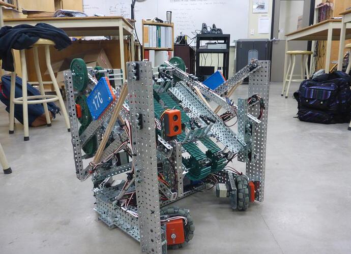

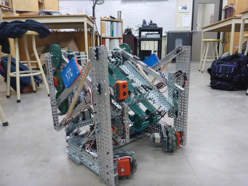

BROS here are a few images of my robot :smiley:
Any plans for skyrise intake?
Pretty nice robot btw.
I like how clean looking it is.
Is that the stig I see?

Yes I am VERY AWARE that i am very SIMILAR To 2919M’s robot and yes I did draw some Ideas from there robot. However, i tried 3 or 4 different DR4B designs/intakes/drives before going to the conveyor. I also wanted to have an X- drive but i didn’t get the parts until mid november. I always wanted to do a DR4B from the start with side rollers but that failed. I didn’t actually get to the conveyor until december, which has worked with flying colours. As someone that wants to win and has to face and wants to beat the best in my region, this is the best design i got. happy?

Very nice robot, the intake only looks like it can hold 2 cubes at a time, or am I wrong at that assumption?

yah it can only hold 2, 3 is physically impossible for it

Anyway, back to the actual topic of this reveal, this looks like a really solid robot from what I can see. Do you have any plans to try to increase to a 3 cube capacity? Also, what lift ratio are you using and what’s your reasoning behind it?
Best of luck with any future modifications and additions (like a skyrise intake?), with good driving and programming I’m sure you’ll have a top notch robot! :slight_smile:
originally we had a standard 1:7 4 motor gear ratio for our lift, but was not enough and to fast to actually control at all, so we scaled up to 1:11.7 ratio, which is a 3:5 then a 1:7 ratio. I want to do 3 cubes, i have imaginations of being able to do it but i think i will focus on a skyrise intake instead.
