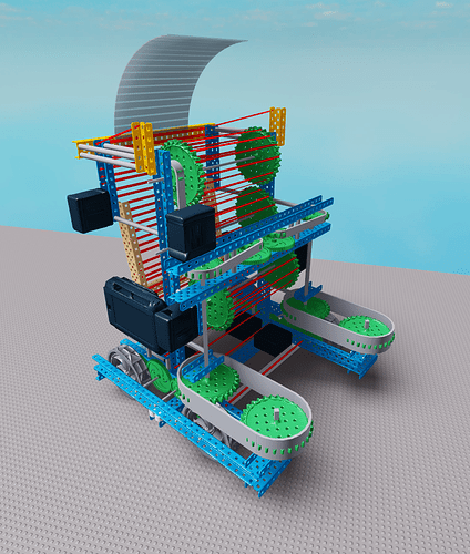

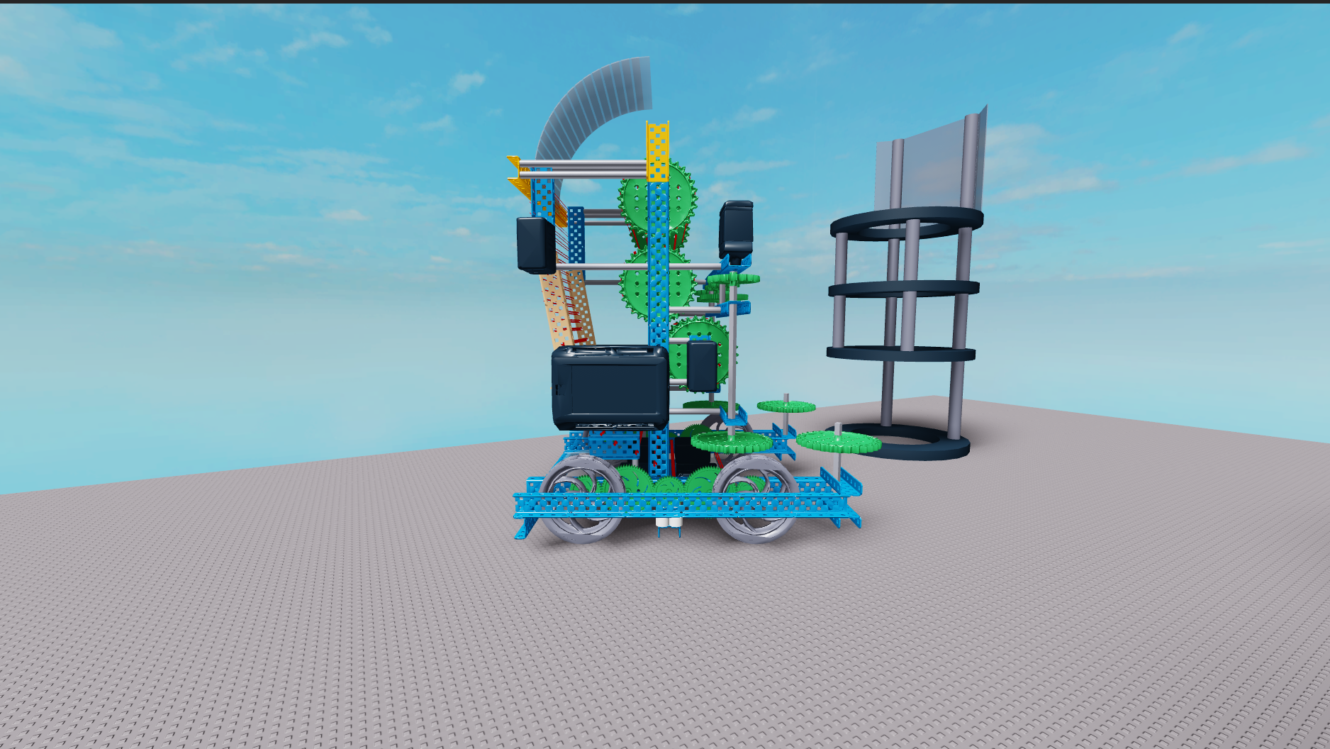

So I have been seeing a bit on how creative I can be for my build. So, here is a nothing but net-esque type of robot that I think would be really cool to see if someone can build it successfully. The specs are as follows:
4 Motor 200 RPM 5:3 drivetrain
1 Motor 200 RPM 1:1 intake rollers
2 Motor 600 RPM 1:1 indexer/flywheel(ish)
1 Motor 100 RPM 1:1 back door
What is the purpose of this design?
The purpose of this design is to be able to pick up any colored ball, and the robot will autonomously eject all opponent balls. When the robot is filled with 3-4 same alliance balls, you will go up to a goal and put the robot against the goal post. There will be an ultrasonic sensor in front of the robot so when you are lined up, the robot will immediately start replacing the entire goal within 1 second by chucking the 3 balls into the goal while simultaneously intaking the opponents balls from the bottom of the goal and ejecting them out of the robot. Because the distance isn’t that far, we can have a hood that is unsupported so it can easily flip up above the 18" limit when the match begins.
Hopefully this inspires you to consider this design, or try more creative designs outside of the scope of the previous season :slight_smile:
Screenshot (958) Screenshot (959)

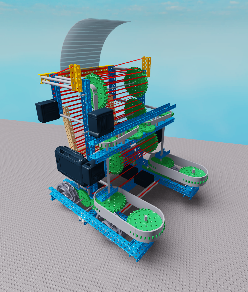

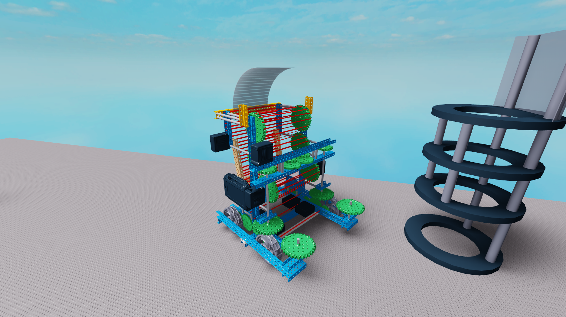

edit//: Updated the design a bit:
Screenshot (960)
CAD Software: Roblox :wink:
Time spent Cadding: Roughly 2-3 hours

just curious… or maybe it is due to parallax error…
The goal is 18.4", is that “yellow” piece sticking vertically up exactly at 18" or it is supposed to expand out?
I have posted an updated version so it hopefully would make more sense. It’s used to pull the hood above the 18" limit when the match begins. Note: I am too lazy to figure out how it can be in dimensions/fold in dimensions and then fold out, but it should be really easy to figure it out.
Also, you can somehow figure out a way to have the robot hoard 3 opponent balls behind the ejection but I’m too lazy to figure that out as well…
