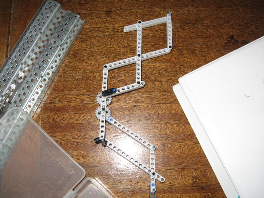

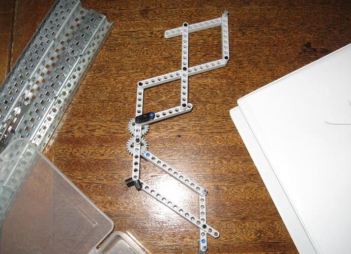

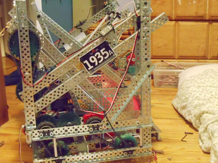

I have always had a fascination with unconventional levitation devices and since we now have a game where some of them might actually be useful, I thought I’d share some of my ‘adventures’ (as starting from scratch always is).
first up, reverse bars.
Legos are great for getting a concept into it’s simplest form:

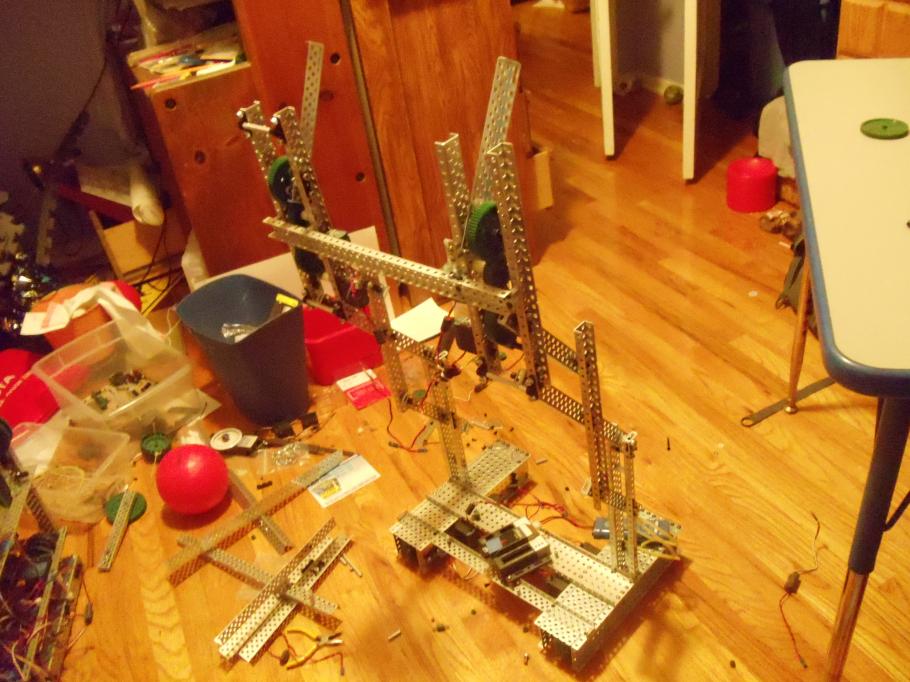

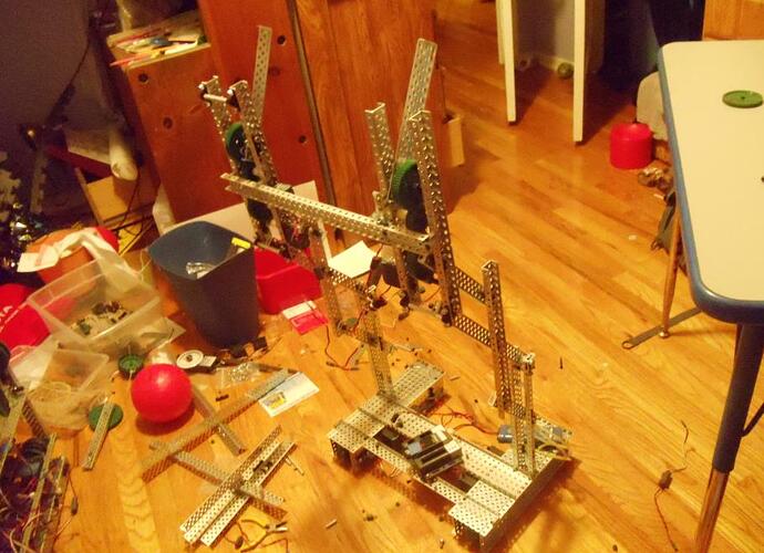

The first attempt at a reverse bar took most of the summer and in hind sight probably would have worked if I done these things:
  1. used aluminum instead of steel
  2. compromised and moved two of the six motors on the drive to the lift.
  3. added about 7 times as much latex tubing.
This lift reached 50" so it could be used for this game without that much modification. (that is if I left it on the shelf for 3 years)
The lift down:
https://vexforum.com/attachment.php?attachmentid=8368&stc=1&d=1398998581

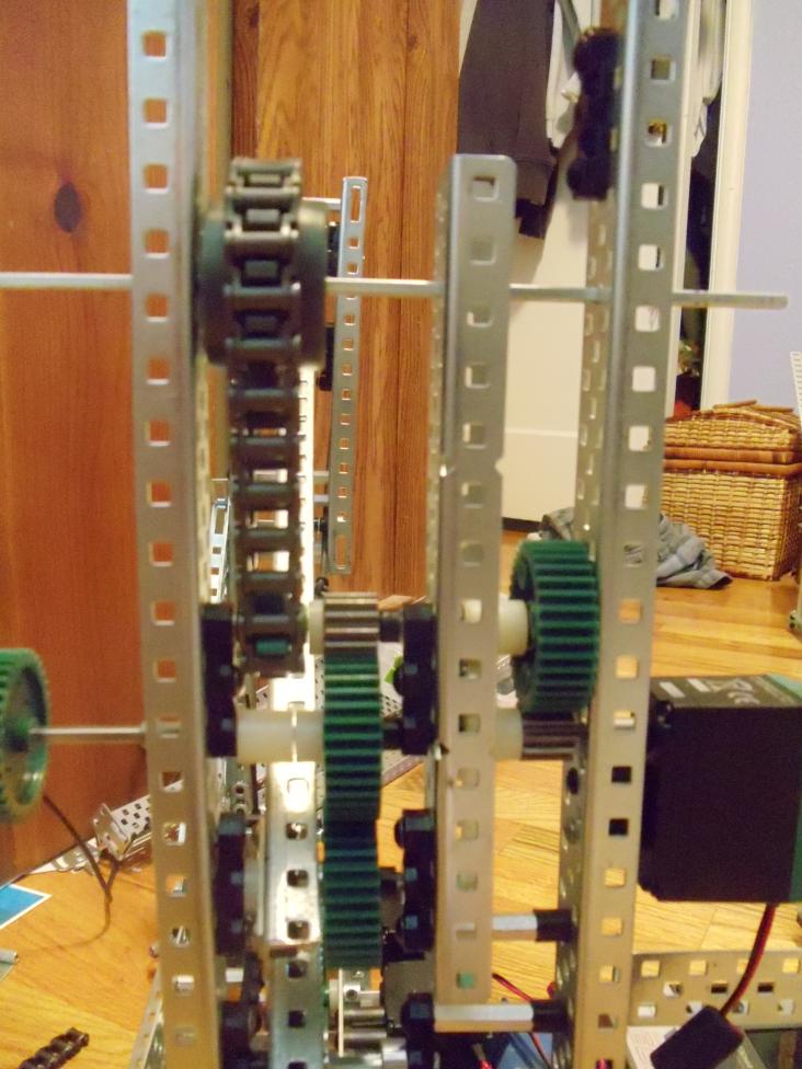

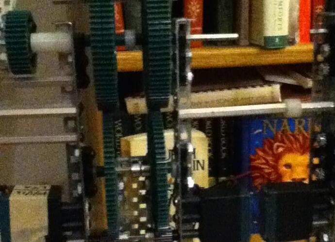

One of the most complicated gearing I ever built:
https://vexforum.com/attachment.php?attachmentid=8369&stc=1&d=1398998832

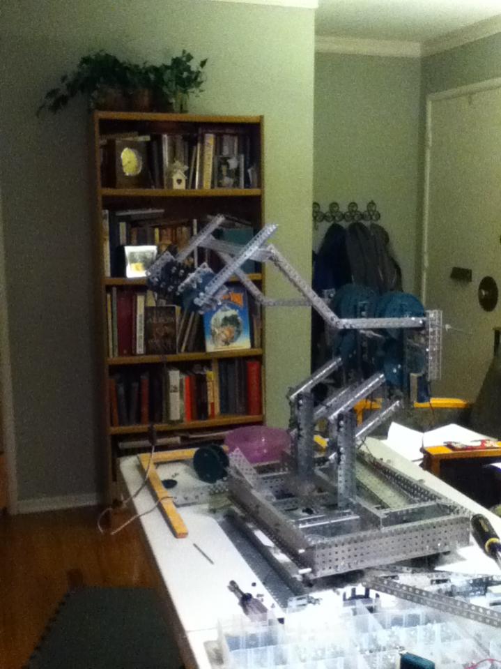

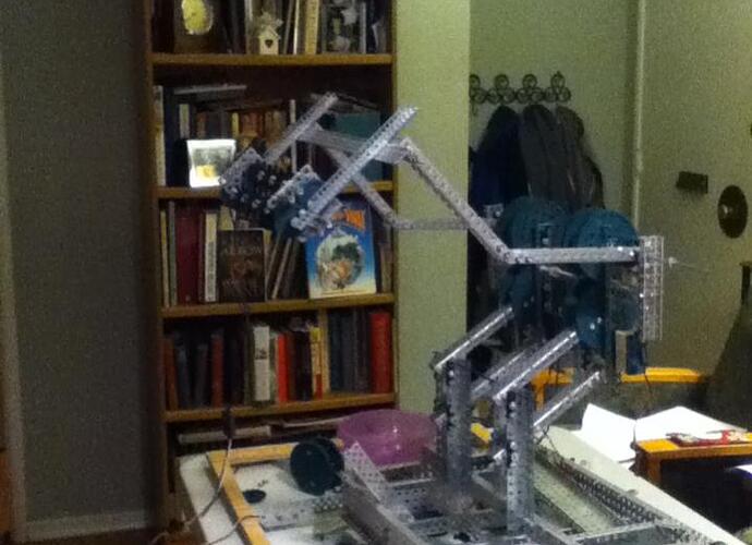

The second attempt at a reverse bar was going well until it got cut off by time constraints and strategy changes.
that’s right folks it’s a reverse double six-bar! [EDIT: the intake tray is actually not attached to the lift FYI]
https://vexforum.com/attachment.php?attachmentid=8370&stc=1&d=1398999449

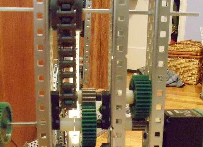

The first stage and the gearing completed:
https://vexforum.com/attachment.php?attachmentid=8371&stc=1&d=1398999580
You can see some of the backup bot in the lower left corner of the picture. (always a good idea to have a backup of you can with these things)
I don’t remember how high this one went but it was probably less than the first one (the choice to make it a six bar was mainly to get it into a more compact space when it was down)

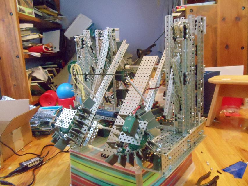

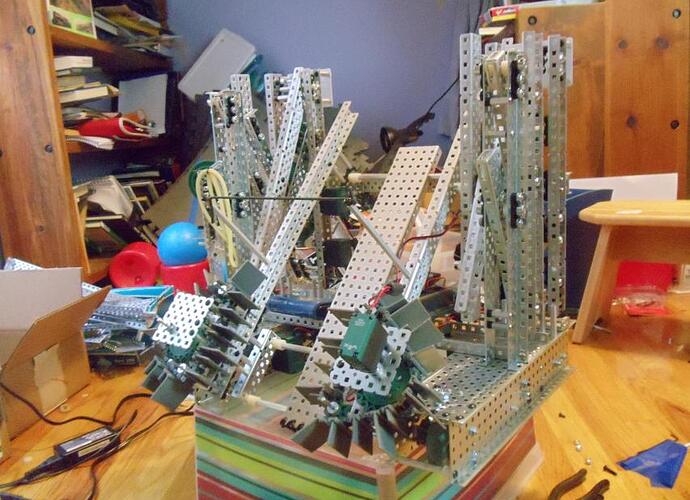

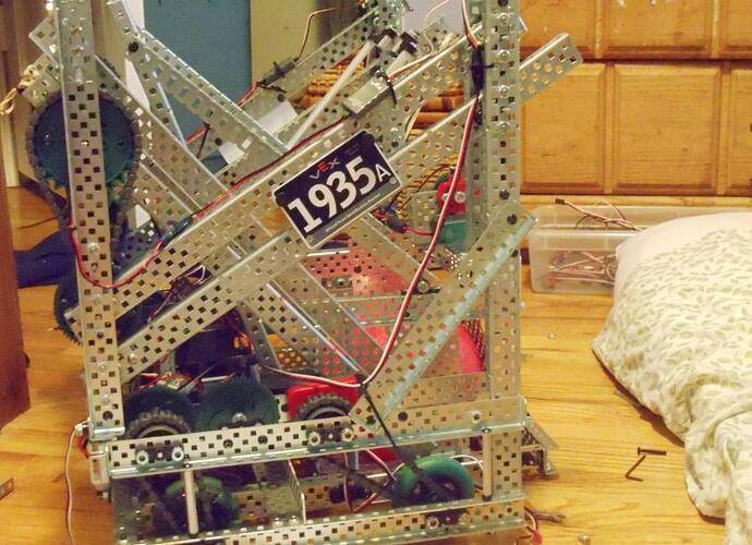

And now the one that worked.
this one was made to be fast to complement the one or two at a time sack picker-upper we had on hand.
The lift half way up minuets after completion:
https://vexforum.com/attachment.php?attachmentid=8372&stc=1&d=1399000345
Scoring a sac on the high goal:
https://vexforum.com/attachment.php?attachmentid=8373&stc=1&d=1399000511
A close-up of the gearing:
https://vexforum.com/attachment.php?attachmentid=8374&stc=1&d=1399000583
This lift didn’t break down much and did everything we wanted it to but when it did break it was a pain in the neck to fix.

Was fifty inches the bottom of the top bar or the top. Also do you think that this lift could be powered by two turntables ( the original 84 tooth high strength gear) with one motor per table.
I should also mention that one of my tossup robots reached 40" and fit under the barrier so it could probably work for this years game too.
It could elevate something about 50" or so higher than that something started. (keep in mind that this figure is from memory but I am pretty sure it was very close to 50")
HS shafts would probably be a better option in my mind.
