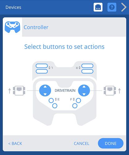

If you’re using VEXcode IQ blocks, you can set that up without writing any code. Configure a drivetrain and a controller, then in the controller setup, click/tap a joystick repeatedly until it looks like this:
