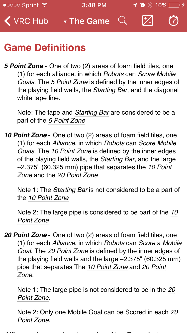

If there are 2 mogos (with or without cones) touching the 20 pt zone. According to the official rules, mogos score in the higher zone “If a Mobile Goal is touching multiple Goal Zones it is Scored in the higher point value Goal Zone” But, also, according to the official rules only one goal counts “Note 1: Only one Mobile Goal can be Scored in each 20 Point Zone.”, so you have 20 points, not 30.
I’m just am going to drop this here from the officia ItZ Q&A Summary:

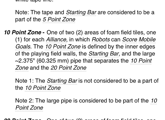

unless it is touching the large bar
Correct me if i’m wrong, but if there is a situation where there is 2 goals in the 20 point zone then there is 2 situations that it may fall under. Lets have 2 goals, (A) has more cones than (B). If A is touching the 20 point zone and the large bar, but B is only touching the 20 point zone, then A is the only one counted. If A is touching the 20 point zone ,and B is touching the 20 point zone and the large bar, then A is counted for 20 points, and B is counted for 10.
If two mobile goals are scored in the 20pt zone and one is touching the large bar (which is considered apart of the 10pt zone), it is scored in the 10pt zone. However, if both mobile goals in the 20pt zone are NOT touching the bar, the one with fewer cones counts for ZERO and the other is scored normally.

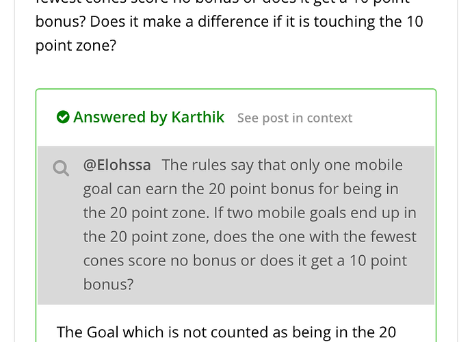

Attached are the reveleant forum rulings and game definitions.
Thanks for the clarification. I think Karthik’s ruling makes the answer 100% clear. My bad for not finding that earlier.
