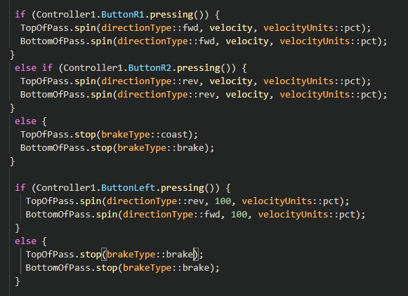

2 motors in 3 differents(revense, foward, or both)
How I put 3 differents in 2 motors on vexcode pro. Two motors use only reverse, only forward, or one is forward and other one is reverse.
2 motors have 2 differents. It was works. :
if (Controller1.ButtonR1.pressing()) {
TopOfPass.spin(directionType::fwd, velocity, velocityUnits::pct);
BottomOfPass.spin(directionType::fwd, velocity, velocityUnits::pct);
else if (Controller1.ButtonR2.pressing()) {
TopOfPass.spin(directionType::rev, velocity, velocityUnits::pct);
BottomOfPass.spin(directionType::rev, velocity, velocityUnits::pct);
else {
TopOfPass.stop(brakeType::coast);
BottomOfPass.stop(brakeType::brake);
2 motors have 3 differents. It was not work.
Annotation 2020-11-10 120751
I want 2 motors have 3 differents but how i put it then it work?
You should use one big chain of if ... else if statements, with only one else case at the end.
With your current code, consider what happens if you press only button R1. Then the first if .. else if ... else statement tells both motors to spin forward, and the second if ... elsestatement tells both motors to stop. Telling motors to both spin and stop at the same time will cause undesired behavior.
If you instead structure your code like this:
if (Controller1.ButtonR1.pressing()){
    // spin both motors forward
else if (Controller1.ButtonR2.pressing()){
    // spin both motors backward
else if (Controller1.ButtonLeft.pressing()){
    // spin one motor forward and the other backward
else{
    // stop both motors
then you’ll only be telling the motors to do one thing at once.
I understand clearly. Thank you for help.
