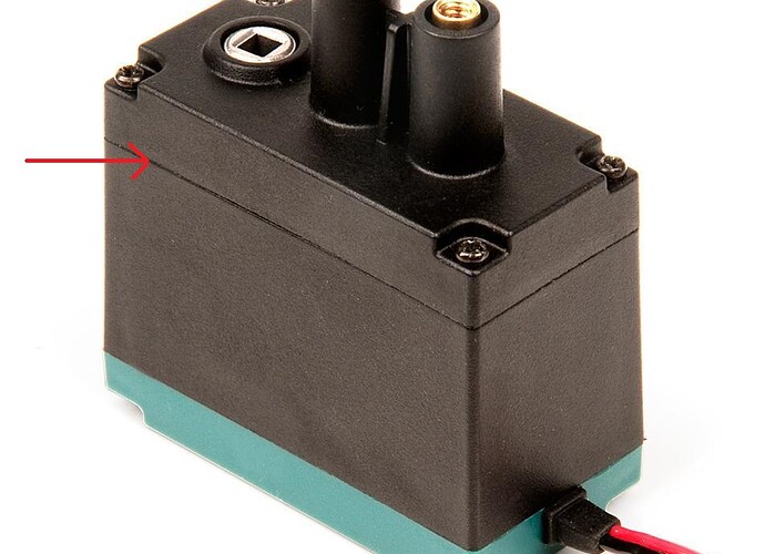

The axle penetrates the motor housing approximately to the seam between the sides of the motor and the screw plate. You can mock up your assembly, and measure between those two seams.

Seems like I end up doing this a lot and found that the axle basically inserts into the motor to the seam. If you put you axle across both motors and draw a line just inside the seams it works pretty well once you round off the ends of the cut side.
