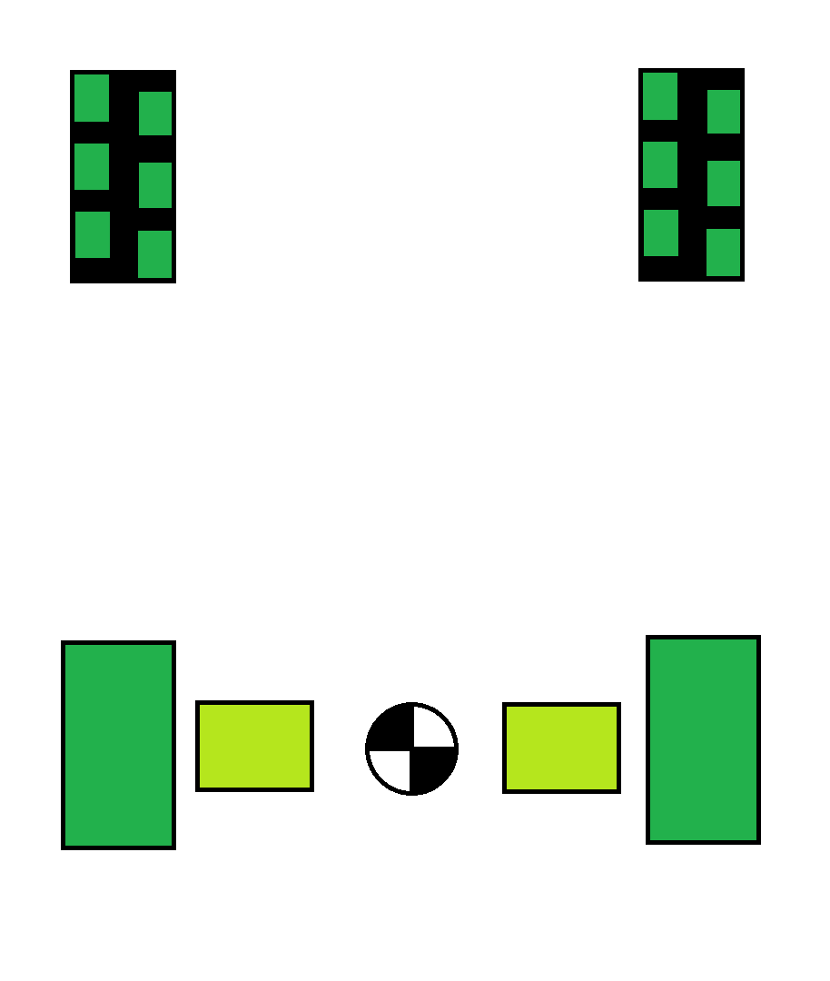

Torque should not be significantly effected, although your traction to transmit that torque will be reduced with the surface area of contact from your drive wheels.

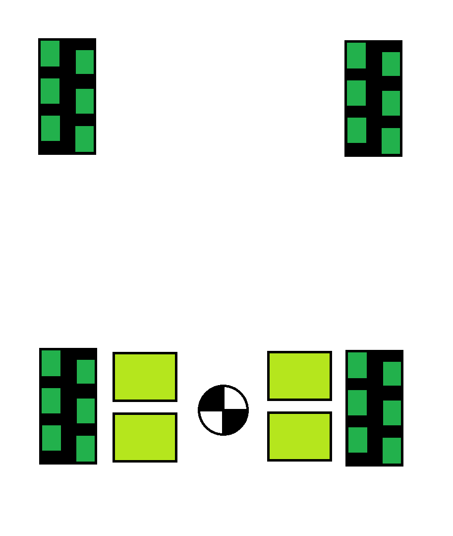

Center of rotation will be effected. Assuming your idle wheels are omni’s, then your center of rotation should be approximately between the two powered wheels. If your idle wheels are traction wheels, you are going to have a bad time.
Turning speed is mostly just effected by the distance between the drive wheels. Unless you make a narrower base, your turn speed should remain about the same.
Stability will only be effected by your contact foot print, which is not effected by idle wheels, however, if you somehow have the acceleration to pop a wheelie, it would be an issue.

Visual aide for change in center of rotation. Forgive me for using the center of mass symbol, it is just a nice clear marker of “here”.
Visual aide for idle wheel style. Not specified, but the driven wheels can be traction or omni, depending on your needs.
Edit to pictures, forgot to change/remove center of rotation.
We use four omnis on ours and we power only the front two and we still have a central rotation point. I was concerned about this when we were building it but we found it didn’t change.
Edit: This only happens if your weight distribution is very uneven
that is what his first figure shows
nope.
his figures do rely on the assumption of even weight distribution
This is correct. And negligible friction in the free wheels.
That is an interesting result. If there is odd weight distribution or friction prohibiting free spin of the wheels, this is possible, but i am surprised that there is no change at all. It should at least tend toward the new theoretical center, even if it does not fully reach it.
Ok this makes sense our weight distribution is not balanced between the wheels. Like 80% of the weight is on one side. Thats why we probably have some unusual turning point. Also it might not be precisely in the centre but its near enough we couldn’t notice.
