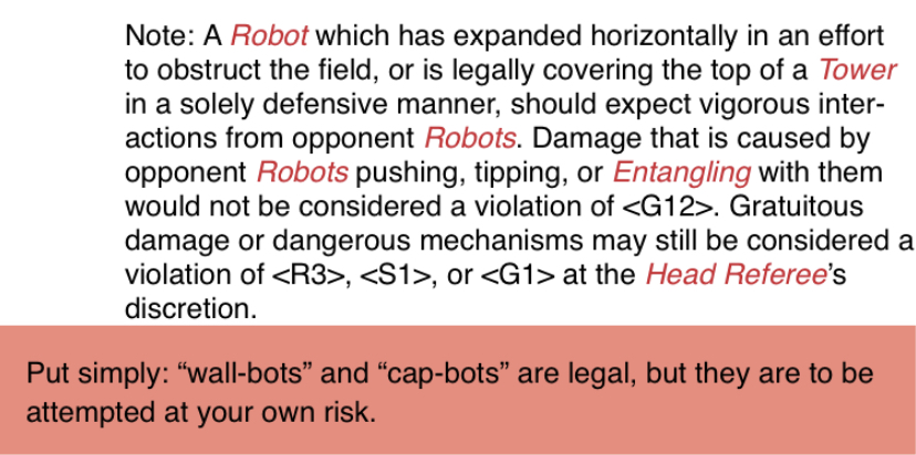

No offence but how is this season still playable with this? I think although this is legal the ref will still DQ u. Well design thou.

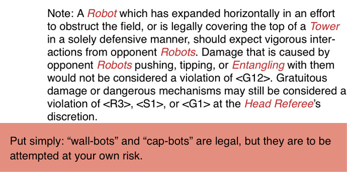

Homie, it literally says in the rule book wall-bots are legal, I have a screenshot to prove it !
Maybe read the rules a couple more times?

Well, no - speaking as a certified head ref, that would be a serious breach of the rules and probably a major controversy as well. Wall-bots are explicitly allowed per <G12>.
The reason they likely won’t be very popular is because it’s a high-risk strategy that requires high-quality design and execution, and because it depends on having the right partner - not much point in restricting your opponent from scoring if your alliance can’t score itself.

I dont think eden was saying this robot was illegal, I think he meant that refs will be another one of your opponents.
What would the ref DQ you for though?
just existing?
All I am saying is that it takes a lot more to convince a ref that your wallbot is legal than it is to convince them that your more conventional bot is legal. And this plays out in matches where the refs constantly have to watch the wallbot since it uses a primarily defensive strategy focusing on fighting head to head with the opposition robots.
Only problem I say is possible entanglement, if it gets DQ’d anything else about the bot being illegal I believe that is bad reffing.

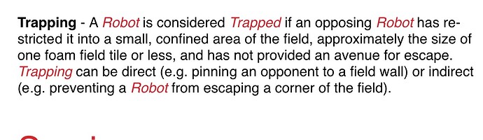

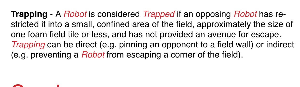

On the discord we came up with anothe viable method of thwarting the wall bot. After autonomous have one of the bots sit in the protected zone, theoretically the wallbot cant deploy anymore with trapping you and since they have the option of just not deploying G14 doesn’t go into play because you aren’t forcing them to break a rule. It would most likely just be a bot a bot stare down well the other bots on both teams just try to outstack the other. And if the wallbot doesnt realize this it should be a dq right?
After I looked at the rules again though i’m not so sure.
It says trapping has to be 1 tile of space but it uses the corner of the field as an example, what do you guys think?

Firstly, deploying the wall exactly at the tape line of the outer protected zone with an opponent inside the zone leaves enough room that it should legally NOT be Trapping, based on our understanding of the definition.
Secondly, if the opponent tries to get exactly in the path of the wall deploy instead of sitting nicely on the side, then the controlled deploy gets its turn in the spotlight. The x drive enables us to have the large wall “grow” to fill the available space, and to thus apply constant pressure on the blocking opponent. This capability is critical for the overall counter.
Finally, the only way this counter would work is if the blocking opponent can create an opening for the second opponent to pass by the wall. However, we have both the tank drive basebot to play defense on that second opponent, and also the torque to physically push the blocking opponent out of their position.
