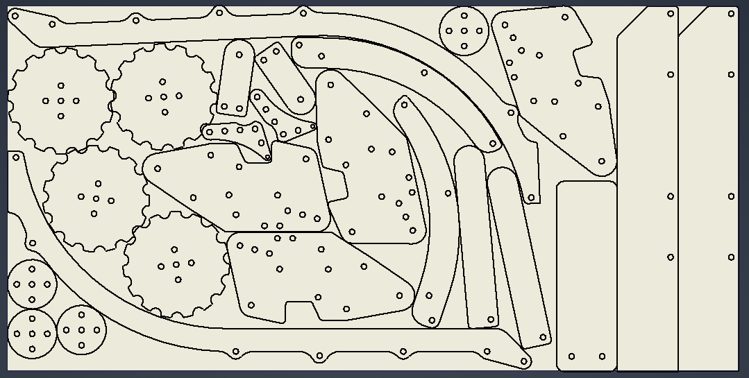

Can you give a quick explaination of what polycarbonate is decorative and which is functional? Because it looks like your over the 12x24 limit and im intrested to know how you managed that
I’m pretty sure all of the decorative polycarb needs to be backed by a solid surface. So every piece of polycarb that isn’t a lone standing piece of structure is decorative

In a nutshell, the large trapezoidal side plates and the two back plates on the base are decorational, alongside two front diagonal poly pieces on the base (we made sure to only screw them on for one side of the c-channel so it doesn’t provide any structural support). Below is a 12"x24" lexan sizing sheet for the functional polycarbonate on the robot:
This is also correct. We did something similar for the back polycarbonate plates as they are supported by the main back c-channel rail and the motors themselves. We also made sure to design the plates so they can be taken off at a moments notice in the case that a referee believes that it serves a functional purpose.
We will most likely go into more detail on the polycarbonate usage that we have on our robot near the end of the season in an explanation video.
Edit: 1721G also does the same with their side decorational plates and their long back decorational plate being backed by c-channels so the plates themselves provide no functional or structural purpose.
