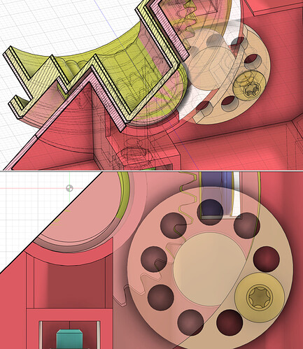

You know, I suspect you might be right. The roller mount looks like it will spin freely upward with pressure from the field side (hence Spin Up?) but tend to jam if you try to pull back on it with weight still applied. One possibiliy here is that a sprung bar at an angle will achieve what you want. You’d still have to watch the orientation of the roller, or install a colour or vision sensor. Or maybe even a line follower group? This may be where a colour filter is useful to create light and dark. Much speculation, very geometry, learn CAD. I’ve added a copy of the roller pushed down to close the 0.75mm gap in the mount. It suspect it should be possible to estimate the geometry and weighting of the bar that would work from the model and probably not be wildly inaccurate.
