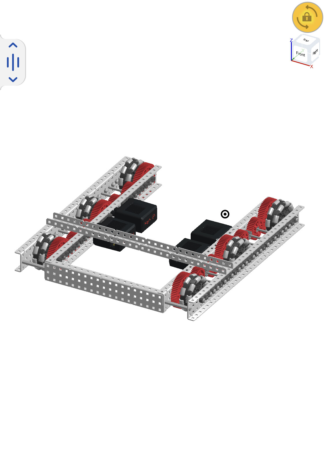

Wondering if this drivetrain would be viable for over under its 600rpm motors gearing is 36 tooth to 60 tooth 2.75” wheels. Wondering is a traction wheel in the centre better.
Depends what problems you are trying to solve your design criteria& constraints are… Presenting an implementation with no context is a big ask.
6 motors would be better if you are doing 4m drive i would gear it slower probably in the 46-60 incher per second range
Good for under, but not over.
Welcome to the forum.
You might look at Xenon27s post about drivetrains (Catalogue of Drive Gearings) to get some observations and, as lascap notes, compare those observations to your design intent.

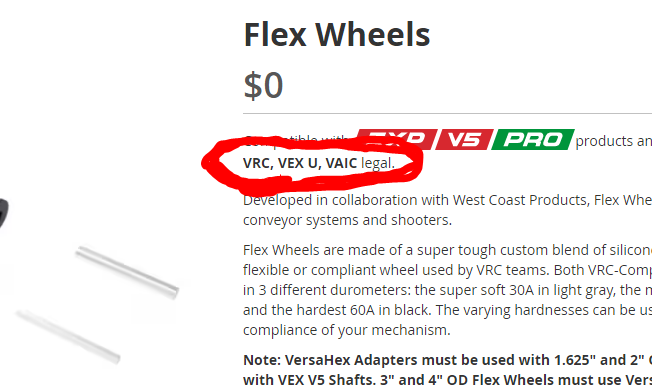

Quick question and clarification are the aluminium Versa hubs allowed for VRC. Cause here it says they are interchangeable . Vex Library Article.
For a part to be VRC legal, it has to be listed as V5 compatible on VEXRobotics.com. The VRC legal flexwheels and accessories can be found here:
https://www.vexrobotics.com/vrc-flex-wheels.html
Note that there are VRC legal aluminum versahubs on that page, but not all the aluminum versahubs that VEX sells are VRC legal.

According to rule R6(a) of the game manual (https://link.vex.com/docs/23-24/vrc-over-under/GameManual) a part is legal if the catalog page on vexrobotics.com says they are:
Go to the page for flex wheels and look for the part you want to use:
