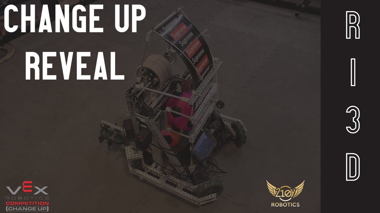

Kapow from 210Y has given me permission to post this, their team’s Ri3D reveal.
It’s a snail hood design, with TT style front intakes, and an NBN style flywheel.
Specs:
  • 4M 200 rpm X-Drive
  • 2M 600 rpm Tank Tread intakes
  • 2M 600 rpm indexer/flywheel
This robot is of a similar design to the 99999V CAD that was released earlier this week.
I wouldn’t be surprised if this bot becomes the meta this season.
RIP Change Up it had a good run

Jokes aside, seems like this’ll be to this year what goofy was to last year: The robot for teams looking for designs. I take it this bot won’t be able to score in the middle goal, though?

very impressive. obviously this had to have been developed independently of my Ci2D hoodbot design, because it was released less than 3 days ago, which just goes to show that this design is a excellent solution to the challenge. well done.
I don’t think an actual flywheel is optimal for this design though, you want to be gently tossing the balls in, not yeeting them against the backboard. x drive is interesting.

I like the pop up hood in this design, a flipout is simpler imo than ratcheting it off the flywheel, but it works.
A lot of teams will be switching to X-drive, imo. Better mobility in all directions, and less of a need to push aggressively. Pinning/trapping won’t be as op as TP or even TT.

it’s not on a ratchet, there’s string tensioning it and a rubber band on the hood if you slow the video down
huh, sounded like a ratchet, so I just assumed. thanks for pointing that out, that’s a much simpler system
actually you probably could. part of the definition for possesing is that the ball cannot be scored, so if you spit out the ball as soon as you pull it beyond the bound of the goal, you could get away with it. also, just don’t fill your hood with 3 opponent balls unless you don’t plan on doing any descoring.
