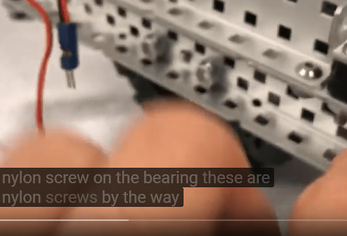

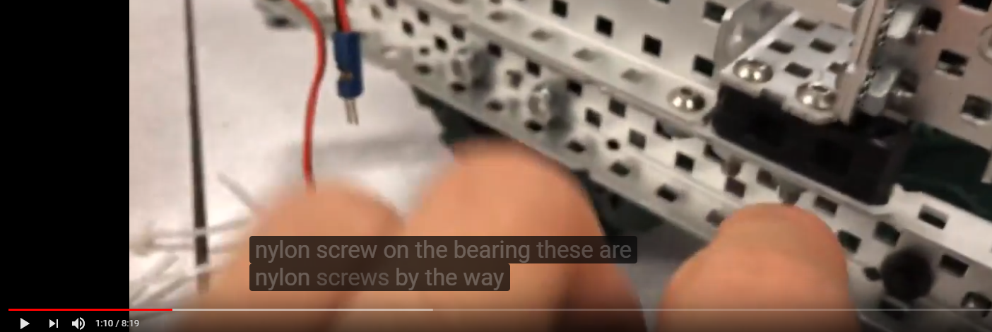

Your wiring is beautiful
#3
Please do not use pop rivets I see at competitions they fall out. But great wire management.
#4
if you actually opened up the video you’d hear him say “these are nylon screws by the way”
#5
At any rate pop rivers are usually fine. For instance, some (if not all) Discobots used them on their drive in NBN to very great success.
#6
Oh I have bad experiences with pop rivets. I have never seen nylon screws that color , looks like pop rivets.
#7
thank you. It took so long.
yeah lol we ordered black nylon because it was cheaper. Pop rivets (if used properly, and taken care of), work fine? I find they’re like kepsnuts, a lot of people say that they’re bad, but they end up being just fine (if you do it right). regardless, nylon screws and nuts are pretty cool.

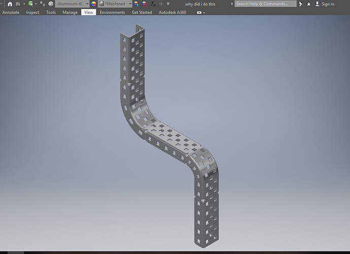

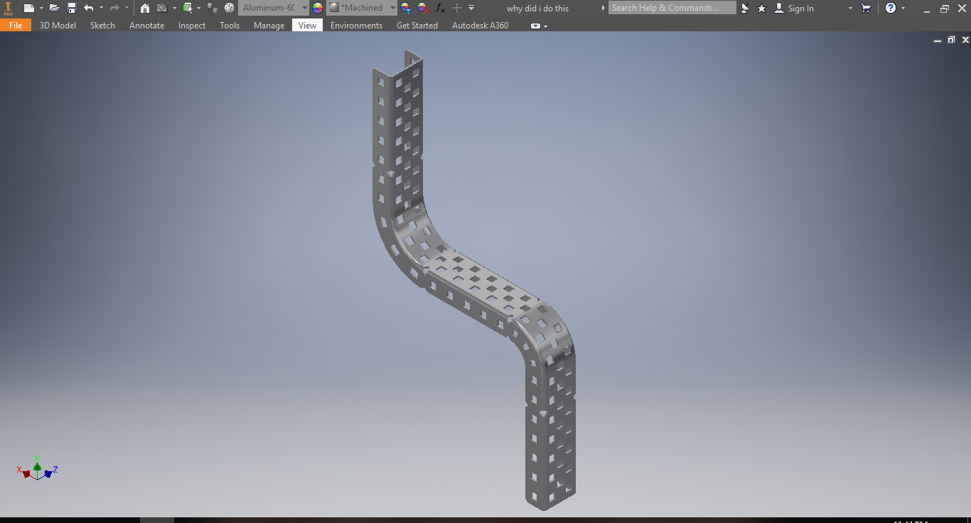

If you’re trying to animate, Autodesk Inventor is exactly what you DON’T want to be using… You can simulate range of motion and other things like that if you learn the constraints pretty well. You can also work pretty quickly once you learn the ropes. But Inventor is pretty bad at doing other things. In addition, it will ALWAYS find hilarious things to do to get on your nerves.
I have never used solidworks before, but from what I’ve seen/heard from other people, it does a better job at simulating.
Also, have this amazing bent c-channel that I made in Inventor when I was… bored?
