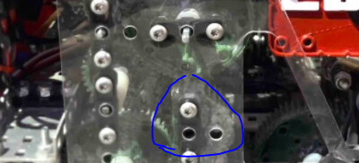

Does your lift steal two drive motors when it needs to run? Is there something locking it in place when those motors are on the drive?
Are your gears intentionally beveled for easier meshing and un-meshing or is that just wear and tear?
Yes, our code will switch the shifting motors from drive to lift when the lift needs to run. The lift locks to the 36t gear circled.
Our gears are intentionally beveled, shifting without beveled gears doesn’t really work too well.

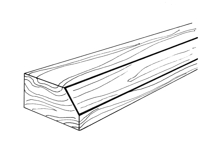

I am having a hard time seeing it, how are they beveled? Or what do you mean beveled?
We attached the gear to a drill, and ground it at an angle against a file. When I said a beveled gear, I was referring to the fact that the edge of the gear is no longer a single 90 degree angle, it has been ground down at a 45 degree angle.
I think you might have confused it with a bevel gear?
Interesting,
Not to get off topic, but ~gets off topic~ I know VEX IQ just launched Hybrid gears, which is sort of what you made. I wonder how well those shift in and out.
I’ll have to play with these later.
I didn’t get it confused with those bevel gears but your saying you shaved the flat part of the teeth off so they aren’t flat, right? Almost like this
Yeah, exactly like that
