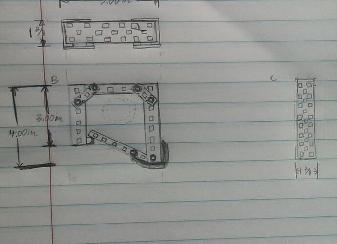

Our hanging design as of now.
Features a locking mechanism powered by rubber bands in a clip design.
https://vexforum.com/attachment.php?attachmentid=7545&stc=1&d=1373297861
Love the drawings!! Drawings this detailed are more impressive than cad software. But it’s always safe to use CAD to check your work
Thanks Draco. The funny part is that it was done all free hand by me!

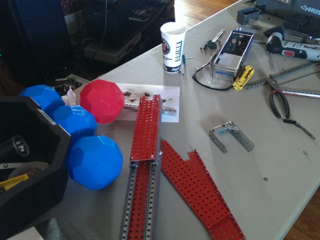

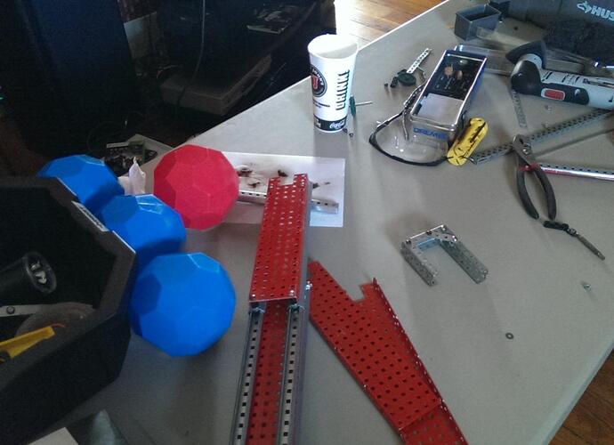

Hanging Hook is almost finished. Adding fourth tier of Linear Lift, and painting the parts. Please Support Us by Liking our Facebook page at 2880A Endeavour.https://vexforum.com/attachment.php?attachmentid=7546&stc=1&d=1373495095
as this thing is developing, i have reminiscences of 1103
We gained knowledge of Mr. Wade’s robot by observing and documenting the steps where he left off. We are planning to move with a 6:1 Ratio for Speed on the wheels, hang in 3 seconds (Including shooting up to the bar), and be 2x as fast as Curahee. I like to say we are picking up where he left off.
