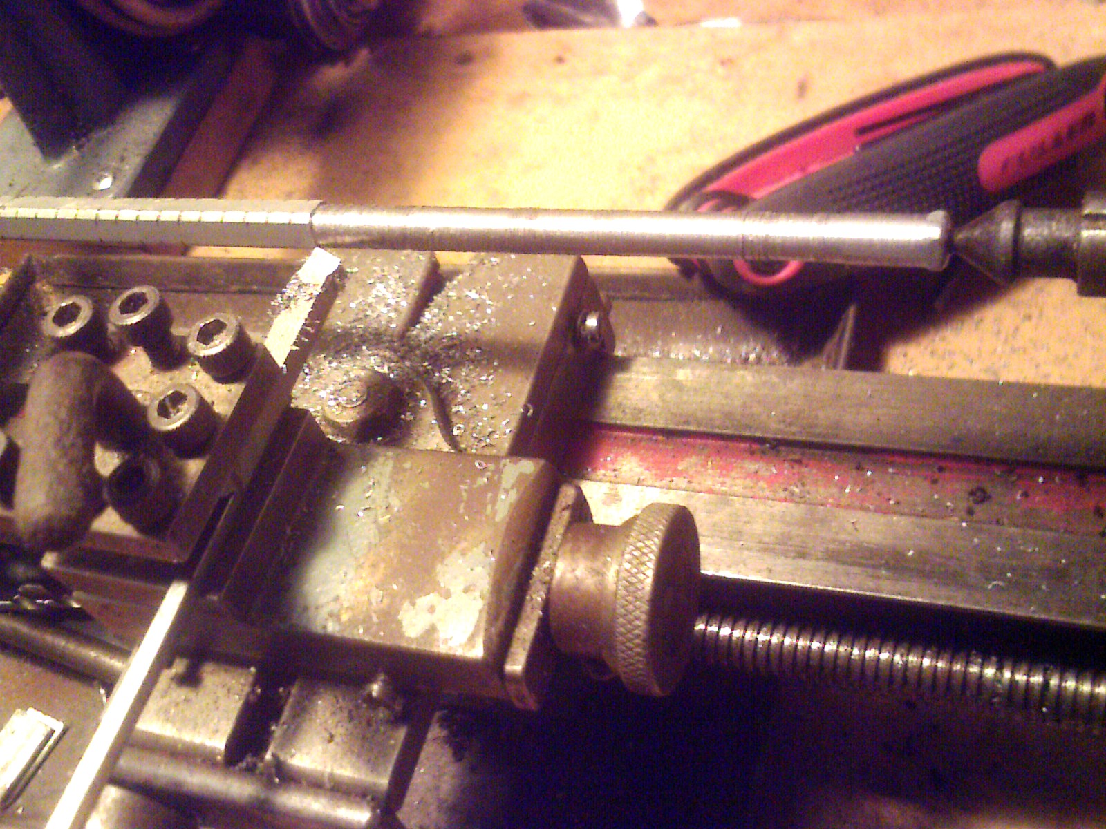

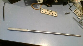

Can you show just the custom lead screw and a few extra words on how it was to be made, that sounds like serious machining. Did you make prototypes before you ran out of time? CAD design?

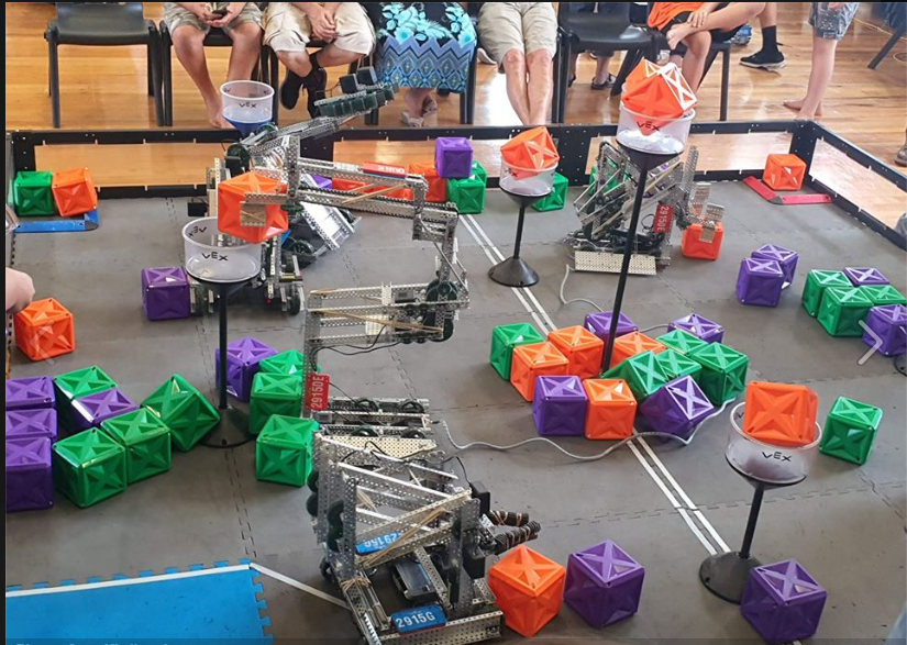

If anyone wants to see the robot in matches, here are our match numbers at nationals:
3, 29, 43, 53, 75, 100, 126, 138, R16#8-1, QF4,1
NZ nationals(you may need a vpn if the video is blocked in your country due to the music):
We can post some more pictures of it later when we have time.

Remember that we also had an exhibition match 6 with innovation the american team that came to nationals rather then where ever they where going in china due to COVID-19.

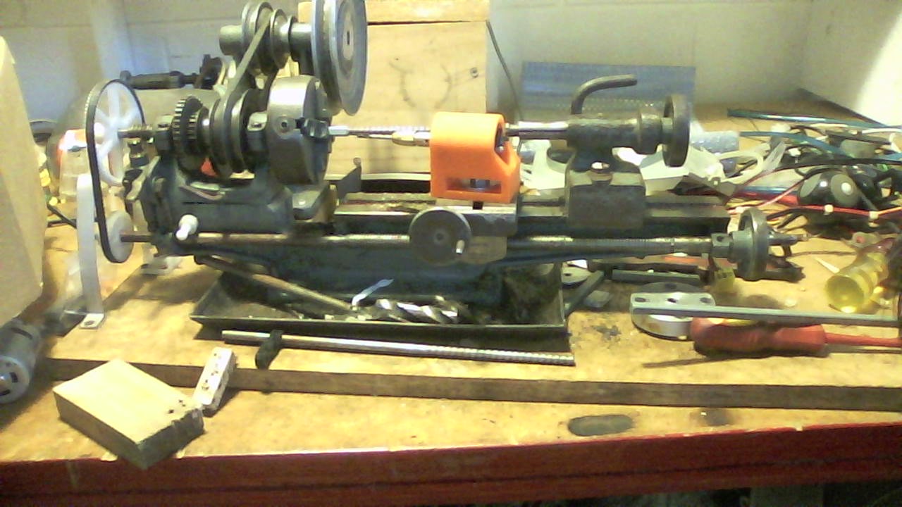

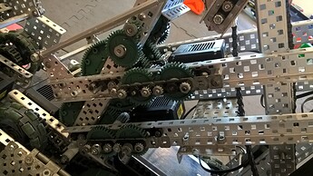

Sorry for the late reply. Here is some pictures of the leadscrews that we tried to make

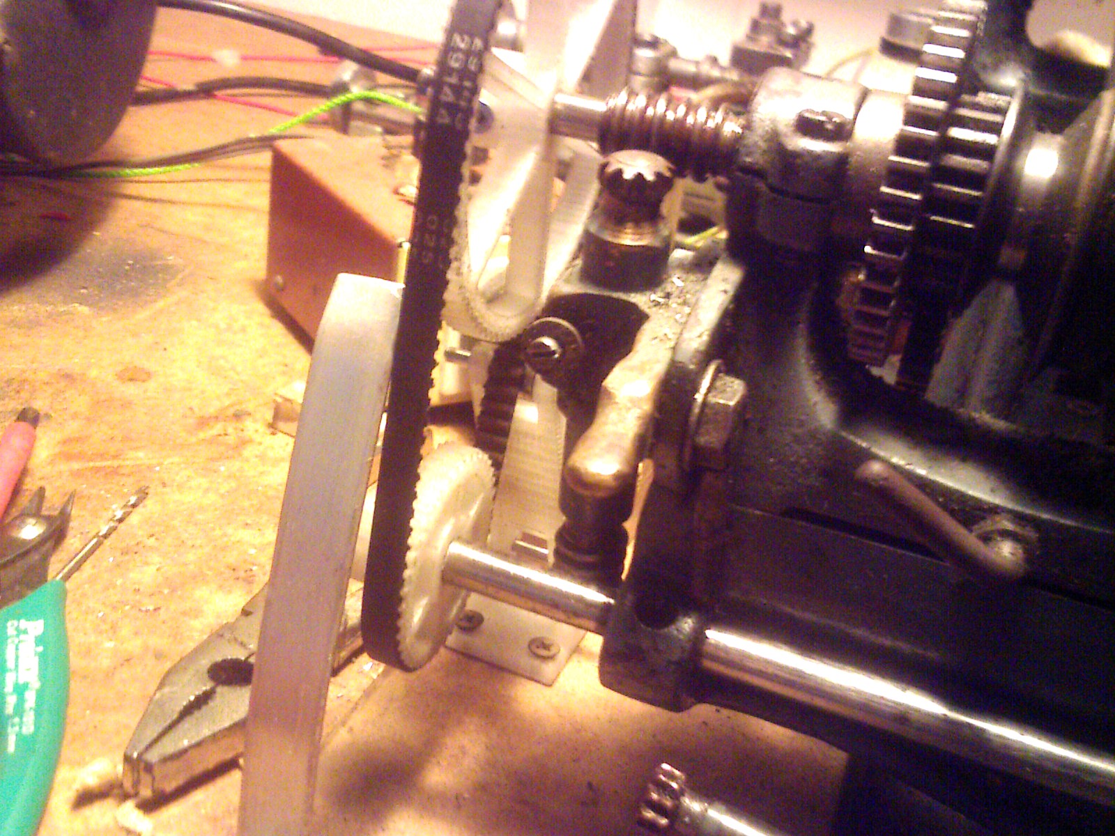

We only had a small model lathe available to us so we had to make our own connection from the chuck to the feedscrew using 3d printed pulleys and gears. The plan was to create one direction of thread using the belt connection and the other using the gear drive.
As for CAD, all the 3D printed parts were designed in Openscad and the gears(not seen in these images) and pulleys were created using a modified Openscad pulley generation script from Thingiverse.
We never got to finish them due in part to problems in getting the thread cut deep enough due to deflection in the screw because of the small diameter and the resulting low cutting speeds.
We tried at one point to grind the threads using a DC motor and grinding disk mounted in a 3D printed bracket however we never managed to get this working before Nationals.WIN_20200221_20_03_37_Pro
WIN_20190716_21_15_45_Pro WIN_20190716_22_02_25_Pro
early leadscrew prototype:
WIN_20190717_15_16_22_Pro

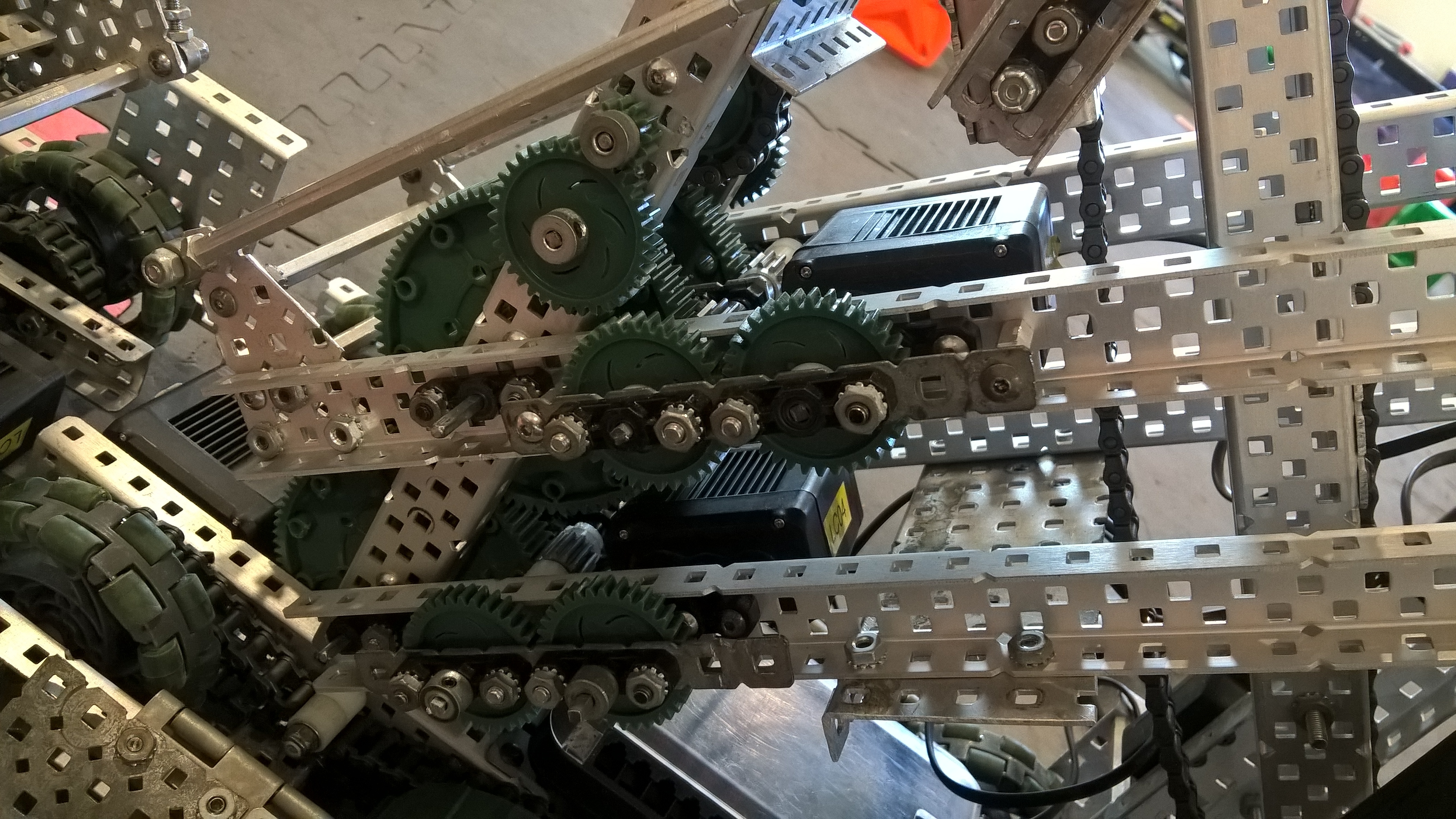

Power Takeoff mechanism(A slightly earlier version. Some stuff was improved on for the final version on the robot at Nationals) :
