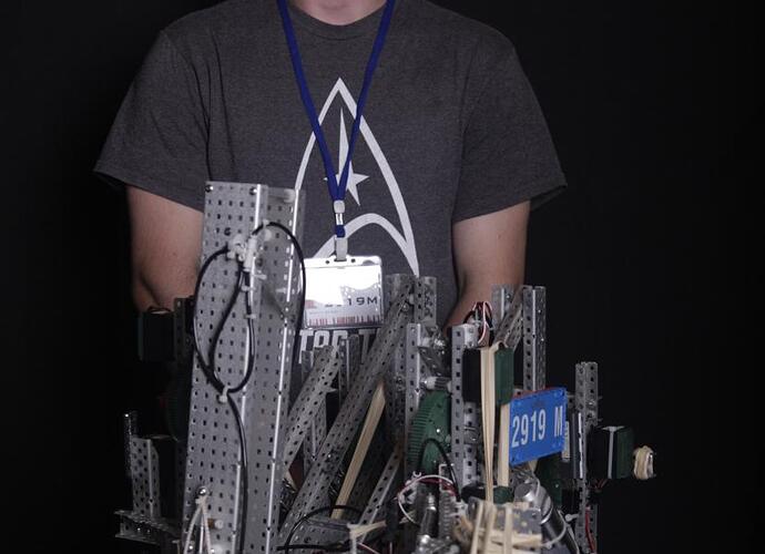

Hey everyone :slight_smile: now that the season has come to a close for 2919, heres the reveal for our final robot we used to compete at NZ Nationals 2015, Mareep.
The specifications include:
> 4-motor Tank Drive (Toggled between tank and arcade control during match)
> 6-motor Reverse 4-6 Bar Lift
> Pneumatic Reverse Skyrise Claw
> 2-Cube Capacity Needle (Passive Intake / Pneumatic Outake)
> 2 Autonomous Routines (Dependent on tile placement for both skyrise and cube scoring)

I’ll try get a few pictures next week to post, but until then, here’s one (ignore the nerd behind the robot :p) : [ATTACH]9126[/ATTACH]

Your robot looks great! Looks like you’ve done a lot of testing in order to make everything work. I like the anti-tip system. Haven’t seen many like it.
What gear ratio were you using on your lift?
What were some of the major obstacles you faced in carrying out this design, if any? What was the most difficult thing to get right?

Thanks! Lots and lots of testing with multiple designs for everything to come together :stuck_out_tongue:
For the lift ratio, its just a 1 : 7 ratio using 6 motors.
I’d say the three major things were the bracing on the lift (which was limited due to my needle deployment), the needle mounting, and the setup and mounting of the claw to ensure that I only needed to drive forward and backwards to build my skyrise :slight_smile:

I think I made a booboo on the H-Drive… it was 1am when I wrote it and no I don’t mean a strafe wheel :frowning: just the structure.
I agree I didn’t mean H-drive in the right sense sorry, early morning writing and I wasn’t thinking straight :stuck_out_tongue:

That’s 10 motors so the 4 tank drive ones have to handle both parts.
One of our teams 81H Havok had an H drive this year where the four (normal) left side right side wheels were powered by two motors and chained together for movement along the “Y axis” going forward and backward. They had two additional motors on two more omni wheels faced perpendicular to them driving the bot left right along the X axis.
They did not have as good movement as 2919M. Our guys cut out a bunch of times on the forward/backward motors due to those pesky PTC circuits. And the placement of the left right wheels drove better but not exactly along the X axis.
Looking at the video in this thread I would say it was 4 motors only on the Y axis as it moved pretty good and did not exhibit true horizontal motion. Maybe he just had better weight distribution than our guys to make it work.

Would you mind explaining how the needle shown in this video works?
It almost looks like the joints are bending in place while intaking cubes.
What was the reason for not using it in competition?
Good question :slight_smile: Those videos were more to document small parts of the robot to help with design notebook etc. as I’m a single person doing the design notebook.
It worked but we scrapped it before actually mounting it to the robot due to the weight as it was quite heavy. Hope that answers the question?
Definitely. I was also wondering how exactly it worked? I wasn’t able to catch how it was able to compress while going into the cubes to intake them, and it doesn’t really look like anything I’ve seen before.
Are both the 2 hole c channel and the standoff attached to the large 5 hole c channel or do they slide/move somehow?
