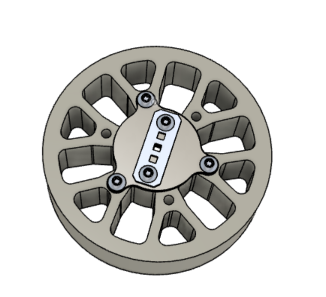

Hey all! So one of the many complaints of the 3" Flex wheels is the fact that when put onto the VersaHubs, almost all of the flex is gone. So I have created an adapter that would ideally hold the wheel on firm, but still allow for a decent amount of flex.
Screenshot 2021-03-08 133610
It is designed to use 2 lockbars, one on top and one on the bottom, that would screw in to the holes as shown. I used metal lockbars for this, but you can also use the plastic ones.

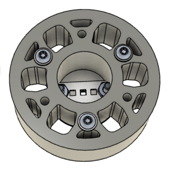

I would recommend using standoffs to hold the wheel onto the adapter- the assembly (without the wheel) is shown below:
Screenshot 2021-03-08 134507
The standoffs would go into the holes on the wheels, with a screw and a steel washer to hold them in.
This was all designed in Fusion 360.
Note: For these images, I used a generic white plastic so that it would show up better. You would probably want to cut them out of lexan.
Thoughts, suggestions, and (constructive) criticisms are welcome! And stay tuned! A 3D-Printable one for VEXU may be on the way!

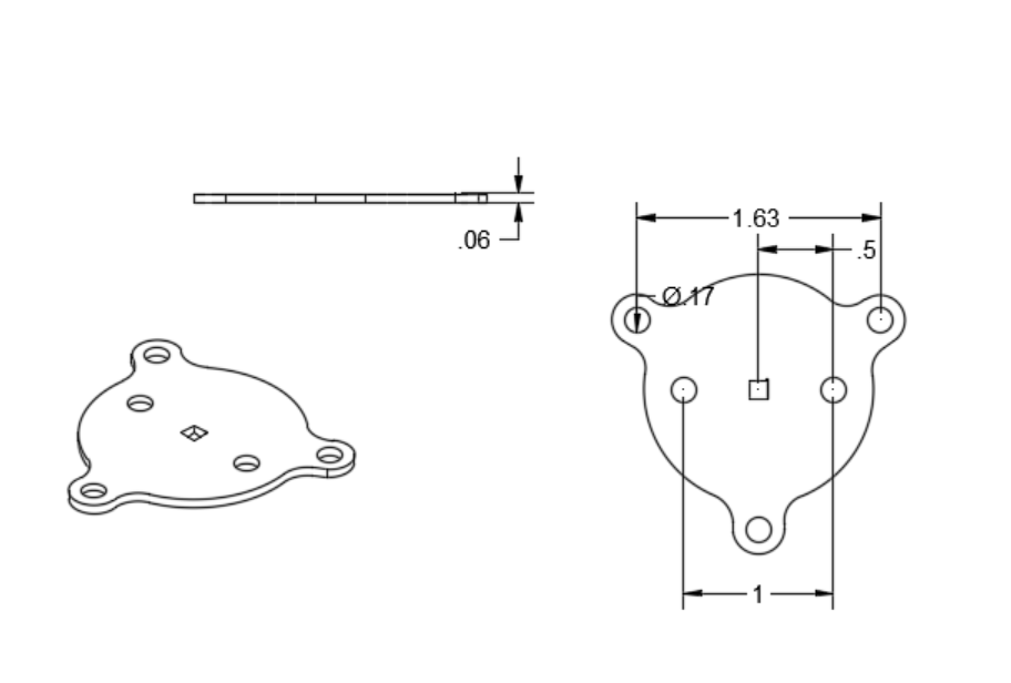

Cool! I’d love to see the technical drawing for it.
You’d probably just want to zip a folder and attach that.
3_adapter.zip (9.8 KB)
There we go. Thanks, @trontech569.
Screenshot 2021-03-08 150610
I’m still pretty new to this, so I’m not entirely sure how to do this, but here is my attempt.
I would call out the vertical dimensions of the part (you only dimension it in the horizontal dimension). Otherwise, looks good!
