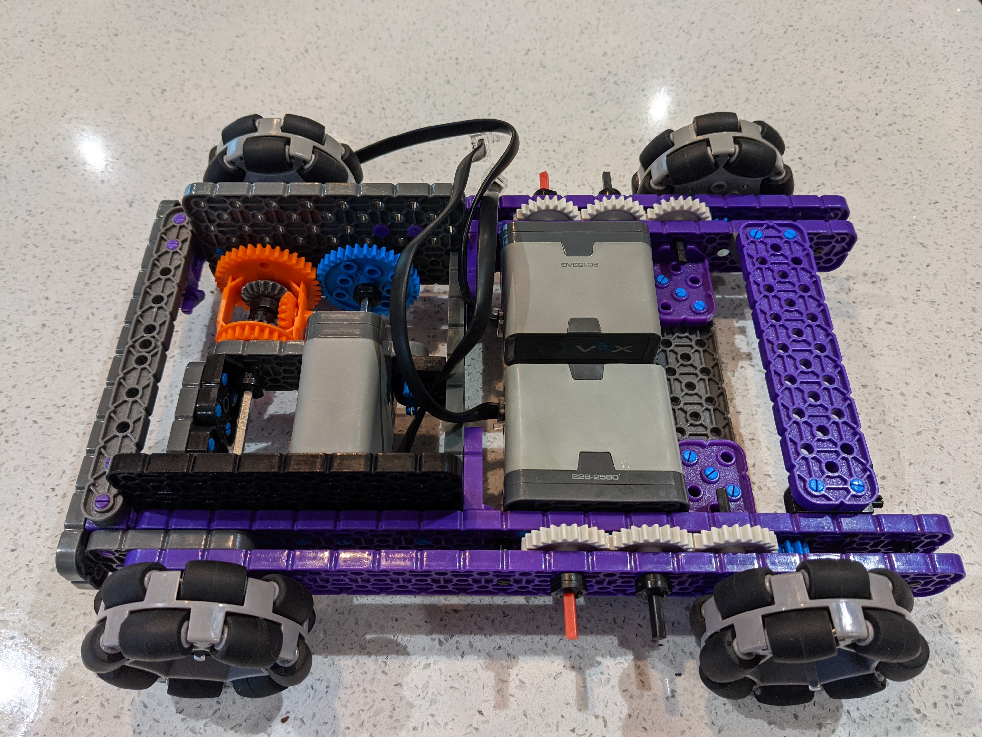

PXL_20210102_025409483
Here is the start. We just use an old robot drive train, front wheels are geared three to one. I have the differential set on the smaller side powered by the 48 tooth gear. What we are struggling with is how to keep the drive shafts inside the differential. There’s not much room at all in it, I can squeeze a rubber collar onto the end of each drive shaft, but if you so much as bump a wheel or something it always keeps coming out. I have all the pins that are included in the kit, which that seems to hold the side bevels, but it’s a square plastic piece on the side and I’m not sure how I can get that to hold to a drive shaft.
Nice start!
I might try to fix your problem by moving the differential closer to the wheel, perhaps adding another beam between the gears and the main base wall, and shortening the distance between the motor and the gears. Then you should have room to add a shaft collar without it popping off.
Also, I might try to add some supports for your 2 motors in the front- they appear to be bending down. A beam underneath it should do the trick.
@VexTeamZ Thanks for the feedback! The drive shaft we have are plenty long. Just to make sure we’re doing it right, we have two driveshafts meeting in the differential, one coming in on each side connected to the side bevels. We have room to slide a collar on each of them in the middle. The problem is bumping the wheels or any slight pulling, the drive shaft comes out a little bit, with the bevel and collar coming loose and off.
Looking at the sample built on the product page on vex’s website, it didn’t look like it had a drive shaft sticking in them, so that’s why I was seeing the right way to get things to stay together and work. There are 1x2 iddler pins that come in the kit and was seeing if that’s used in any way (we used a 0x2 iddler pins for the middle bevel).

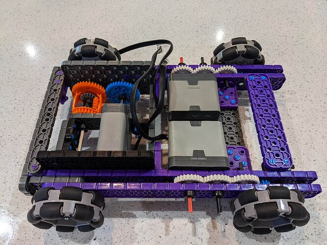

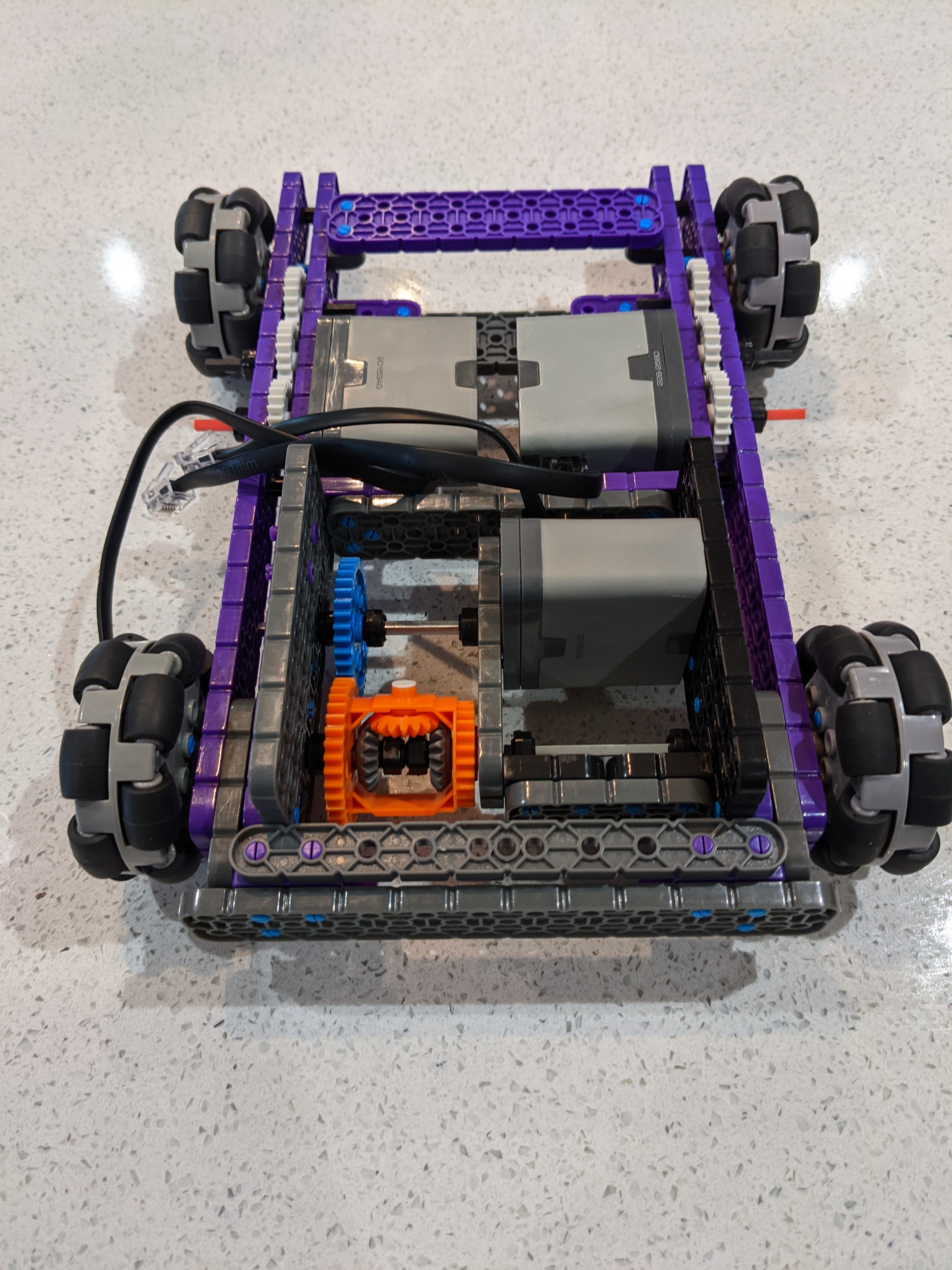

@FRC973 here is a couple pictures of an updated build. The first few pictures we didn’t really put everything together tightly enough just as we’re still figuring things out, but this looks to be more of a final build. I did have a 48 tooth gear powering the rear differential to the 24 side, but the 48 sat so low that I had to switch to a 36 tooth gear and I just powered that on the 36 side so it’s a one-to-one gear ratio on the back. We also dialed down the gear ratio on the front wheels from a three to one to a two to one. hopefully the two different gear ratios between the front and back won’t make a difference, but I can always go back and put the 48 tooth back on for a two to one ratio if I need to.
We put a few more rubber collars on where we could and it makes it a little better, but one good yank of a wheel and it’ll pull the drive shaft and bevel off the differential. now that there are capped drive shafts, if the differential was really two pieces that could snap together that would be the optimal path to keep the drive shaft from getting pulled out.

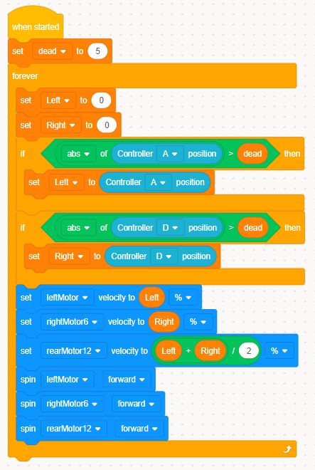

code snippet diff
here is the sample code we used. The kids do a tank drive, so i copied the example block and added logic for rear motor. Tested it and everything works.

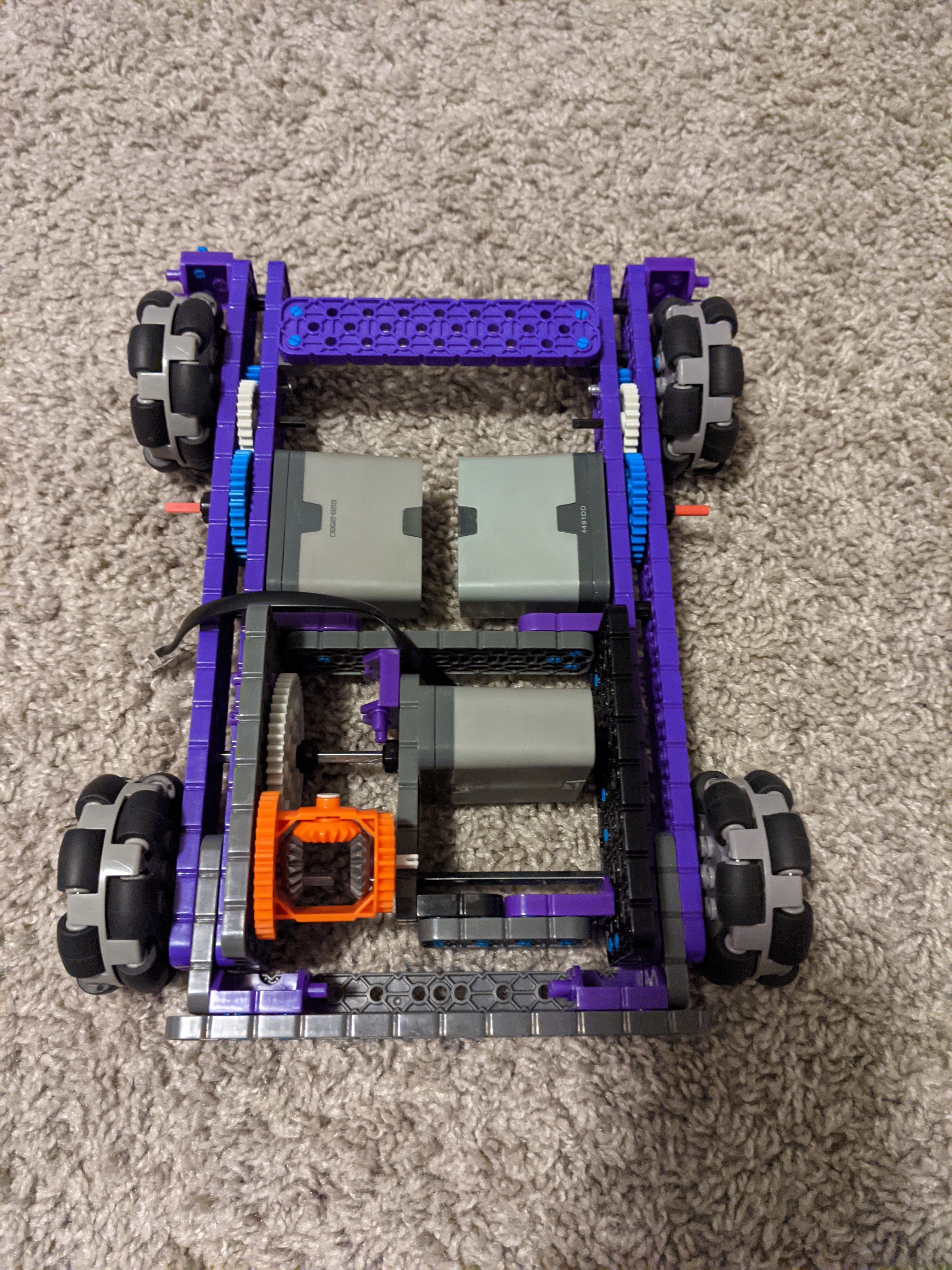

First test run obviously shows everything works, but felt sloppy. Makes me wonder if both the front and rear should be geared the same, so i’m going to swap the differential around and power the 24 tooth side with a 48 tooth gear so they are all 2:1. Also, I had omni wheels for all our wheels. debating if i should make any of them the stock ones. (taking comments from the peanut galley for that :slight_smile: ). I’ll do some more tinkering and post a video tomorrow.
I’ve done something like this before but you can just have all three motors powering the rear wheels and then connect them to the front as you usually would to make it 4wd. It’s been a couple of years so I don’t have any pics or anything like that. I really would try to use all-metal shafts on your drivetrain as well, especially where the motor and wheels are.
I would gear everything as the same ratio as well.

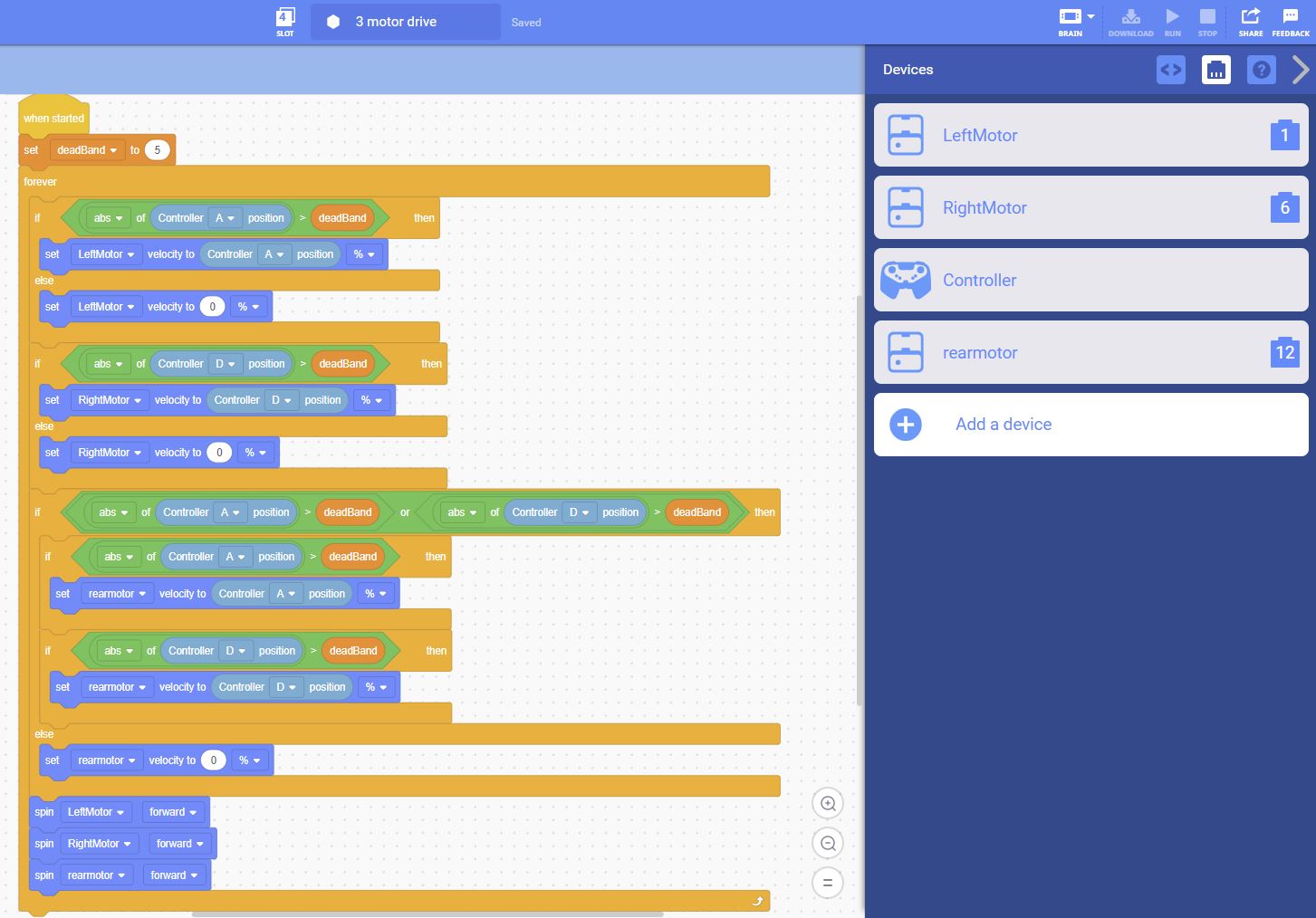

Also, just set the rear motor to (A+D)/2. It’s just going to do the average of what the left and right motors are doing. I can imagine that if you are turning left or right you get it to be very jumpy as you are setting the rear to +100 and -100 at the same time alternatively.
Here’s how I would do it. (I really don’t like to use the “else” blocks if I don’t need to, they are really… blocky…)
