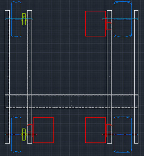

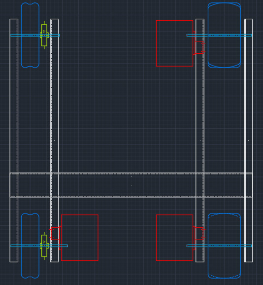

You could do this actually, you can do 2m mechanum on one side and then one motor chaining 2 omnis on the other

If you are after just the ability to move forward/backwards/translate/spin, build a Kiwi drive:
lol, i just drew the same sketch.
edit:
What did u make this in?
but won’t this offset result in unbalanced forces on either side of the robot?
I seriously would hate such a lopsided powered design. The left side will not just be slower, but have more torque than the right side. If you can program the mess out of the design it will be possible to make the robot drive straight via motion profiling with this design, but holy crap that’s a lot of work to save one motor (But I can see the advantages of it). I would rather just suggest doing a 3 motor H-Drive using omni-wheels in my opinion.
2D autocad. Just a file with 2D blocks of vex parts.
