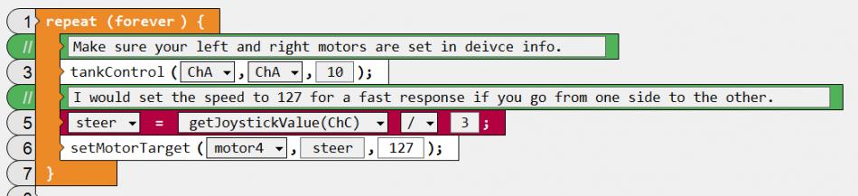

This is doable in graphical. You will tie the third (steering) motor position to the joystick value. You need to start the program with the steering motor centered, so you’d have defined zero angle.
Then, the simplest form of the program would look like this:
repeat(forever) {
    tankControl(ChA, ChA, 10);
    steer = getJoystickValue(ChB);
    setMotorTarget(motor3, 0.5*steer, 50);
The steer line is created by using “Variable [Value]” block in graphical, you’d need to add a new variable there too.
You may need to play with the gain (how many degrees per joystick tick, 0.5 in my sample) and since you don’t have a differential gear (or do you), your driven gears would still fight a bit in the turns.
To counter that, you’d have to replace tankControl with your own implementation (again, using another variable from the joystick and distributing the power between the left and right motors based on the “steer”).

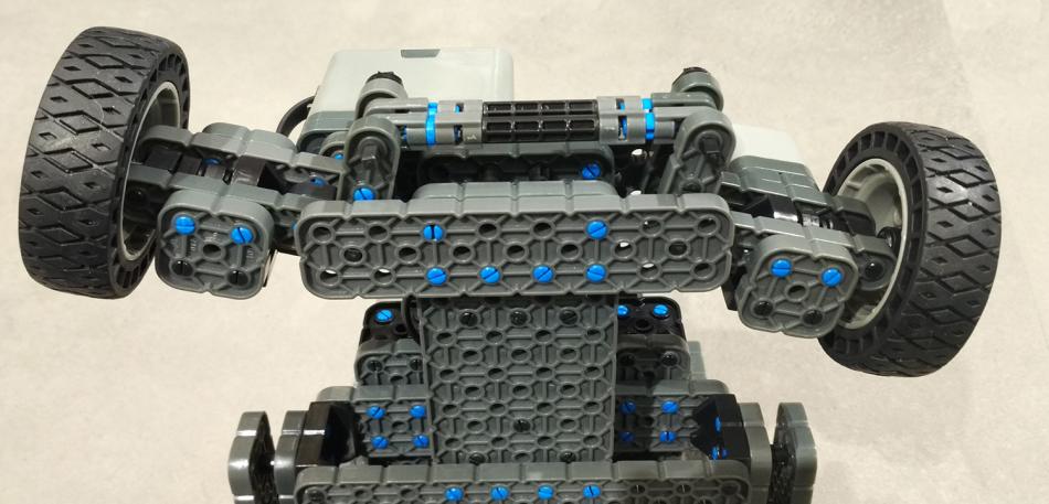

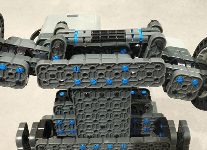

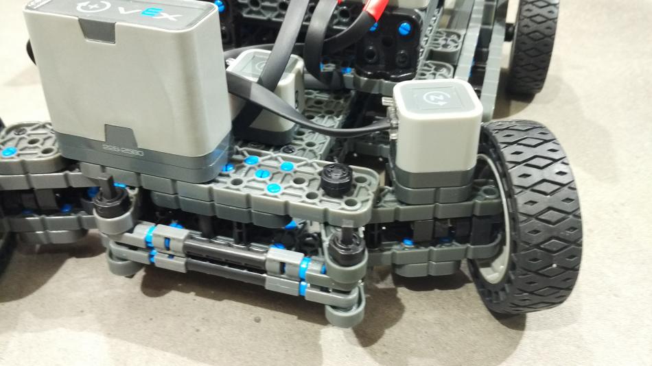

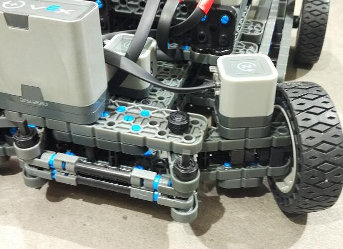

Can you share a picture of this? like how the front wheels are connected to the body? My son would like to see.
Sure, it took me a while to devise it, and I over-engineered it, as it is going to be driven by 50 children for 4 days over a Winter Camp. So it needed to be strong.
Sorry, it may be quite hard to build from these pictures, but its mainly using two 3x5 angle Beams and an 2x8 beam to tie it all together. The side with the motor on, I had to use two 1x3 lock plates to transmit the turning and on each hub I used two 1x1 chassis connectors with a large chassis connector to hold it together…it took a while, but works alright…Although no Ackermann Turning, but it works alright for low speed turns…

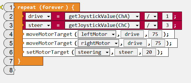

My code shown here works great to drive my robot and turn it (Thanks for the help) - but now I have a problem if the wheels are turned when the program starts then it (remembers) that position as ‘middle’ and then you cant easily drive straight…

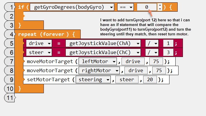

I have tried to connect two Gyro sensors onto the robot, one on the body (target) and one on the steering arm (desired) and I want to run an initialization part, that will tu rn the steering motor until the two gyro’s match, then reset the steering motor’s encoder so that it knows that is the center…Any ideas… Thanks
I would just set the motor to the value of drive. As this is currently written, the speed is static. The car should move at different speeds based on how far the stick is pressed.
Use setmotor(motor,drive);
Also, the gyros are just nowhere as reliable as the integrated motor encoders. You could have a button that would reset the encoder to zero once the car is straight, and then another that would set the motor target to 0 when you want it to go straight.

    BTW: The gyro matching won’t work - the gyro sensors each have their own reference frame and know nothing about the other one. So if you start with the wheels turned full to one side, both gyros would happily report zero. Even if you calibrated the other way and reset the wheel gyro at the midpoint, both gyro sensors would drift over the time, each on its own pace and direction…
    Nenik - Thank you so much for your assistance! - Yes, you’re right about the gyro’s (I haven’t used mine yet so they were all zero’d at the same angle, so it worked first time, but after I started resetting the gyro’s it got messed up) so onwards and upwards.

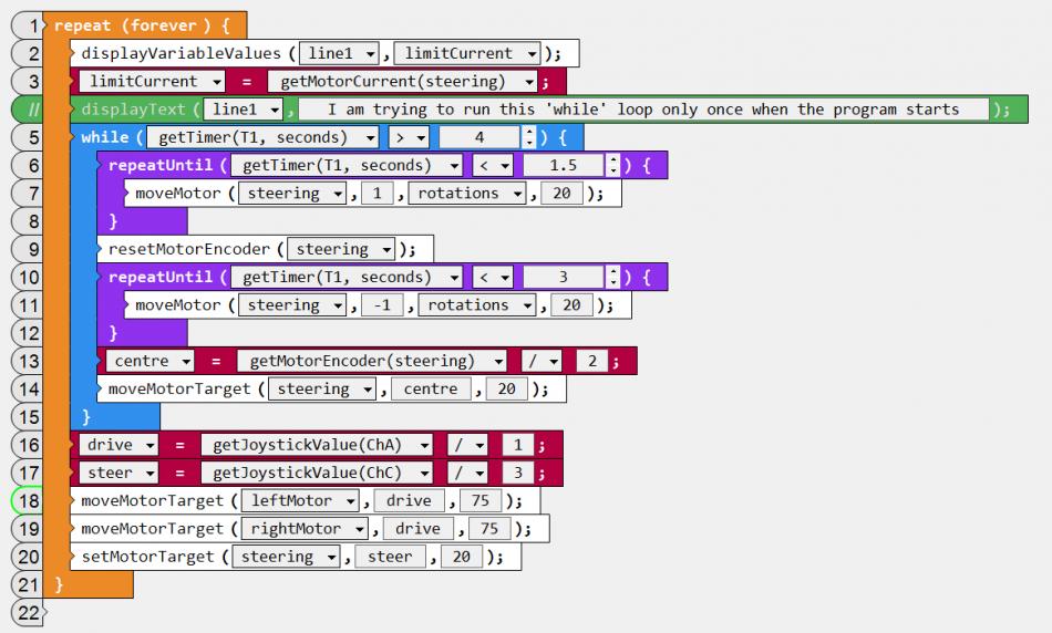

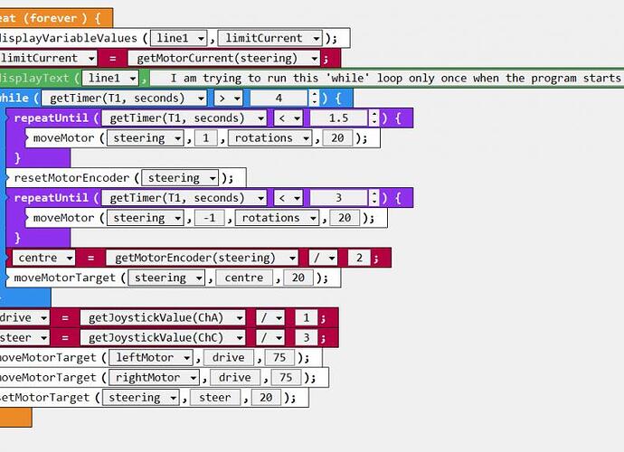

    Onto your next proposal, it is sound, but for the life of me I cant figure out how to run an initialization loop that is inside the main ‘forever’ loop, that will not run the initialization part each time it loops. Here is my code so far. I am attempting to use the timers (which I guess start when the program starts) and I want the initialization to only run for the first 4 seconds, after that even with loop iterations it will skip that section and only run the ‘driving part’.
    At the moment, the steering turns to the right, but then doesn’t do anything else…I cant figure out my error, (or another way of handling the initialization)
    Oh, you don’t do that in the main loop (though your timer-based sequencing is quite creative - I’ve once had my students use something similar for sequencing actions while driving, but RobotC graphical missed variables back then)

    Your code didn’t work for few reasons:
    [LIST=1]
  • The while() loop has the opposite condition (it would start calibrating after 4s)
  • moveMotor is a blocking function. It won't finish until the motor finishes the move, which it won't - it can't mechanically move one full rotation. That's why I use seconds instead.
  • you don't reset the encoder after reaching the midpoint. [/LIST] Hope this helps. You might need to tune the current limit, 200mA might be too low to steer on some surfaces.
  • As I wrote it, tankcontrol(ChA,ChA,10) will control the left and right wheels with one stick, making them both move as if they were on one axle. ChA is controlling both the left and right wheels. This will give you the desired effect.
    You could also just set the motors to the value of the stick, not sure why you’re using set motor target with the driving wheels.

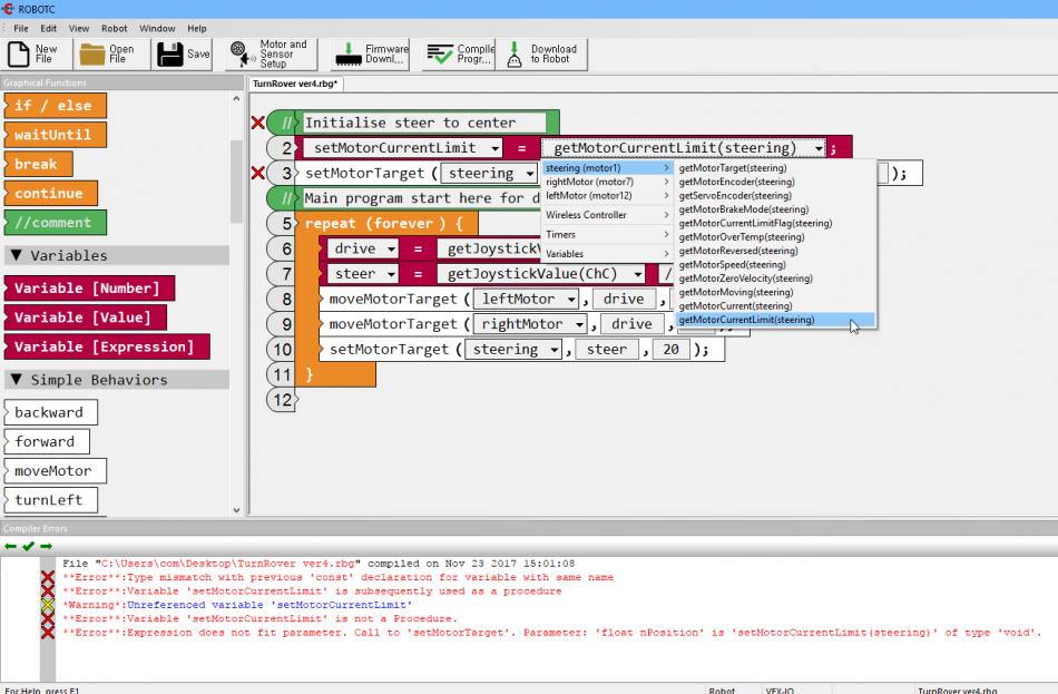

    Once again, Thank you so much for your advice! I may have to do this in RobotC non-graphical as I can’t figure out a way to setMotorCurrentLimit. I can read the current value from the motor and save the number in a variable, but the non-graphical way is much more elegant and straight forward.

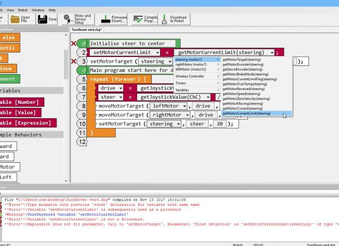

    Thank you, once again, for your generous assistance. It seems that I have hit the limit (excuse the pun) of what RobotC Graphical can do. I can’t see any blocks (even in Super User Mode) that can allow me to setMotorCurrentLimit - I can create a variable and READ the value that the motor is currently set to (about 3.5Amps! ) but I cant seem to set it?
    Perhaps it’s time to switch over to regular RobotC?
    AAhhh, Thank you Sankeydd, I miss read your previous post about TankControl. I didnt realise there were two ChA’s - Thanks ill give that a try as it’s simpler.
