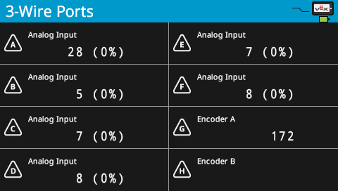

I just checked that and see no issues, you can also go to the devices screen for the 3wire expander while your code is running and see encoder values there.
screen
The encoder seems to be working fine, but calling:
SideEncoder.rotation(rev);
Still gives me the large values after a bit, despite the fact they are not shown on the brain screen.

I know this is a late reply, but i’m having this issue as well. here’s a video of it:
idk why its youtube shorts lol
The video is not really useful as the 3wire ports are configured as analog inputs. You will need to configure for an encoder in your program and then check the dashboard while the code is running.
I found the issue in this documentation: https://kb.vex.com/hc/en-us/articles/360039512851-Using-the-V5-3-Wire-Optical-Shaft-Encoder.
Apparently the two wires from the shaft encoders need to be plugged in specific ports in able to work.
