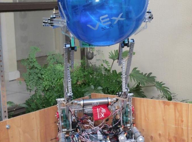

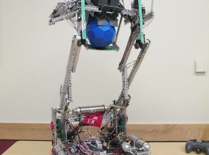

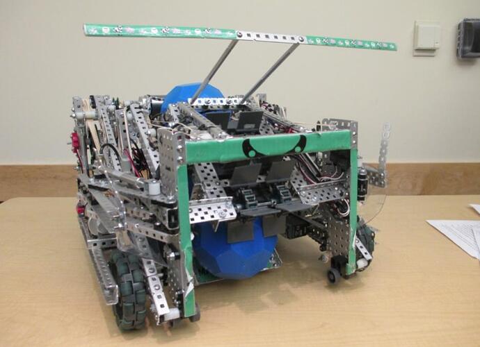

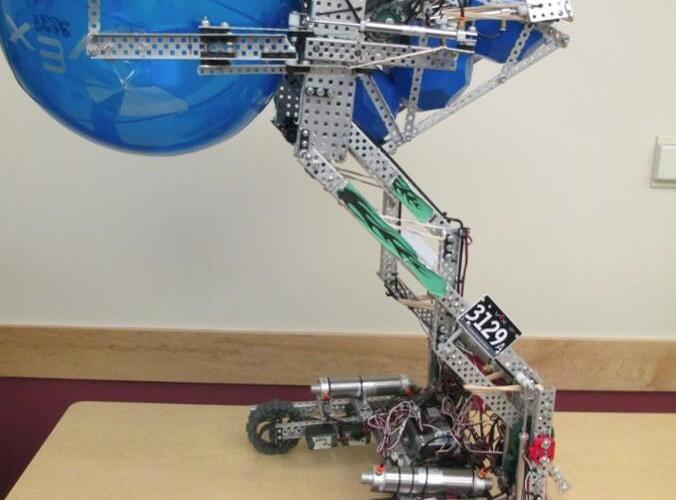

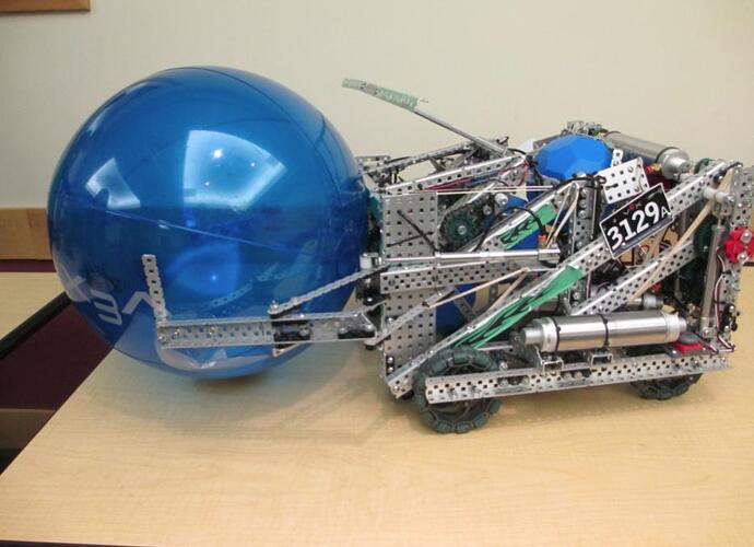

And now for something different … from 3129A The Green MacHHHHine from Mountain View, CA, USA.
4 Omni wheel, 6 motor drive, all high speed, 3 motors chained together on each side
2 Motor + plus 4 piston assisted 6 bar lift
2 Motor top roller buckyball intake
Pneumatic big ball claw - stashes big balls consistently
Passive big ball knock off bar
Many autonomous routines
Pneumatic hang with big ball
5 Air tanks
(about 18 pounds)
