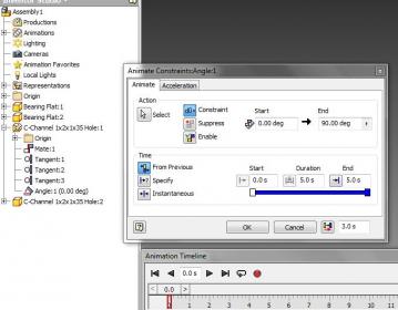

Animation in Inventor studio:
Simple lift I created:

Each side contains a 3 bushing at the top of the C channel
The left C channel is grounded
The 2 3 bushings are connected by a insert constraint with a distance of 1 inch
You should now be able to spin the second C channel as a lift would
Place an angle constraint between the 2 C channels to your starting angle (in my case 0 degrees)
Open inventor studio: (Environments/Inventor studio)
In the parts list box on the left side (I do not know what its official name is) expand one of the parts that has your angle constraint (the 3 bushing) right click on the constraint and select animate constraints
Select the ending angle and the time
This is how it should look now:
[ATTACH]7590[/ATTACH]
Press OK
You can drag the time bar to see how the animation acts as time progresses
