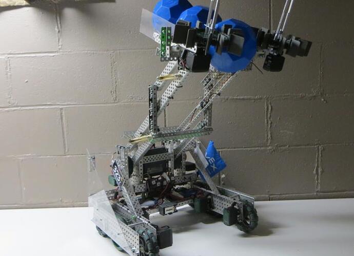

Lift- (it’s so beautiful)
2 393 Motor Lift
1:5 (Torque) Ratio
6-Bar Linkage

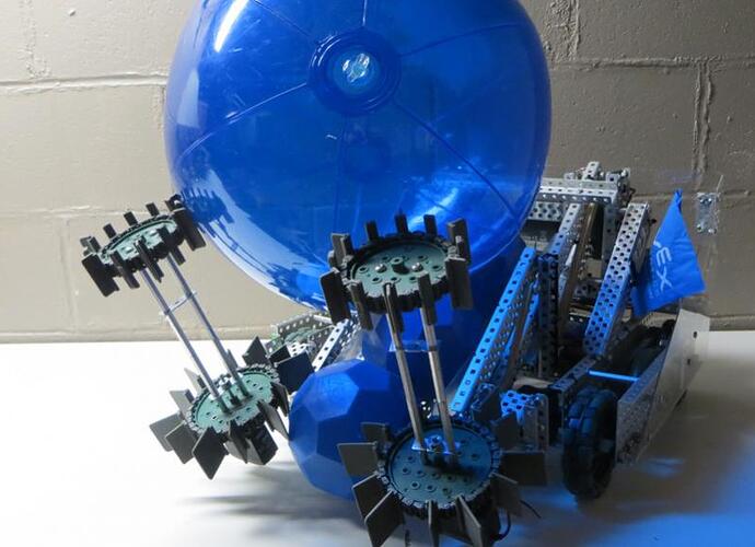

Intake-
2 393 Motor Intake
1:1 Internal Gearing
Classic “NZ Roller” w/ Large Ball Top-Side Roller
The lift was put together in one meeting, and hasn’t changed since. It works so good with the rubber bands, and half of the time, the motors don’t even need to work. The Drive is very nice. We are able to push large robots out of our way, and it is very smooth getting over the bump. The intake just got (mostly) perfected after a long 7hr meeting today. It intakes the buckyballs right away, and the large balls get intaked without smashing into a solid object.

Ah Jesse, you’ve done it again!!!
Looks nice and clean. It’s good to see that you’re able to operate the lift with only 2 393s. I take it you’re not hanging. Is this something your looking into? Also, why did you decide not to build a strafing base? (either mecanum or x-drive) I suppose it’s because you wanted six motors on the base for the power and can’t power a strafing drive with 6 motors?
Haha. Thanks! See you at Warren!
Currently, we cannot hang. We can change two gears on our arm then hang. Right now we have other priorities other than hanging, but I have a feeling we will be hanging by February.
We didn’t see a need to strafe. Does anyone? Sure you can do cool manuvers, but wouldn’t you want to have a solid tank drive that can push 20lb steel robots? Also, both the X and H holonomic drives did not work with our design, and those mecanums… I’m sorry, those are way to big.

Very clean, sturdy, and fast. Well done.

How did you make your tower rollers so thick and tall without interfering with field perimeter? At our last competition, our rollers were of similar height, size, and I believe angle, yet our rollers still had issues with the wall.
Thank you. That was our goal this year!
We had trouble at the beginning, but Jeffery (our intake expert) fixed it (somehow) and it barely interferes with the wall. I don’t know what he did, but he made it beautiful :wink: We can add the biggest sprocket onto the large ball intake, and we can still intake buckyballs off the wall well.
Our intake did terrible at Zionsville though. Our current intake is 200% better. Our objects should actually stay in our intake this next competition and slide out without getting caught. :smiley:

I do have a question though, i see your motor hangs off the c channel for the intake. Is this to allow some morph room for the big ball? I have a very simialr intake that picks up the big balls very well, but it just looks unhealthy :confused: . Did you have this problem when picking up big balls?
( By “unhealthy” I mean it looks like it expands a little more than it should)
and again Great job :smiley: !
Haha. We hope to be :slight_smile:
Yes. We planned to have our intake flex to intake the large balls. It works very well.

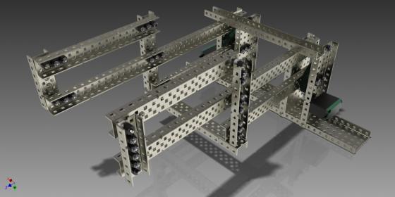

If you don’t mind me asking, I have a couple questions about your lift.
How long is the main arm? To around what maximum angle can it reach (if it’s something you actually know/ can measure)? Also, how high is the bottom of the intake at this maximum height?
I ask because you have your bars similarly spaced to what I was thinking for a new design I had in mind (I believe 3-4 holes in between each level).

Fantastic work. One question: I notice the chain between the center and rear wheels hangs down substantially. When crossing the bump, have you snapped that chain?

The longest bar is 17.5". What do you mean “what maximum angle can it reach”? From the ground to the bottom of our tray is ~24.375". Perfect height for scoring the stash :wink: If we really wanted to, we could raise our whole entire tower .5" and also extend our lift about 1.25". We could easily reach higher, but we don’t need to.

The chain does drag, and no, it has never come close to breaking.
Hi Jesse. Like this I believe:
It is fair to say that the chain has not broken to date, but that does not necessarily mean that it has never come close to breaking. It would be very difficult to measure how much peak load could be placed on it when it hits the bump at speed.
Impressive CAD work :), Paul
So does that mean it does hit the wall, but bucky balls do not spill out? Do you still use the same expansion system as in this video?
can your intake still grab without the tower rollers hitting the wall?
The intake flips down instead of from the side, as you can see in this video. [http://m.youtube.com/watch?v=sblKEGaWWFo
