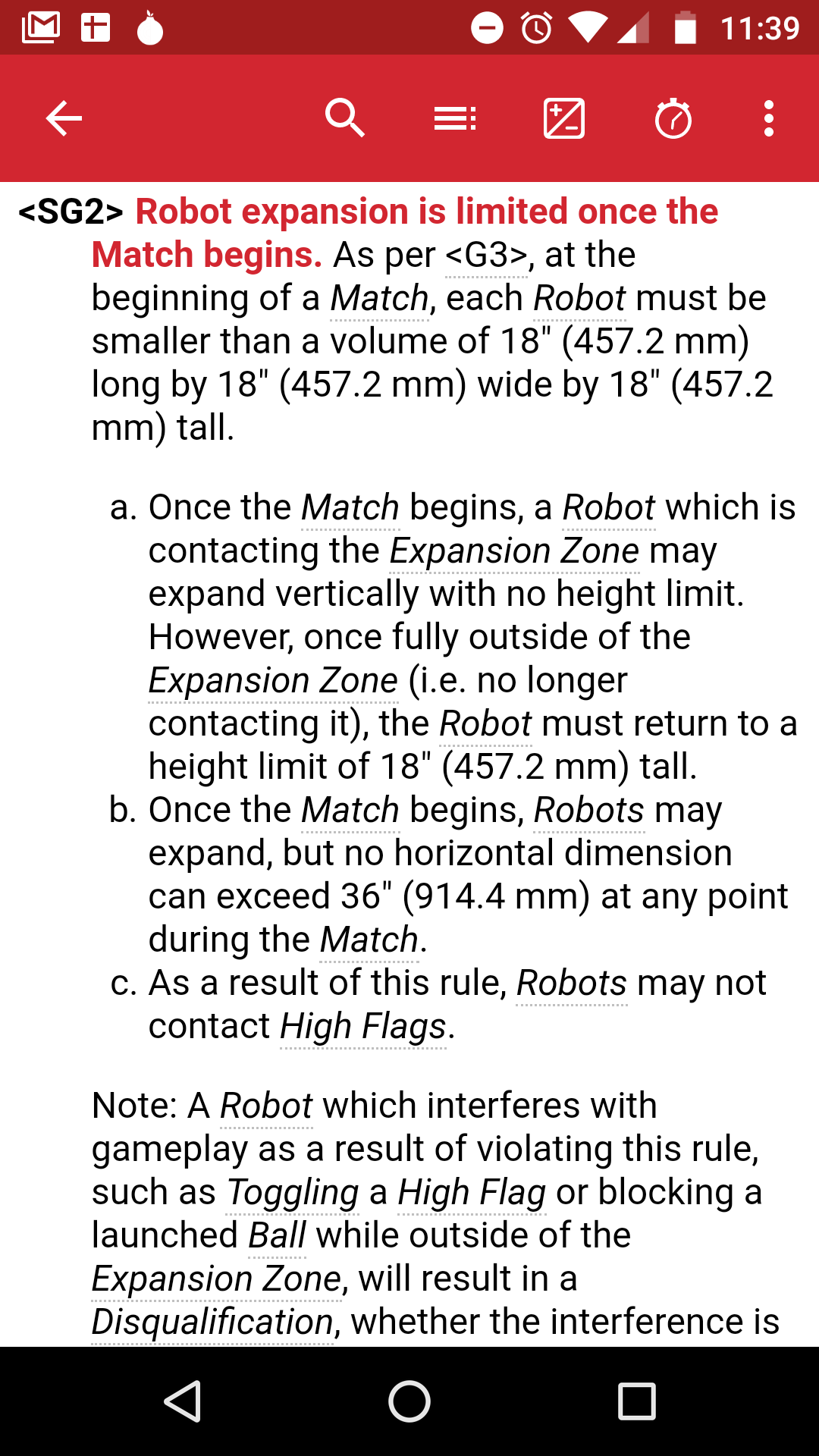

At a recent tournament, a team was pushing the limit in terms of horizontal expansion. I brought it up, and the refs were adamant that it was a 36 inch square, not a cylinder like I thought. Which is it?
https://www.robotevents.com/VRC/2018-2019/QA/67
See above q and a.
If the refs said that, they’re totally wrong. But yours isn’t quite right, either. It is neither a square prism nor a cylinder. The link @TeamTX gave is good. The actual shape is closer to the cylinder idea, but the robot can extend outside of such a cylinder by a little bit while still remaining within the allowed expansion. Think of it more like a cross between a right cylinder and a right, equilateral, triangular prism. Look here for further explanation:

I believe that the best way to visualize it is to look at the top of a robot as if it were a 2D image and if any point on the bot is >36 inches away from any other point on the robot then it is out of size
afaik, its actually a reuleaux shape, but that is closer to cylinder than to rectangular prism
That’s a cylinder you just described.
Yes.

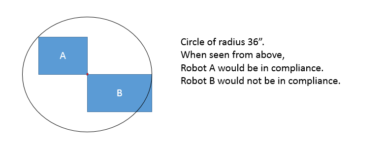

You know your interpretation allows a robot to measure nearly 6’ across in every direction, right? (To be stable you’d probably have to limit it to 5’ or so.) That robot would occupy nearly a quarter of the entire field.
A is illegal. B is legal. (And it looks like they’ve now replied to your post to state that officially.)

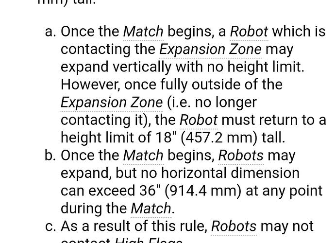

This isn’t the right way to use it, though it will suffice in many instances. I’ll explain how to use it properly for the dimensions being analyzed. Look at the third image on this page:
You’ll see the sizing tool should be held in a vertical plane. You can then spin it around a vertical axis so it measures different horizontal directions while remaining in a vertical plane. Check from one outer spot (meaning hold it against that spot while rotating around a vertical axis through that spot) and then translate it horizontally as needed to check other outer spots. If you can get it to go around the entire robot without touching, the robot is legal. If going around the entire robot this way cannot (not “isn’t,” but “cannot” - don’t want unsteady hands to be a factor) be accomplished, it’s illegal. Technically, the sizing tool should be infinitely thin, but that’s not possible, and it’s highly doubtful that will matter, as if it does matter a little bit of vibration or wobbling is likely to take that 35.99" robot to 36.01". Note, you might have to tilt the sizing tool a little while keeping the top bar horizontal if a robot is in the expansion zone and a tall piece blocks using a vertical plane.

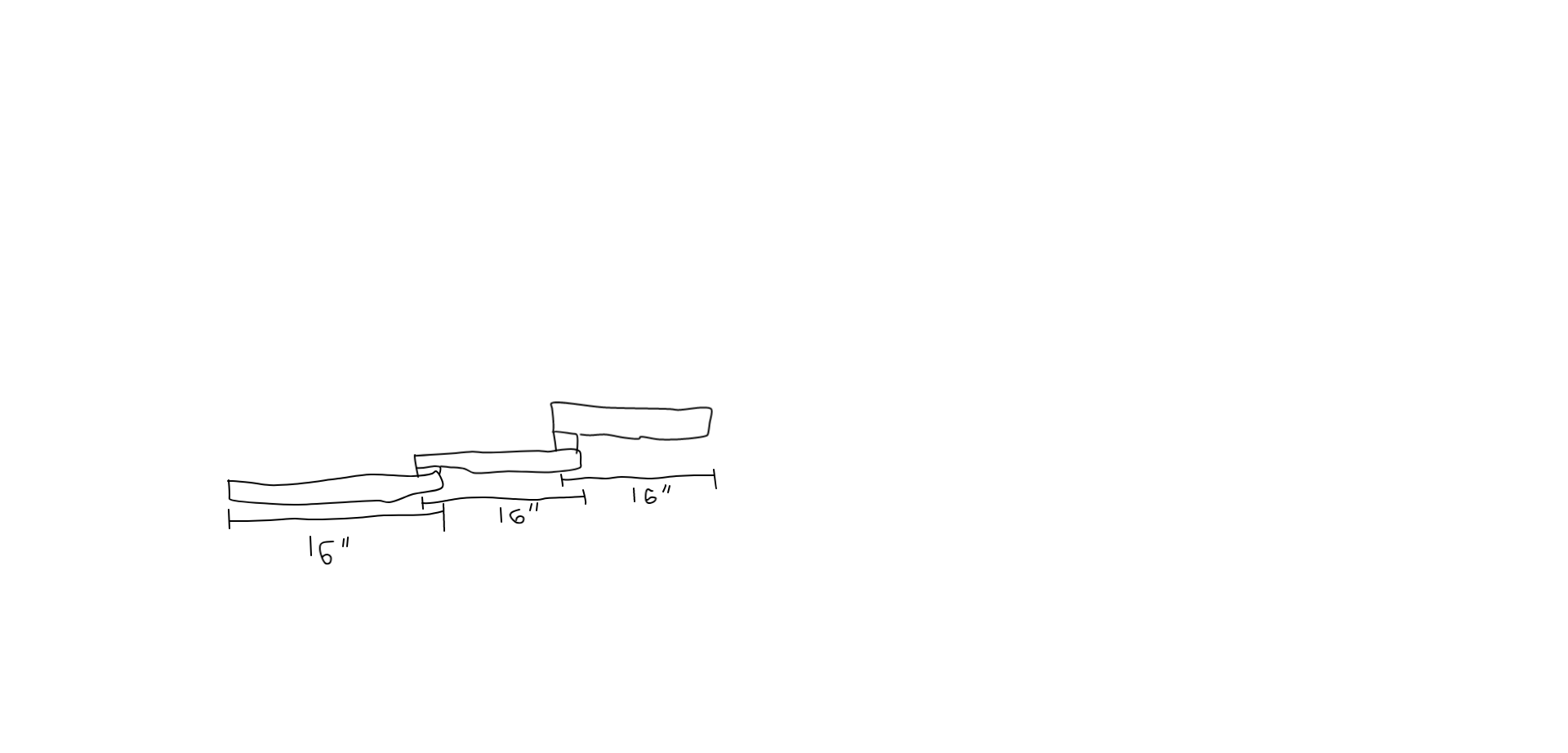

@sankeydd If I understand your interpretation correctly, this side view of a robot would be legal? At no point on a plane of say “z” inches is the robot over 36" because of the rise before each extension. Correct me if I am wrong but I believe this is how both @callen and I interpret it

As @callen didn’t think the robot from @Sylvie was legal, I doubt he would think this one would be OK. If you held the tool vertically as the product page shows it would not pass. I think it’s OK though.

A robot with a standard base and a beam that extends at a 45-degree angle into infinity would technically pass the 36" expansion rule as I see it… (It would fail the 18".) I see where you’re coming from and I’m not sure why I’m stuck on this. I think it was described to me once this way by and RSM but they aren’t the GDC either. I don’t know if the photographer for the website consulted with them either. I will see with the new Q&A and I am happily corrected.

As I interpret the rule. there is nothing that allows for there to be any dimension horizontally to be greater than 36 inches. It doesn’t matter where the horizontal dimension is relative to the floor. If the two legs of the 36" sizing tool are on the floor/table, then when the robot is fully expanded horizontally, NO orientation of the robot should have a dimension that would not be contained in within the dimensions of the sizing tool. Therefore, I would rule that the robot in as TarenMayer presented and the idea that AlexM_4478X presented would both be illegal. For example, you place a vertical line at one corner of the robot and use that vertical line as the center of a circle of radius 36", NO part of the robot should extend outside of the surface described outside of the vertical line swept by the circle. This should be true for any exterior point of the robot.
Although, many have stated that it is not necessarily a cylinder of radius 36", see my attached picture below.
