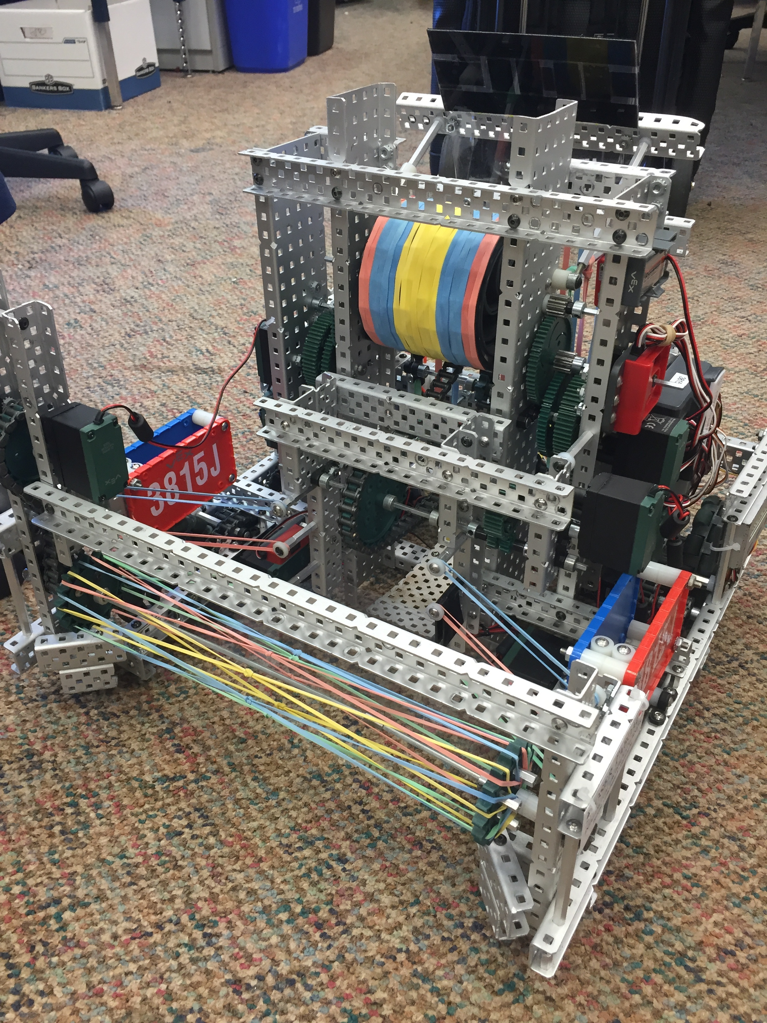

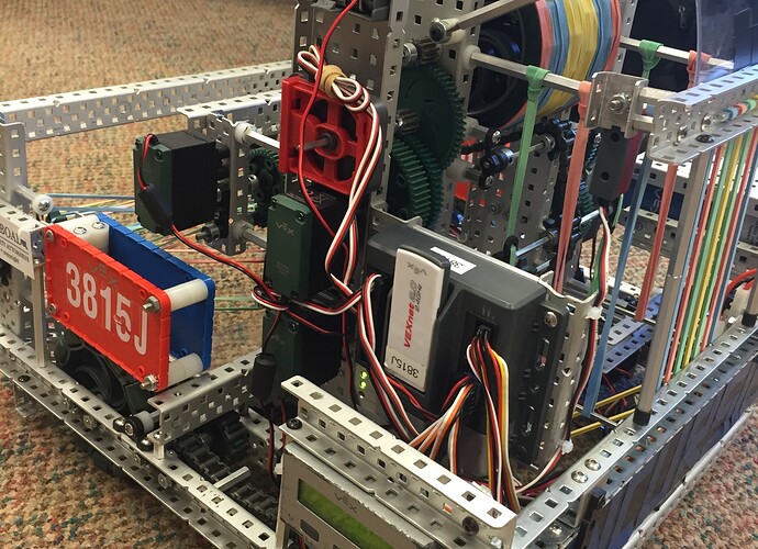

We’re proud to present our newest NBN robot competing in ENGINEERING division: INCURSIO
potential field robot
4 torque motors base
single flywheel geared to 25:1 (4 speed motors)
fast elastic conveyer belt
high speed elastic rubber intake
a very colorful robot that shoots at a rate of 4 bps
We didn’t have time to make a full reveal so I am just posting the attached pictures and will to answer questions.
Nice robot, why did you opt for the torque base? How much did your robot weigh?
I love the flywheel… Colours. Nice job. Do you have any specific auto? Can you shoot full court?
@Mystical Pie the reason we chose a torque base because our previous base got overheated a bunch of times. So what we did was to unified the 2 motors to power each side on the base. Also we geared the wheels 2:1 to make it fast.
@Mystical Pie the robot weighed around 15-18 lbs
So you base is geared up 2:1?
@TurboTech yes, we can shoot full field. And for auto, we shoot all the preloads at the start tiles and thats it. haha…
@Mystical Pie yes
