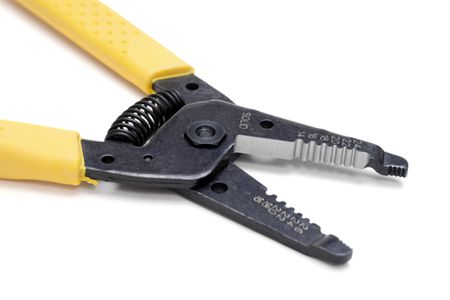

One thing that you will absolutely need for this job is a good wire cutter / insulation stripper tool designed to work with 20 and 22 gauge wires, similar to this one:
Since you may not have a lot of wire to work with it is absolutely critical that you could reliably strip the insulation without damaging copper wires. You may need to practice on some loose wires first.
You could buy such tool for under $10 online and it may cost you more at the local hardware store. If you go to a hardware store you may want to grab some small diameter heat-shrink tubing and electric tape, if you don’t have it already.

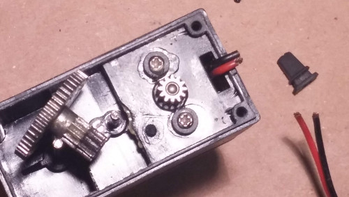

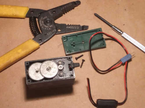

This is an old motor I pulled from a discarded components bin, which has wire cut very close to the housing.
As you can see there isn’t much wire left to work with. I also pulled the gears out and note how one of the gears is badly worn. It would need to be replaced with a new gear, which is sold inside motor refurb kit.

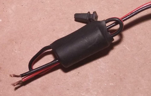

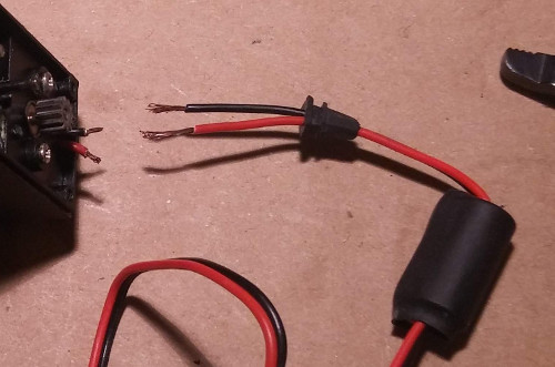

The next step is to push wires on both sides into ferrite core so that it easier for you to transfer more of the wire to the motor side.
After that I put rubber seal back on the wire and used wire stripper tool (20-22 slot) to strip insulation on all ends. It was very tricky to do it on the motor side where wire length is limited, but you could practice on some spare wires first. Notice that I stripped more wire on the other side.
In the next step I twisted wires together. First I used non cutting end of the tool to twist insulated spans, then twisted copper conductors by hand. You, obviously need to be very careful not to apply too much force because you could break the wires.
This will be a good time to test if the motor is working. Also, if you know how to solder, this would be the time to solder the wires.

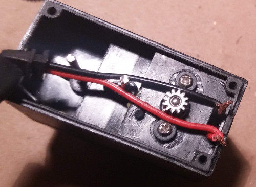

However, we are going to use string to secure the insulated portion of the wires. Make sure to do few loops, tie a knot, then few more loops, tie another knot … repeat 3-5 times.
The next step is to dab a little bit of super glue onto the insulated section of wires and the string. I prefer to use Gorilla brand for this type of plastics and the string, because Krazy brand tend to make plastics brittle. Avoid putting any glue onto the copper conductors. After that cut any excess string.
Test the motor again. If it works you could put little pieces of electric tape to cover conductors and turn the wires around (carefully).
You also need to wrap 15-20 loops of string around both wires and dab them with the glue to prevent wire from sliding out of the rubber sleeve.
After glue dries out and you tested the motor one more time, you are ready to replace the gears, and close the motor.
