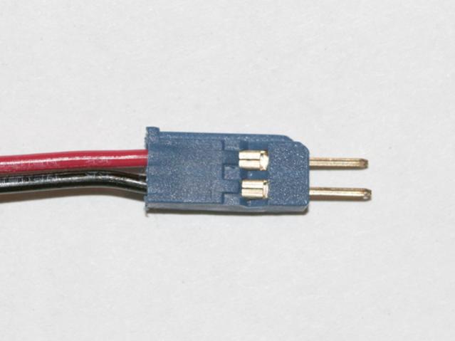

Sorry Blake. You are right about making assumptions. There is no documentation but we pulled out all our 393 motors from the past 3 years and compared the first reversed one that we found. We ran every motor we could find. All of those were like the one with the red tape that you had in your picture. Only the 6 new ones that had reversed polarity were like the motor with the yellow tape in your picture. Talked to Eli & they want to see those motors. Just wanted you to be aware that your motor was not the only fluke.

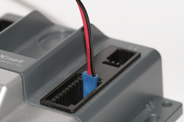

I checked several motors, they are all the same and I don’t ever remember seeing a different orientation, if I had I would probably have just fixed it. This is what I consider correct.
[ATTACH]7724[/ATTACH]
Which when plugged into the cortex as follows;
[ATTACH]7725[/ATTACH]
causes the motor to rotate in the same direction as motors connected to the three wire ports via MC29’s. Red wire to center of cortex, same for ports 1 and 10.
That is what we consider correct also.
