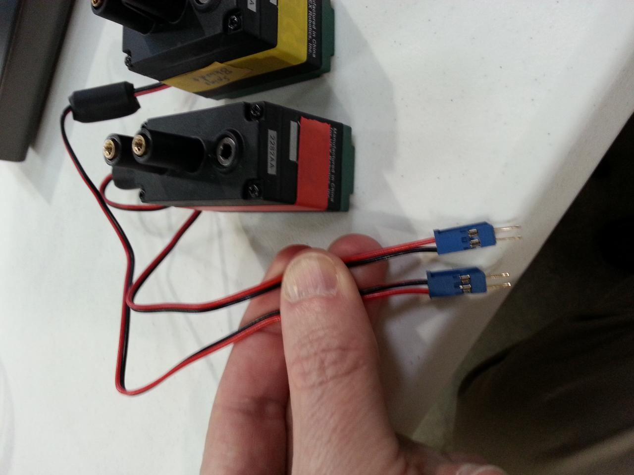

I have two 393 motors in front of me (see attached picture). They are different.
On one, its black wire is next to the keying tab on its 2-wire connector.
On the other, its red wire is next to the keying tab on its 2-wire connector.
When plugged into the same Motor 29 Controller (connected to a Cortex), using a red-to-red / black-to-black polarity, the motors spin in opposite directions.
If the connector keying is kept the same when each is plugged into that Motor Controller 29 (resulting in one red-to-red connection, and one red-to-black connection), the motors spin in the same direction.

The motor polarity should be consistent with both the wire color, and the keying on the connector. You’ve got some defective motors.
Our manufacturers functional test involves a visual inspection, plus plugging in the motor to a known power supply, and ensuring it turns the correct direction. So, if the person doing the visual inspection misses it, and both the key AND the motor connection are flipped, it would incorrectly pass.
This is the first instance of this I’ve seen reported. Hopefully it is just a fluke, and not a systemic issue. How many motors have you seen affected?

Based on how the majority of our motors are wired, I think that at their two-wire connector, the 393’s black wire should be on the same side of the connector as the keying tab. Is that correct?
Blake
Blake,
The correct version matches what James posted here:
https://vexforum.com/showpost.php?p=339408&postcount=5
The red wire should be closest to the connector key.
