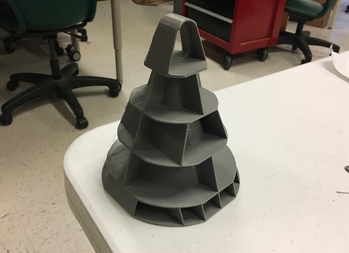

If anybody is interested in 3D printing a few of these to get ahead of the competition, I made a stl file.
Just ask if you need any help.
Thanks! You beat me to it… now to figure out the best orientation, wall thickness and infill. Hmmm…

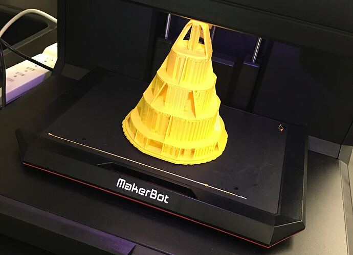

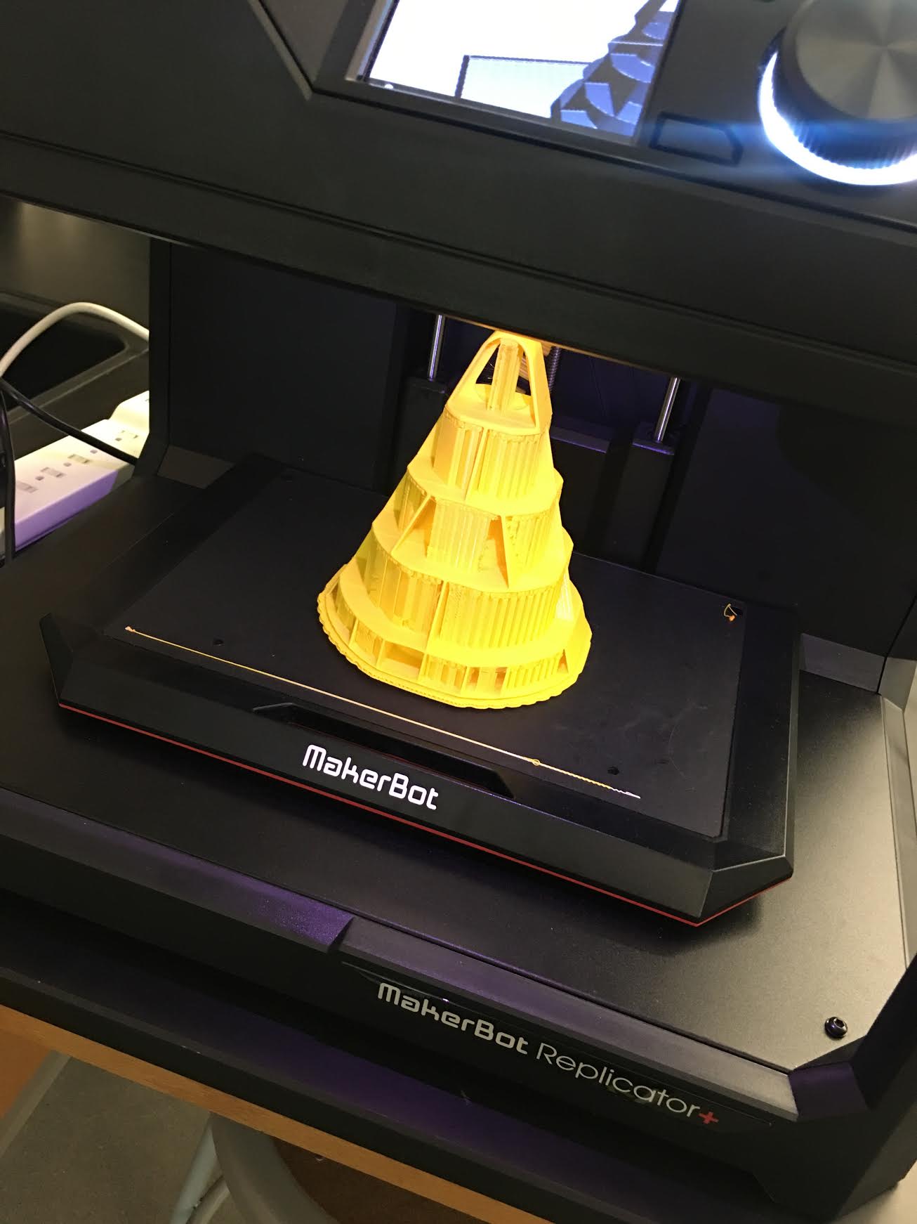

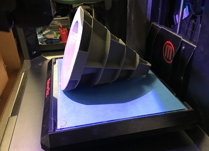

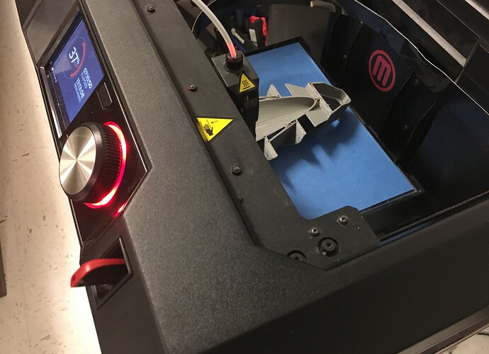

makerbot made me print at 95% scale :frowning:
I rotated the model 90 degrees to print with the base perpendicular to the bed, it seems to use less support, and it fits a makerbot build volume.
I thought about doing that but I felt like one side of the cone would turn out rougher than the other bc of the supports.

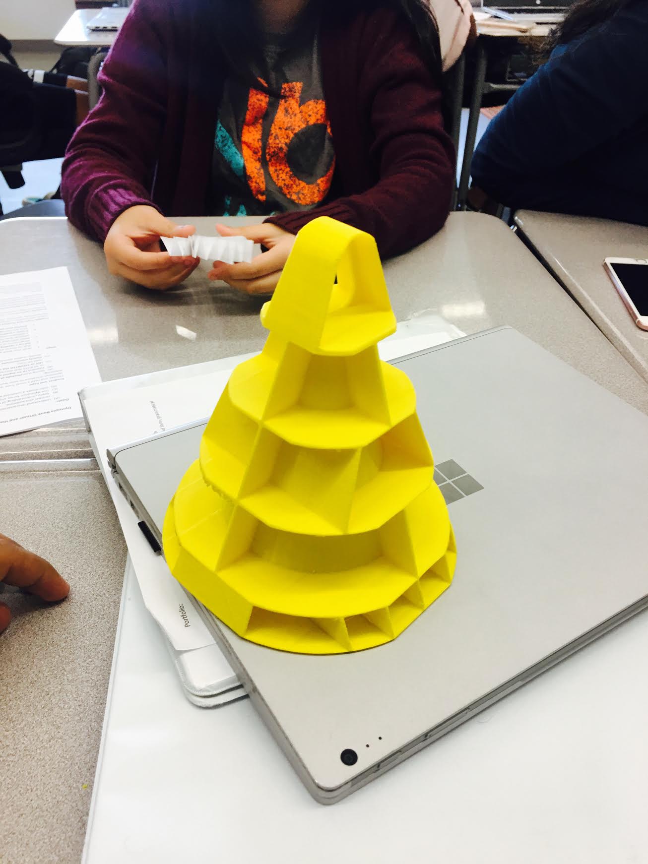

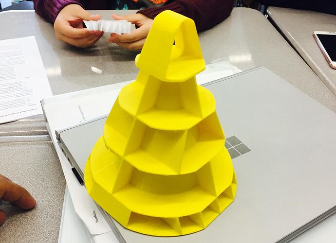

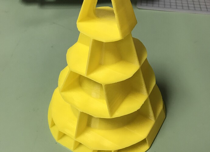

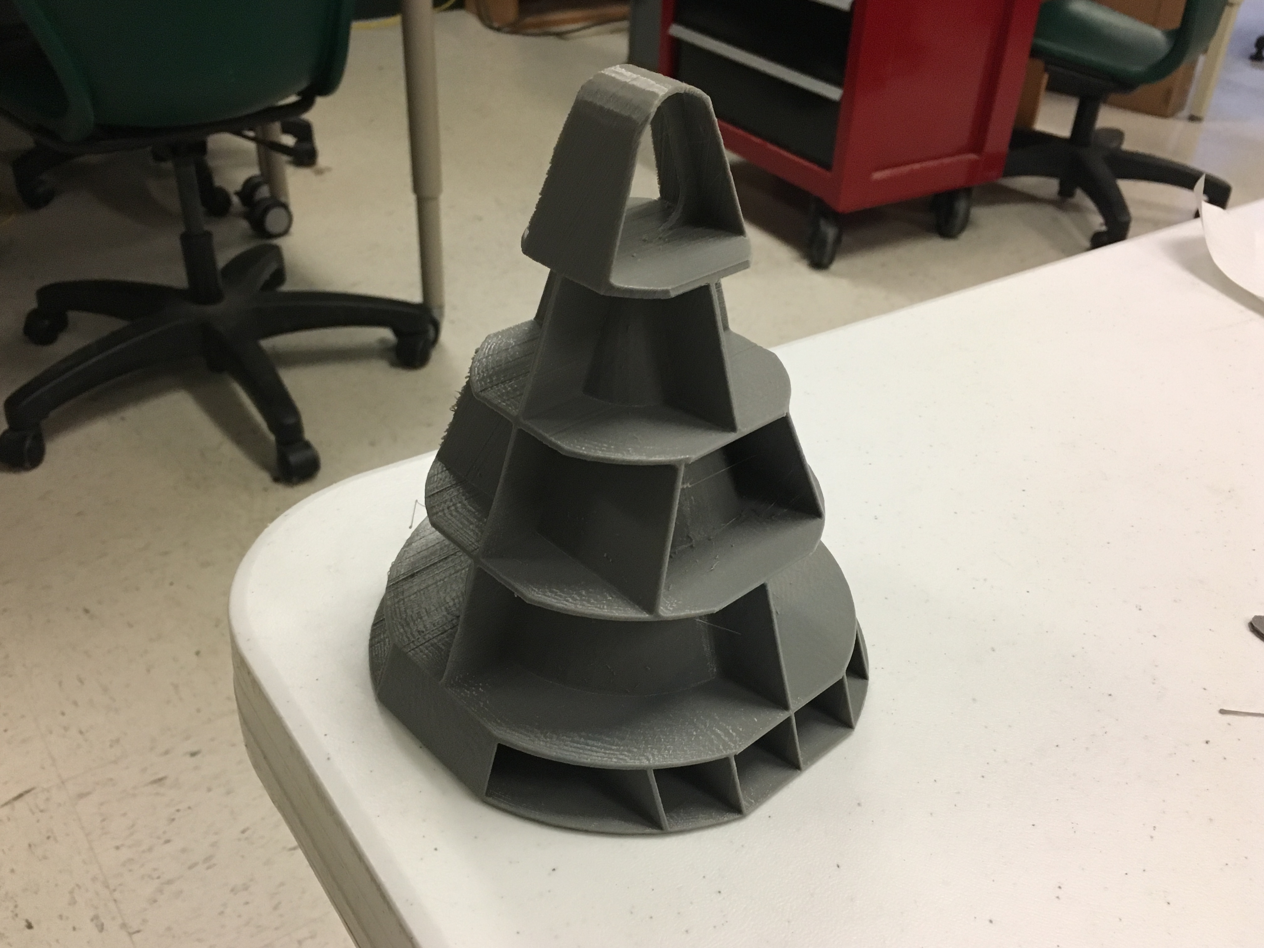

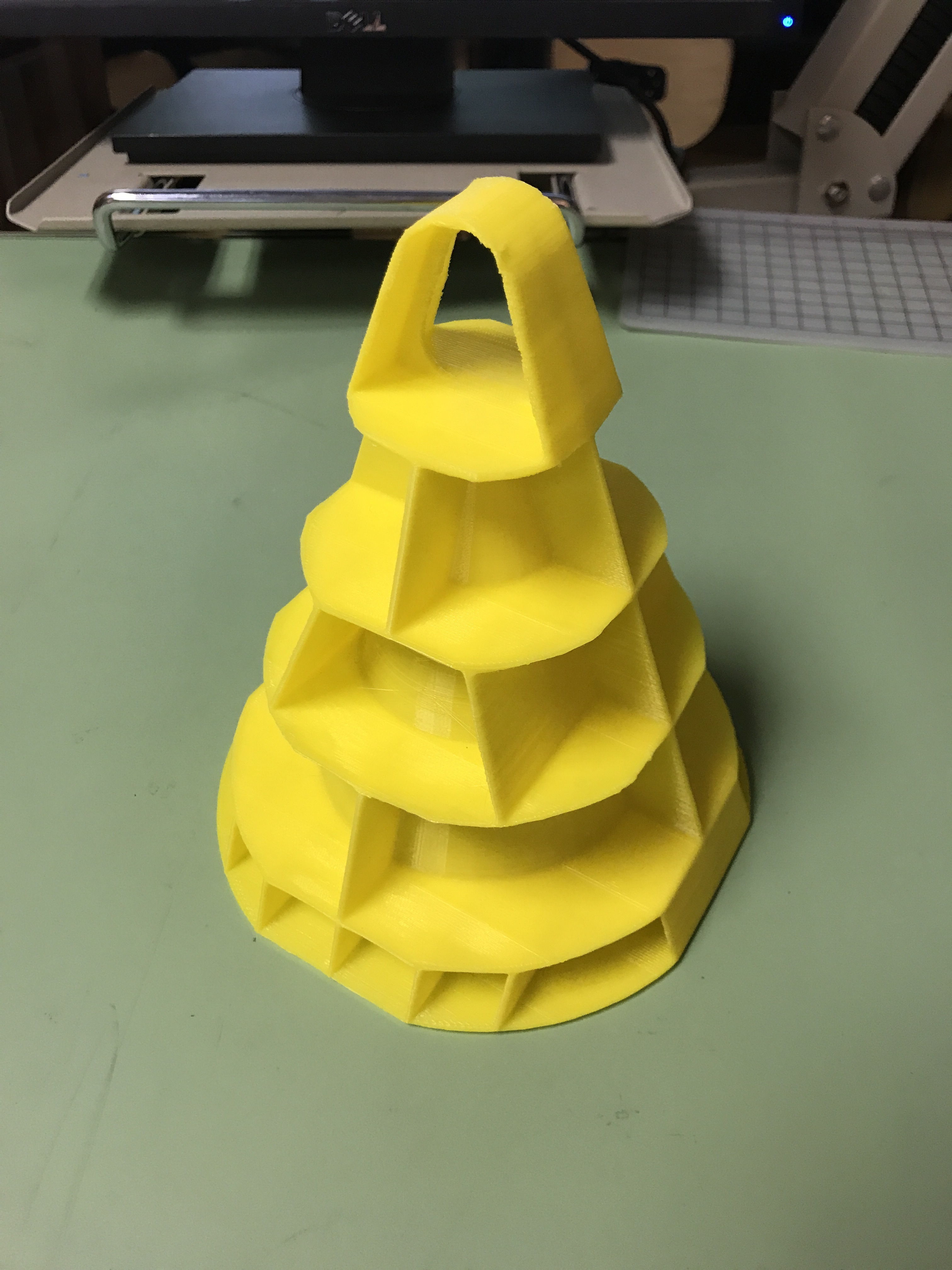

Regardless, after 16 hours and a quarter roll of PLA Yellow, it turned out great. So great, in fact, I think I may continue to use this even after I get my real ones, assuming weight and texture are not too different.
That looks great!
Same feeling over here… Looks Great!

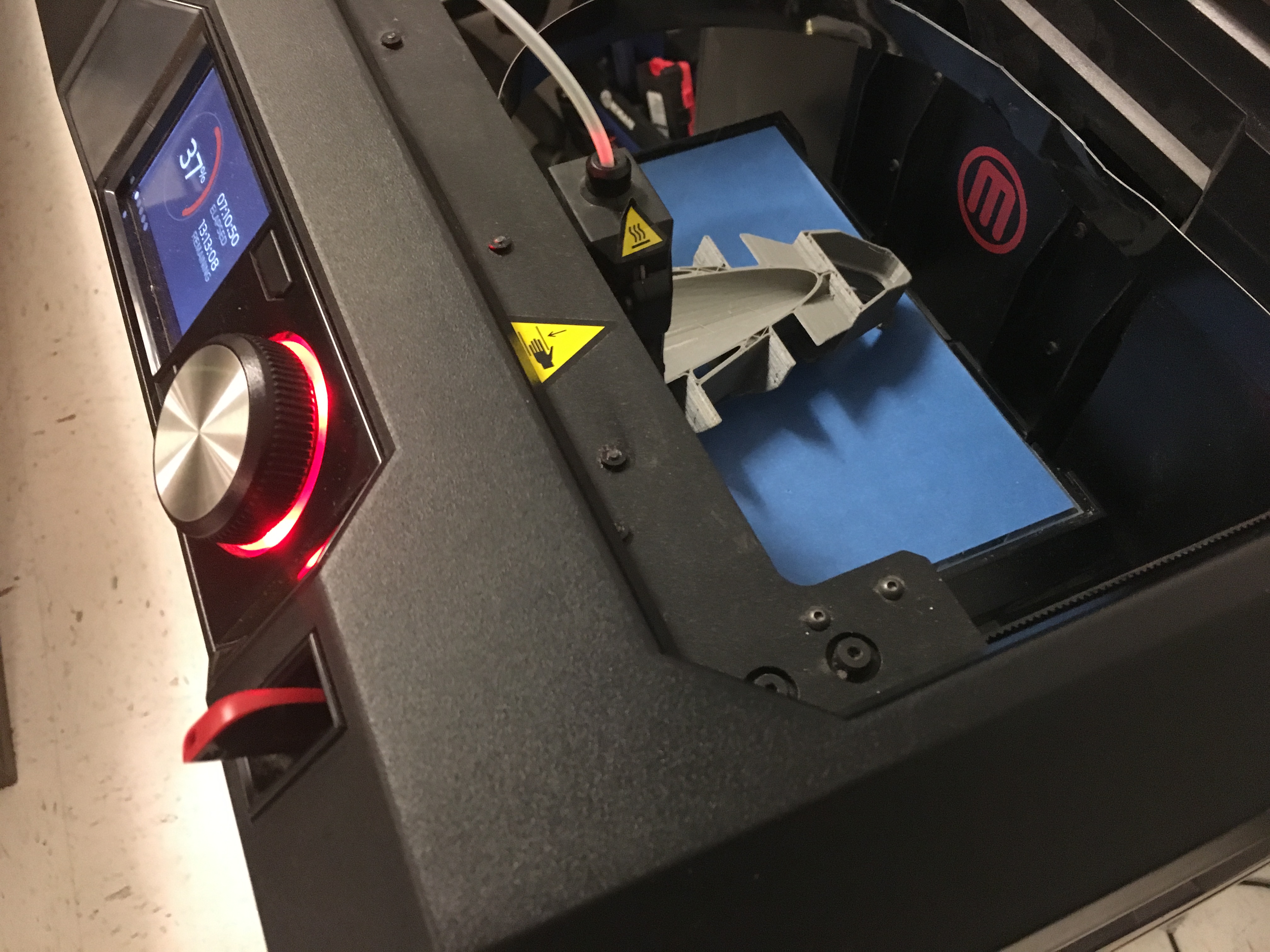

@phantom285A did you print that full size? When I put ours on the bed (5th gen), it was too tall. I printed mine on its side, no supports, 2 wall thickness, 10% infill.
