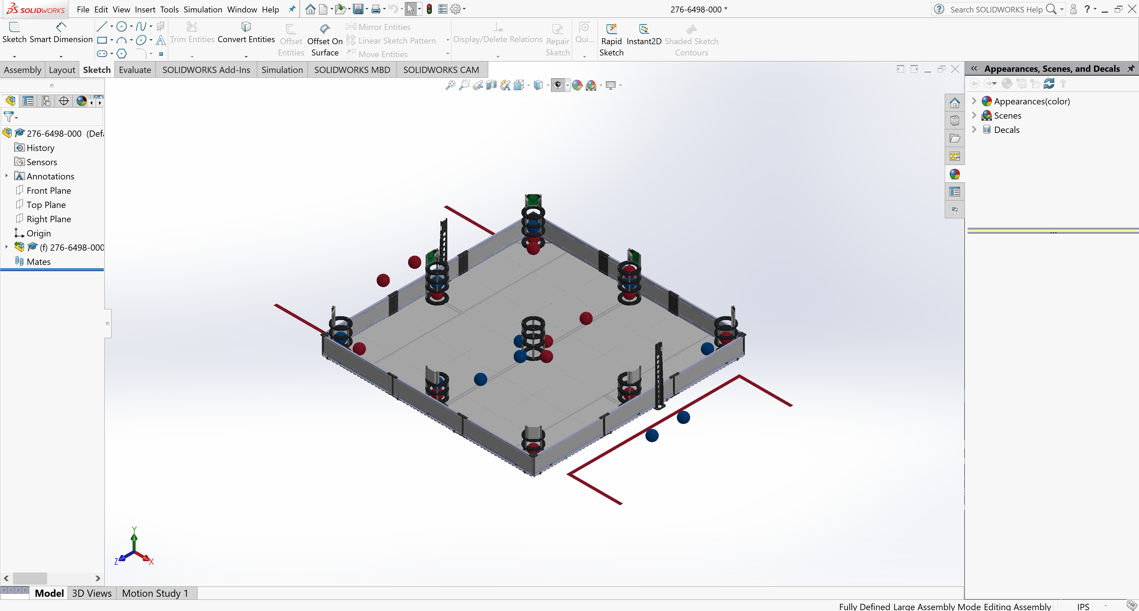

The best way to do this is to import or open the STEP file provided by VEX in a CAD software of your choice (I used SolidWorks). From there you can select the body (or bodies) of the object you would like to export and you can go to “save as”, change the file type to STL, and when the option comes up, select “only selected bodies” so you don’t save the entire field. If that doesn’t work, you can save the specific body (or bodies) as a part file for the specific CAD software you are using, and then open that part up and you can save as an STL from there. I hope that helps. Let me know if it isn’t working or you need help.

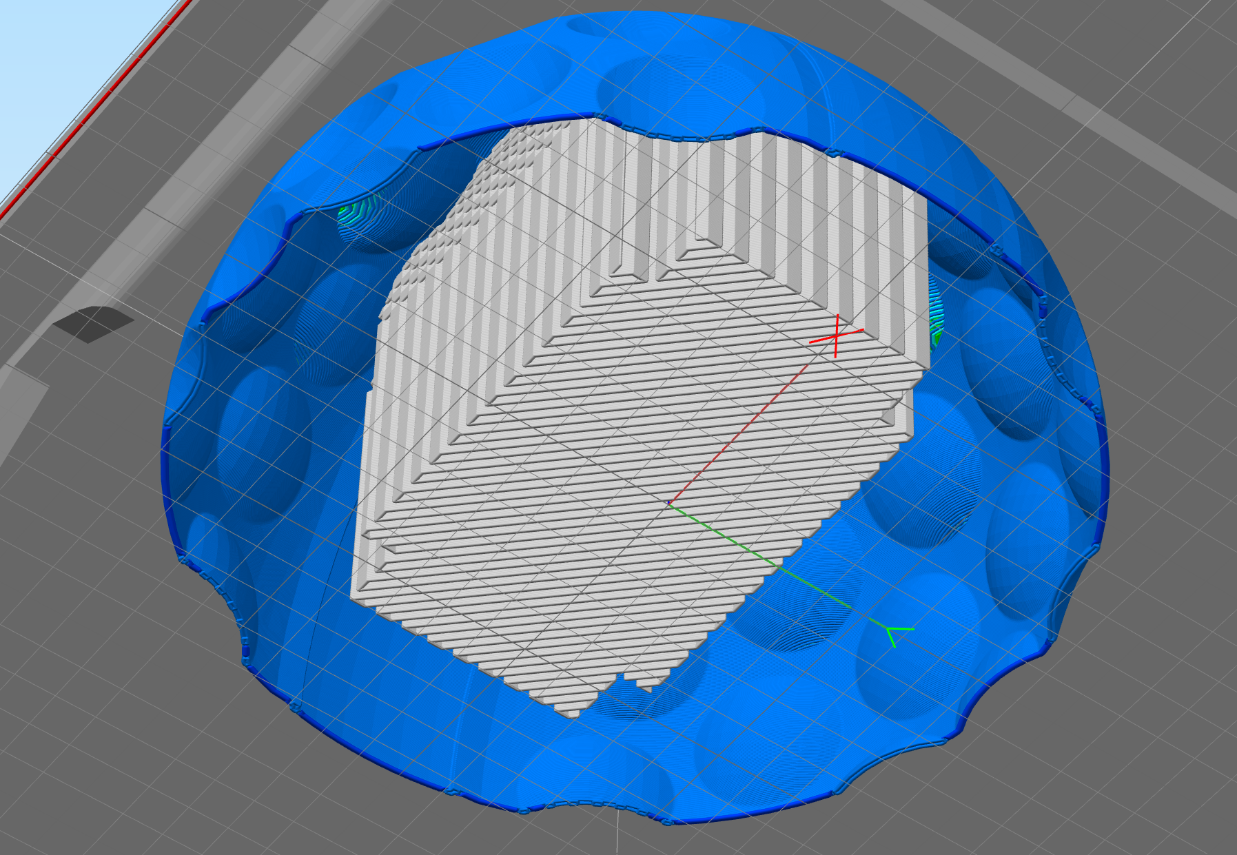

I would recommend supports for the center part of the half that has a large overhang. I have not printed this myself, and I have no plans to, so please let me know if you run into any issues or if you have suggestions for how to improve print quality and success rate.

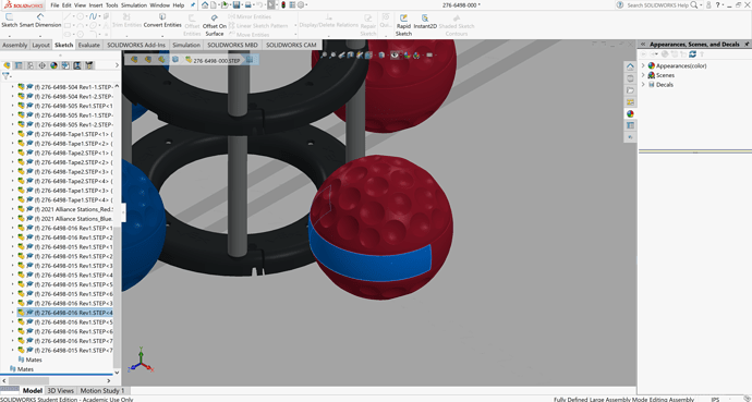

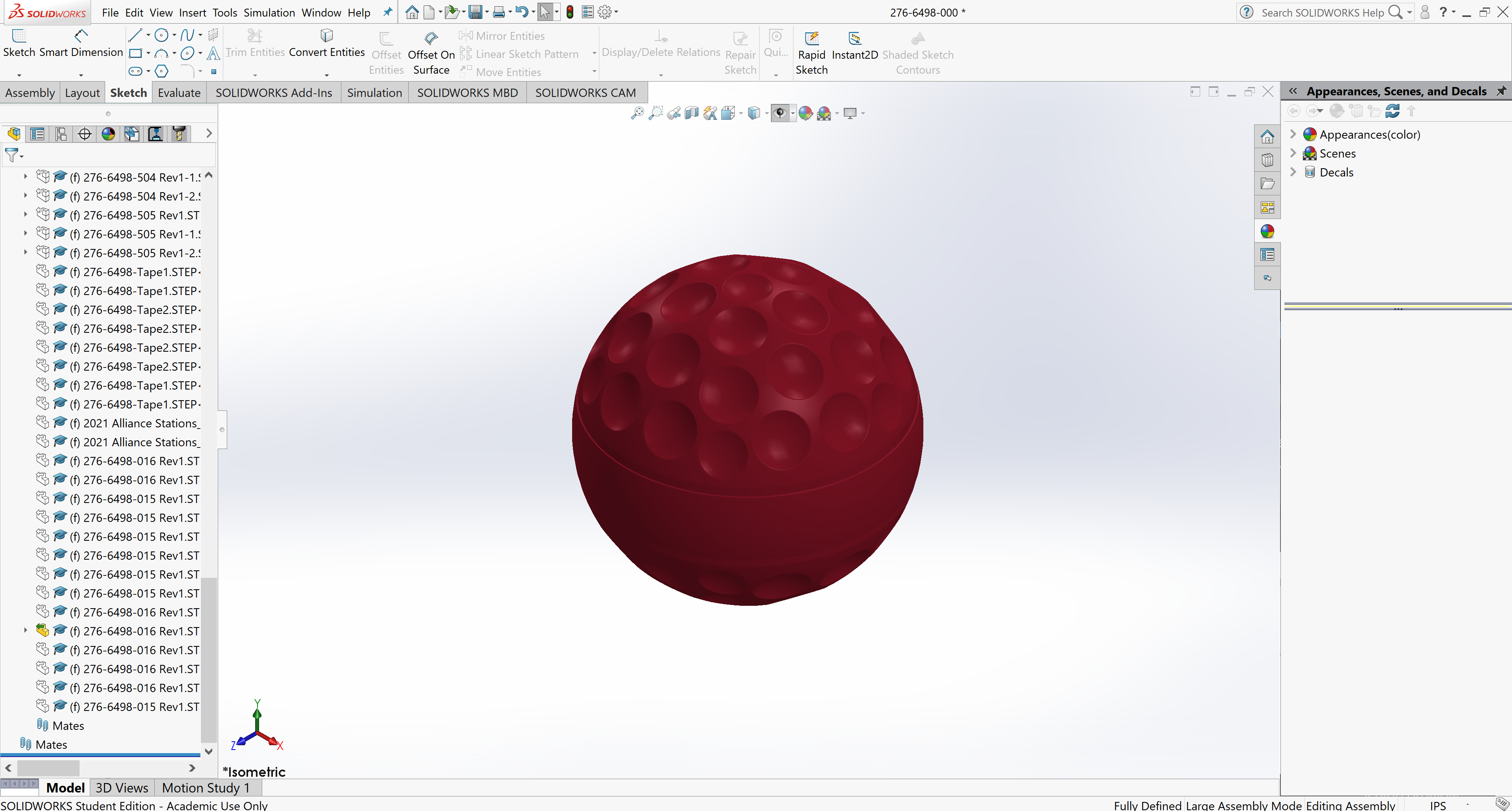

Here are detailed steps on how to export a specific part from the Field CAD files (this has to be done in CAD, not a slicer software). It is pretty straightforward and can be done in a few minutes if you know what you are doing. These steps really only apply to SolidWorks, but it is possible to do the same thing in other CAD Softwares, the steps might be slightly different, but the overall idea is the same. These steps cover one object to be printed, but if you want to print an assembly of parts (not individually) you would do the same thing here, but instead of hiding all parts, you would keep the ones you want to be printed together visible. I hope this is helpful. Let me know if you need further clarification.
STEP File Opened

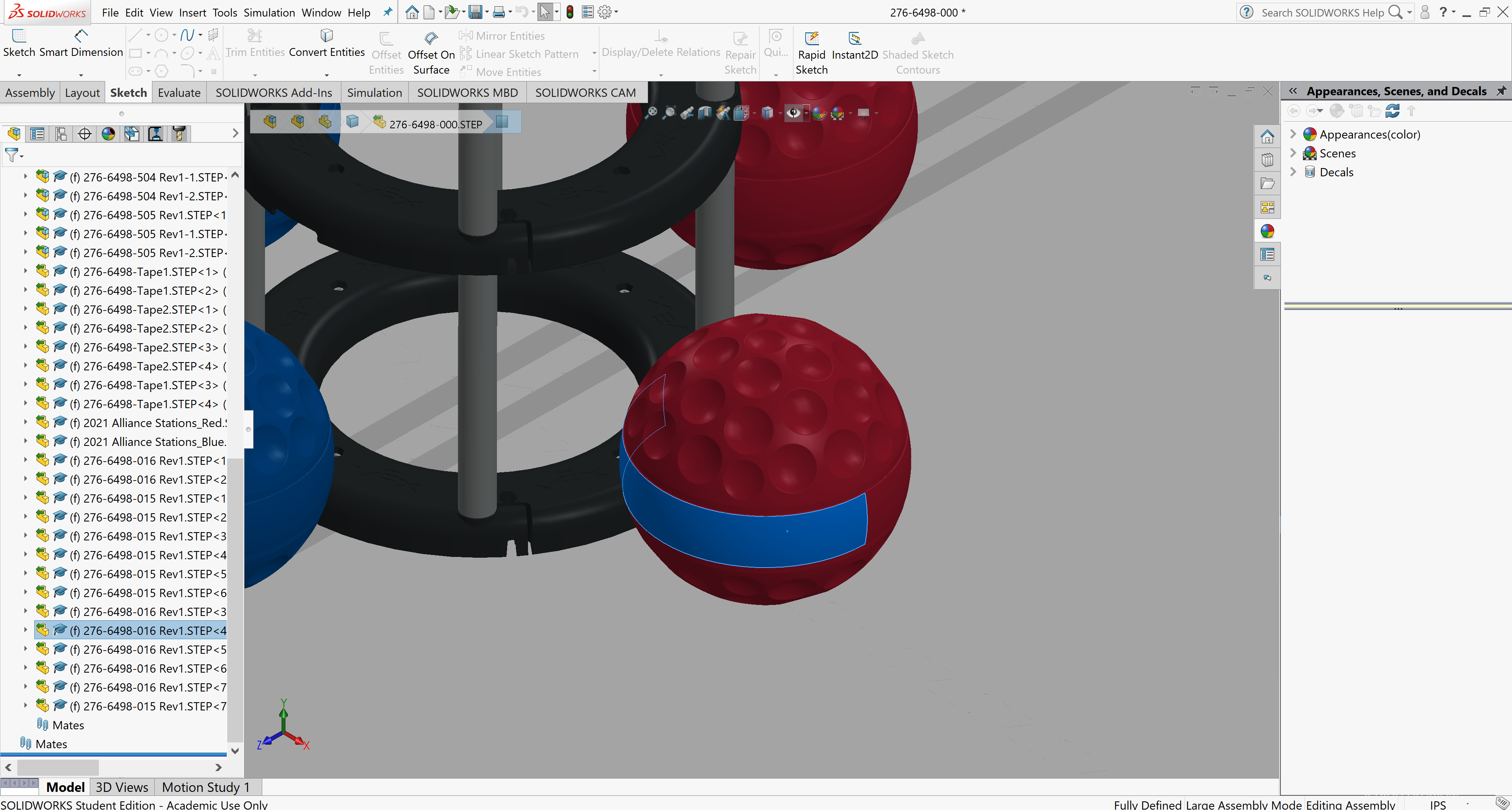

Clicked on the object that I am interested in exporting (notice that it highlighted a part on the left menu)

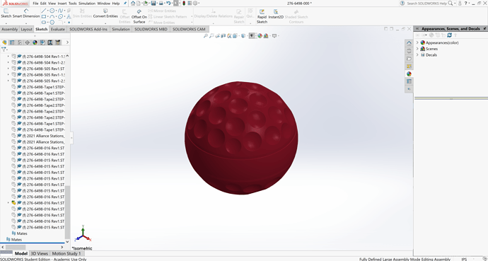

Now select all other parts in the drop-down that are not highlighted and hide them (right-click, hide elements) so that the only object you want to export is visible. This can be done in bulk so you don’t have to do it one by one. This step seems silly, but it is important if you don’t want SW to accidentally export everything. Now you can see that all that remains is the ball.

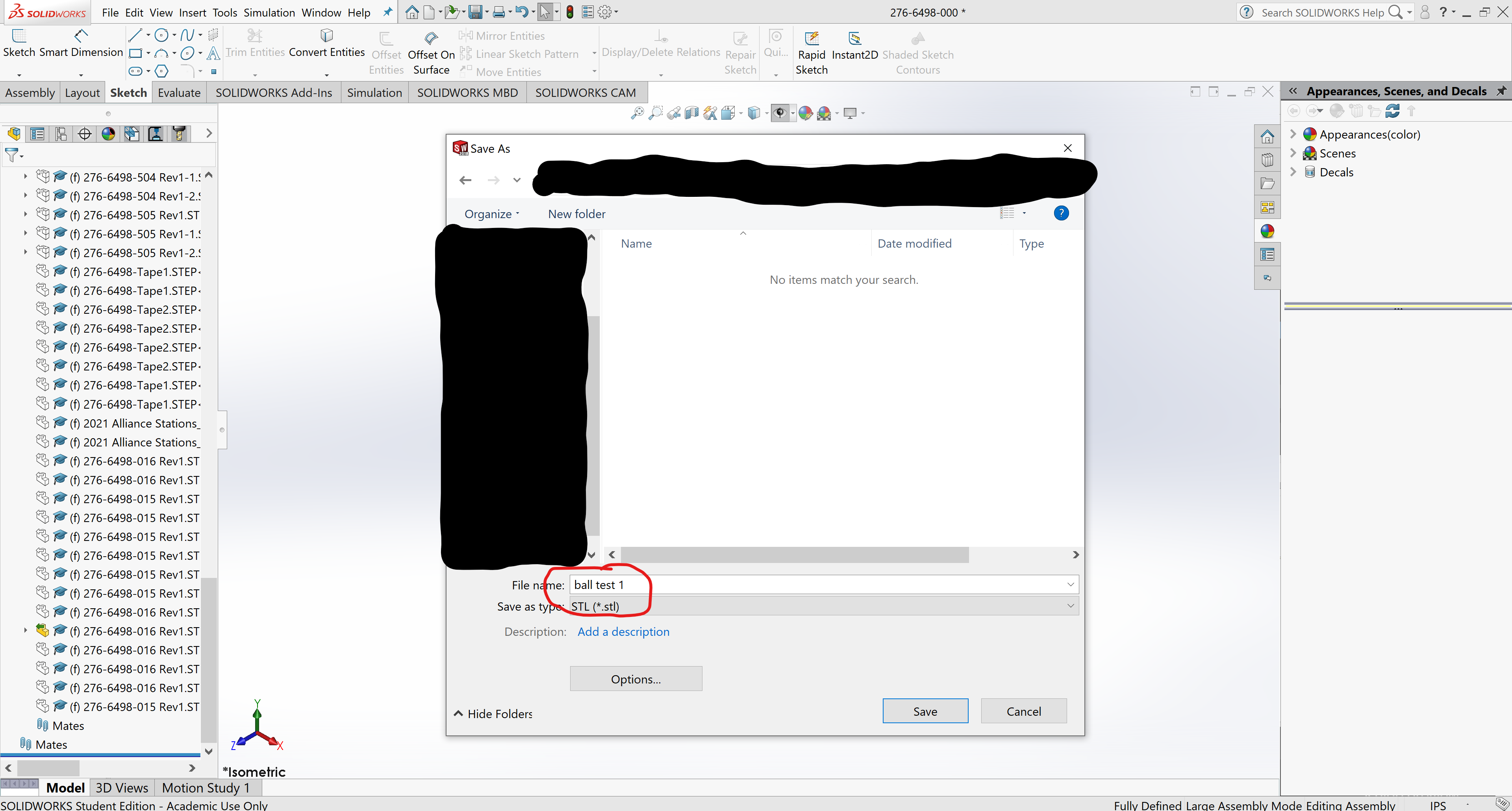

Save As STL file type (if a pop up appears after, select yes)
Import the STL file into your slicing software to 3D print

I’m printing the second half of mine right now using the original files from the top of the thread and it seems to be working well. Although I would recommend a good amount of infill (15-30%) because I had a spot where it split a little. I used 0 infill to save time

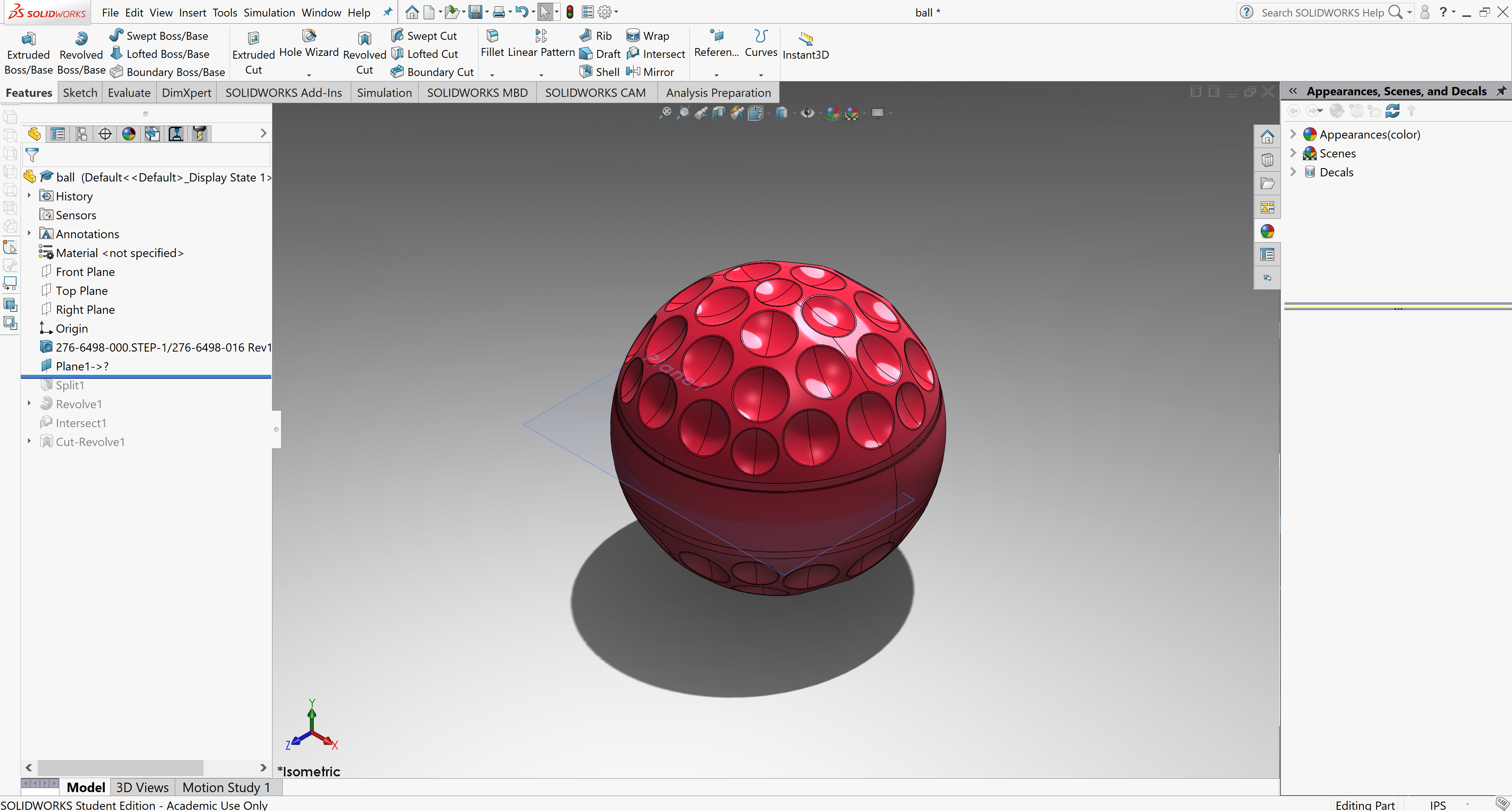

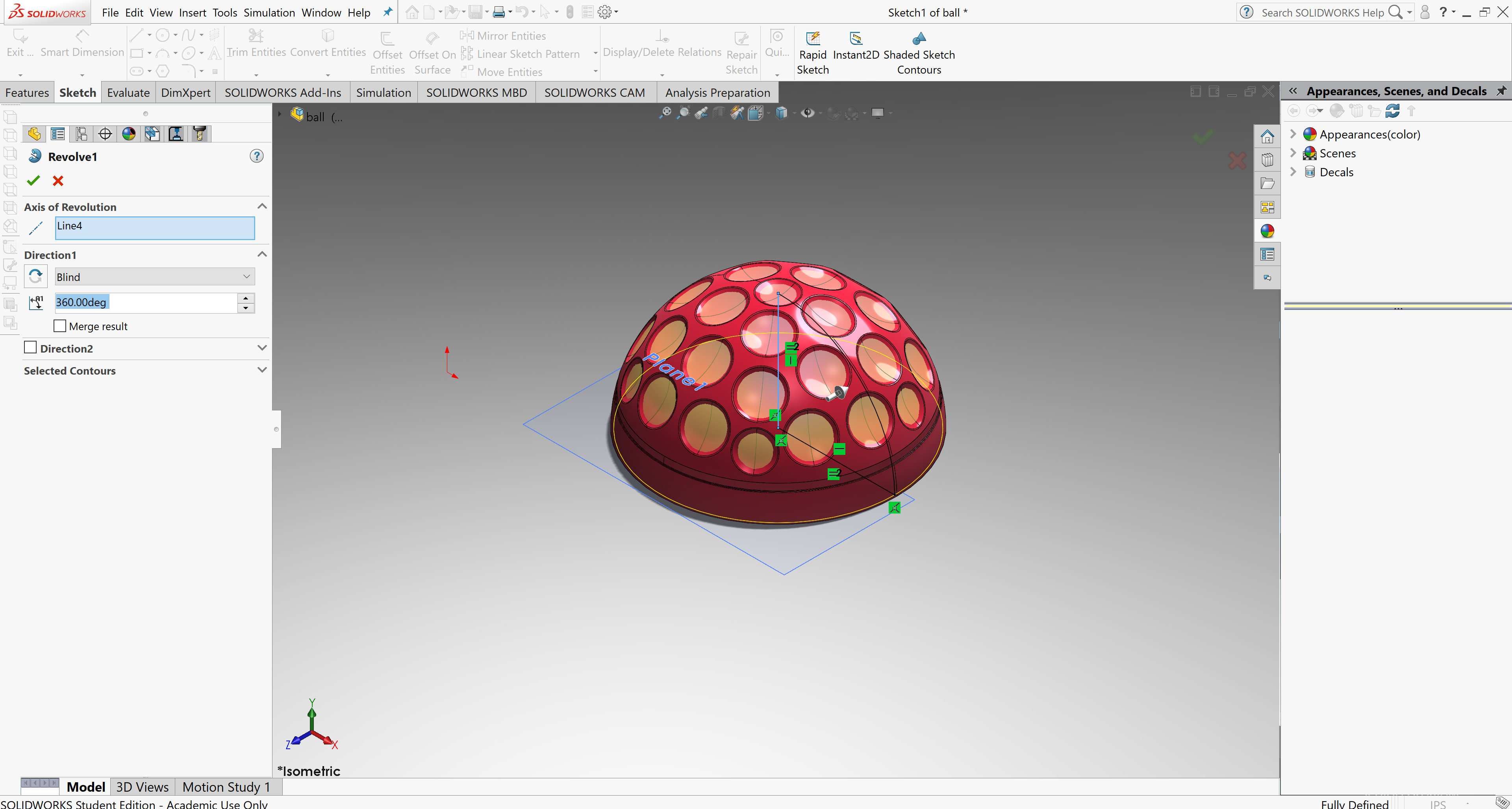

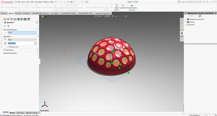

Also, if anyone is curious about how I made the half ball solid, these were the steps that I did to make that happen, so that you can do it too in the future. I hope this helps and was informative.

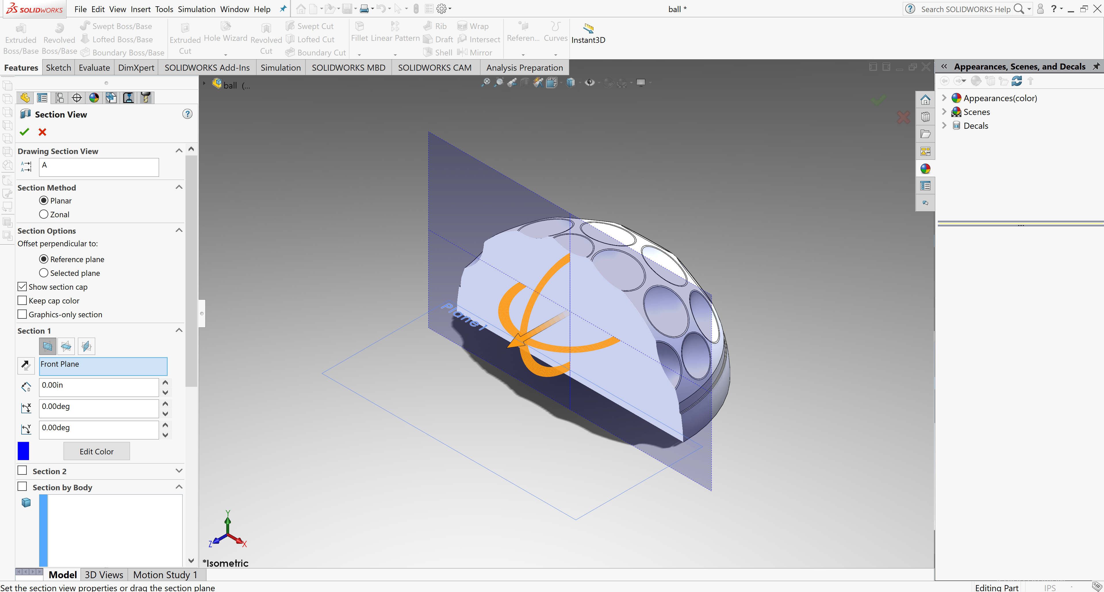

Using the steps above, export the object as a part file
Create a plane at the halfway point of the ball if there isn’t already an intersecting plane

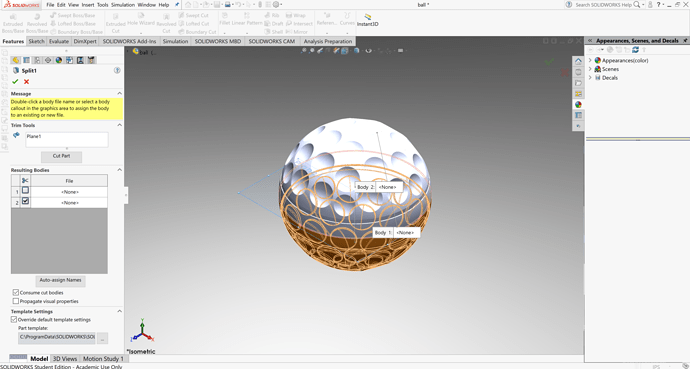

Insert the Split feature that will use the plane to cut the two parts in half (select consume cut bodies)
Next create a revolved extrude sketch to fill in the interior of the ball

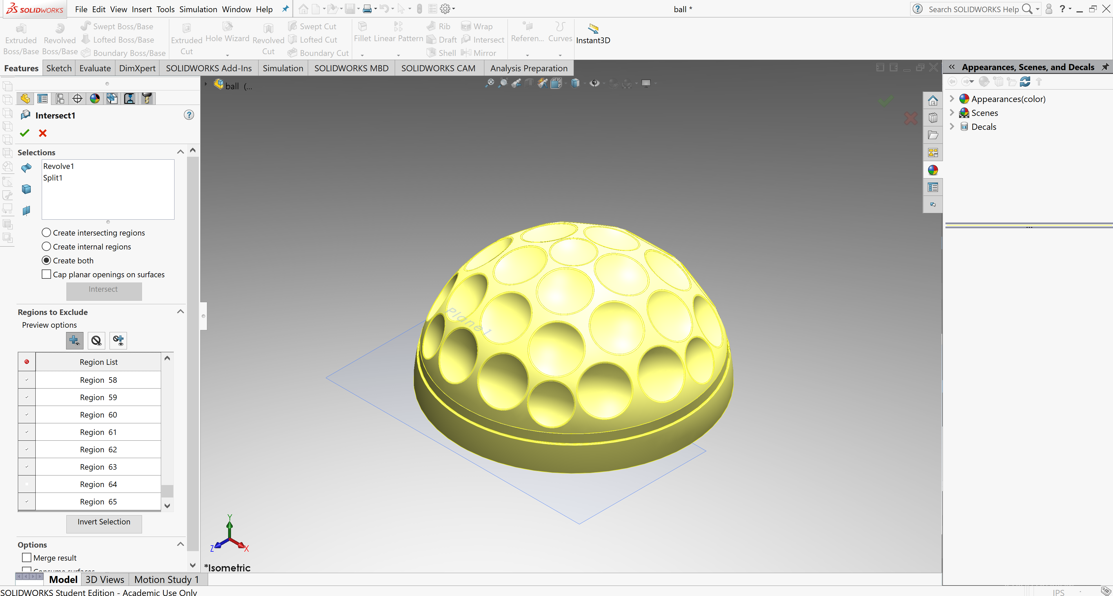

Next, we will utilize the Intersect feature to remove the unwanted pieces. Select all parts to be excluded except the interior part. This may take some time to figure out which parts you want excluded to get the shape you want by trial and error.
Now you can see in this section view that I have a solid object that conforms to the original shape of the hollow ball.

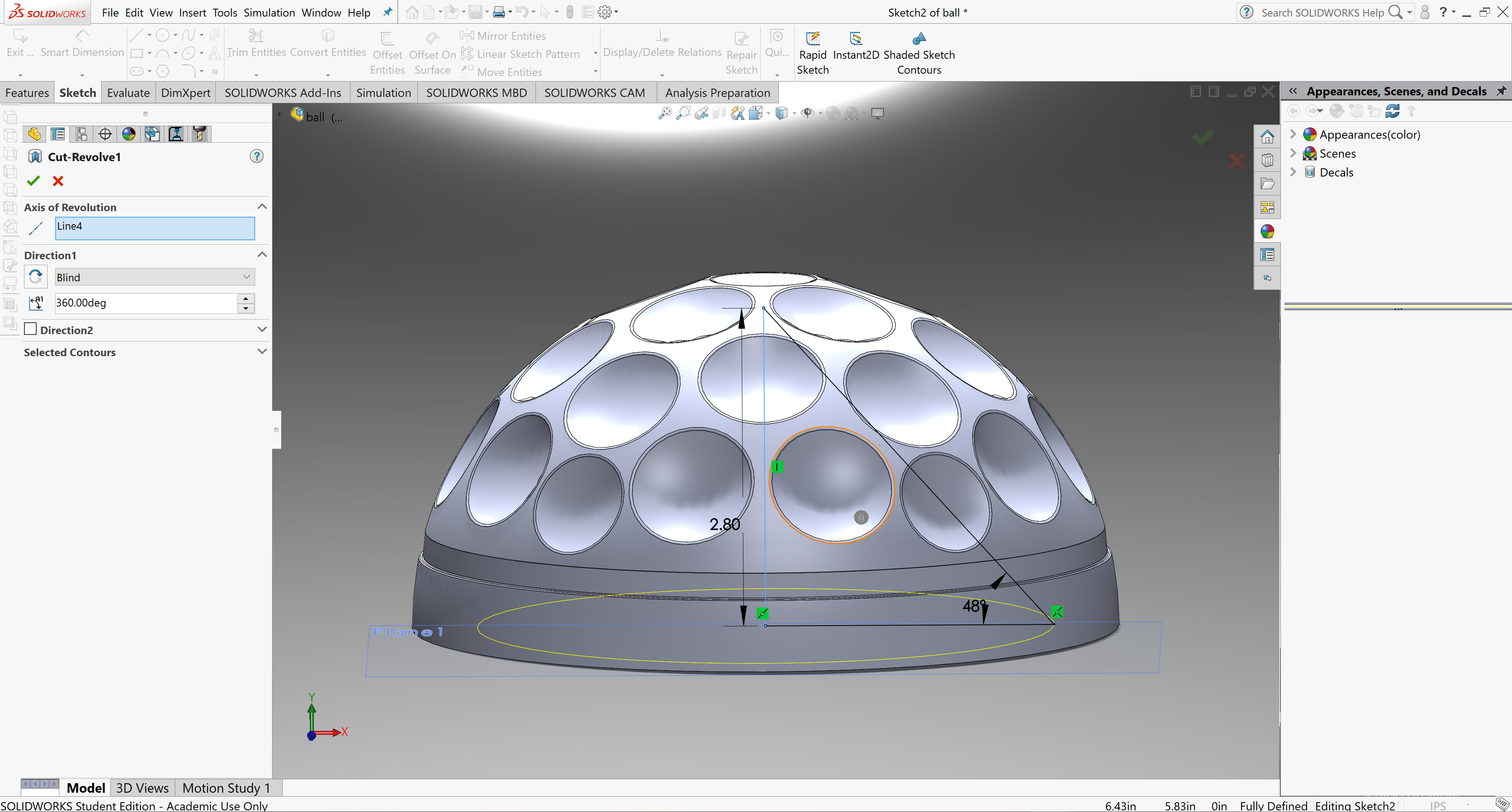

An extra step you can take is to create a sketch that will make a revolved cut extrude to remove a portion of the interior as to cut down on print material when 3D printing.
What layer height, material, and print temperature are you using? It is possible that your layer height is too large compared to your nozzle diameter. For instance, if you have a 0.4mm nozzle, avoid going larger than 0.3mm. Another reason for splitting is that the print temperature is too low. Infill shouldn’t have a huge effect on layer splitting, but it may help.

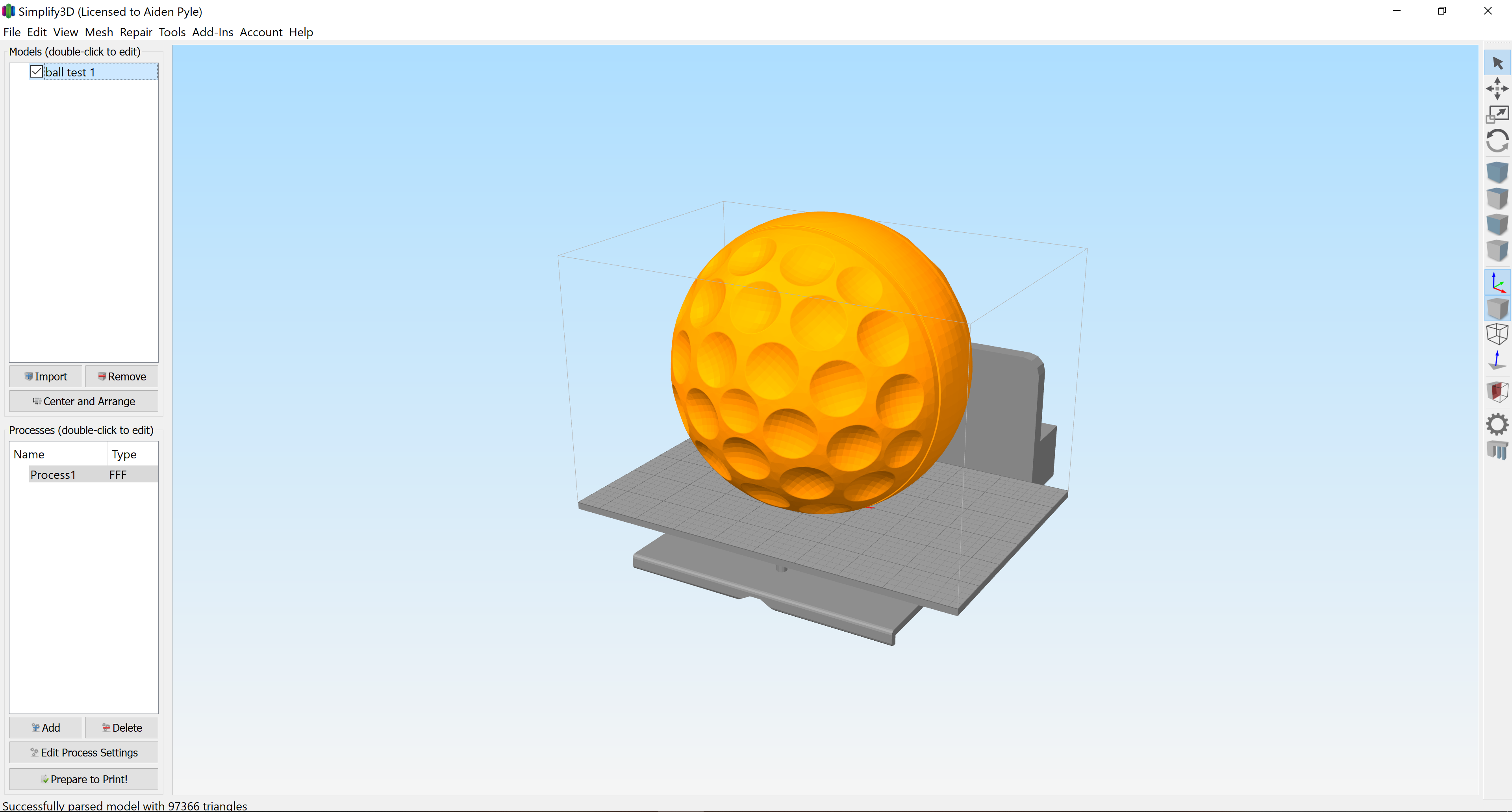

Here are my print results with unsupported prints of two different models - all good.
