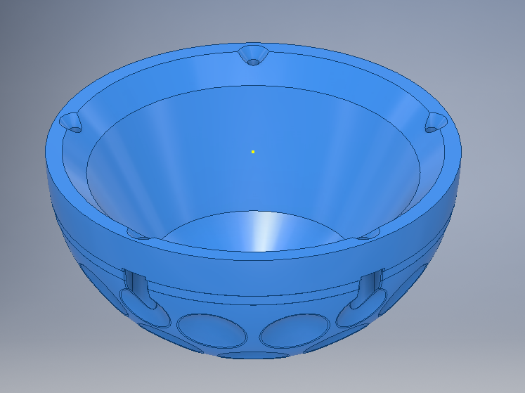

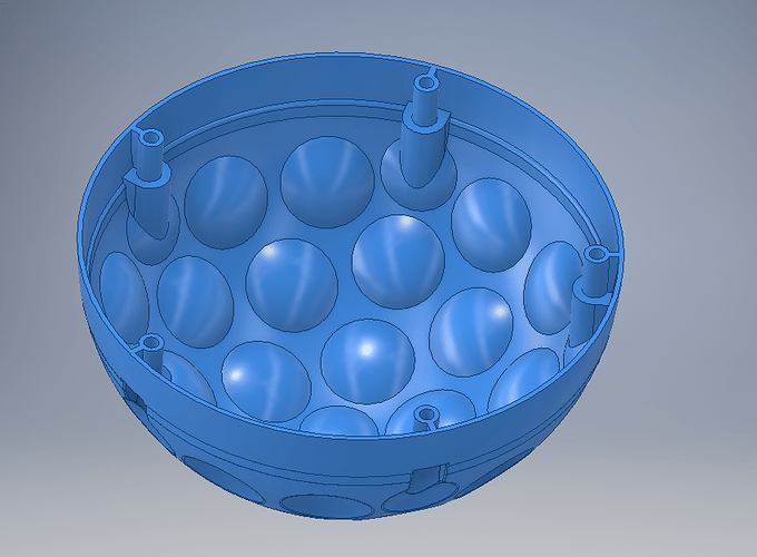

I have created models of the Changeup Balls that are optimized for 3d printing.
The main use for these models is for prototyping while teams are waiting for the official game objects.
“Ball_Simplified” is optimized for rapid 3d printing and can be printed without support. By tweaking the settings it can be printed under 6 hours (depending on the printer).
“Ball_Accurate” can be used to assemble a ball of same weight as the actual competition ball, but will require supports and a much longer printing time (at least double) . Nylon screws and nuts must be used in order to get the weight to be accurate.
Both these models are 1/2 of the complete ball. Two of these halves need to be printed and then require five 1.5" screws and 5 nuts to hold the two halves together.

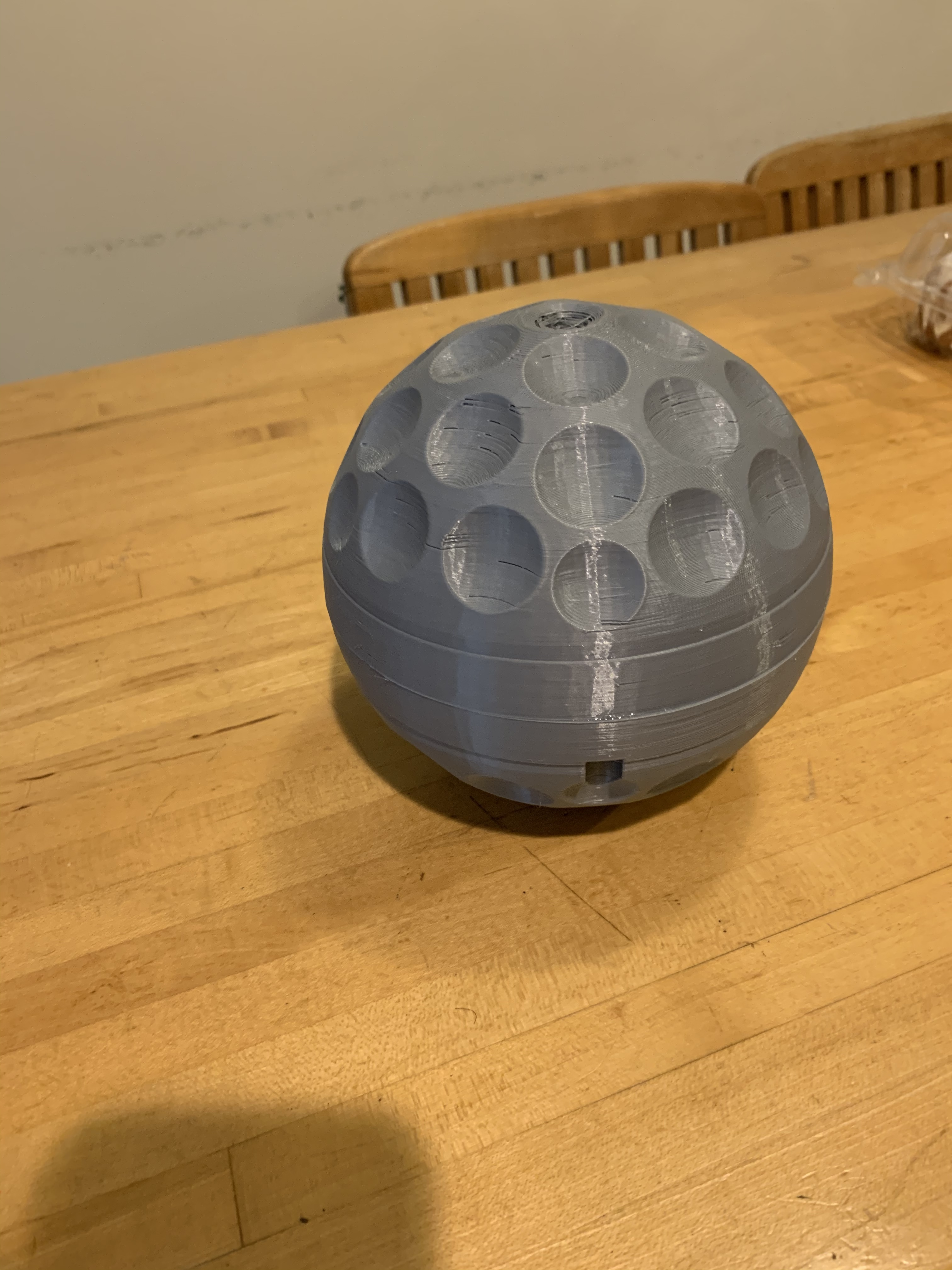

we printed this and it is great
I printed two types of models with no supports - both suffer that top indent is trying to print in middle of air - not ideal, but prints something :slight_smile:
One requires gluing together and the other requires screwing together…
I glued both models together.
I think it is adequate for prototyping - mass is around the right amount for game object. Wall thickness? well pretty solid for prototyping while waiting for real objects to arrive.
Each half print requires 4-5 hours to print - so 8-9 hours to have finished product… Worth it? nope not for more than one test object - better things to print time wise.
Printer used Bare3D.us printer - rock solid design and keeps printing - designed by 44/QCC2 Leland Crowther - great engineering.

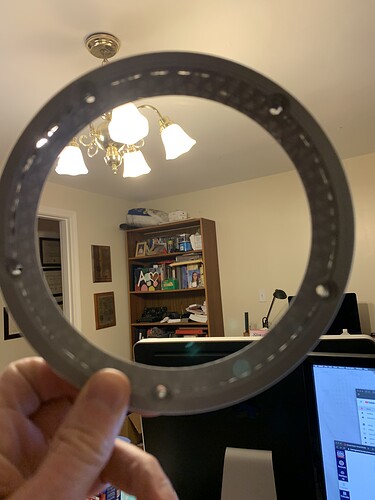

I know we have dimensions, but I would honestly love if you showed a picture of the ball in your hand.
I present Death Star:
Also, I have a large hand - not extra-large :slight_smile:
It looks you printed the “ball_accurate” file, this one requires support for the exact same reason you discovered. I was surprised though that it could print the rest of the ball fine without support, I was expecting several other spots to need support.
The second file “ball_simplified” should be able to be printed fine without supports, but the weight wont match the actual ball

No I printed Ball Blue simplified - based on file name presented on the downloads
Now if there is a naming problem in the file names - I can print the other labeled “accurate”
But I think I got it right.

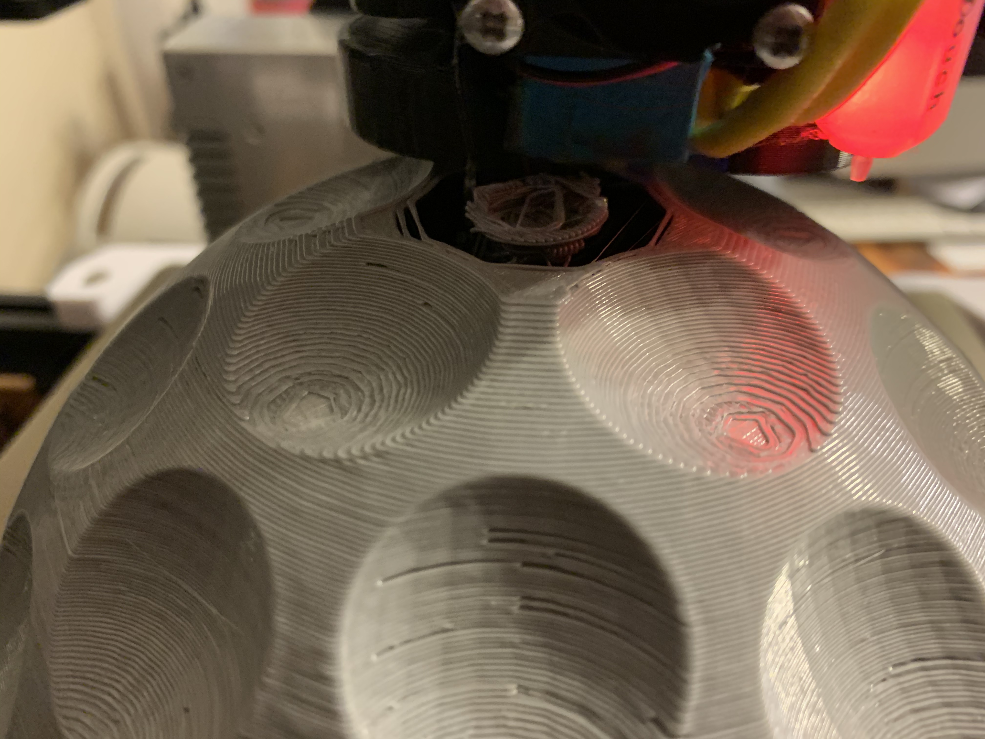

The accurate file is the one with large mass and an 8+ hour print time - will start run and compare with other two models printed.
I stopped the print because there was no advantage from printing second file - took twice as long to print and twice the material for no functional gain.
Here is photo showing how the file did not solve the problem of no support material:
despite blurry photo, you can see how layers are not fused correctly in the inner support layer. So no gain.
My advice if you need object, go quick with fast print, no support and decide if you need to super glue two halves together or fasten with screws. End of the day, you will have a game object to implement your mechanisms… Better to order real objects. Right mass, right rigidity …
The files were not named properly, I reuploaded them with the proper names. Thanks for catching that!
The simplified version should 100% be able to be printed without support. Most 3d printers should easily be able to handle slopes of 45 degrees without any issue.

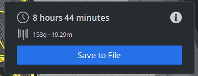

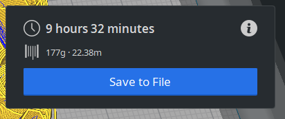

The simplified version with no support when compared with the accurate version with support prints faster, I confirmed this by comparing the prints after slicing in cura.
Here’s a screenshot of the two:
ball_simp
Ball_Simplified
ball_accu
Ball_Accurate
This is using the default settings for “fast print” with the only difference being the “generate support” for Ball_accurate being ticked. With optimization these times could be reduced.
