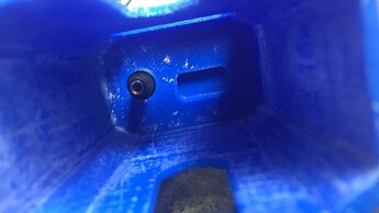

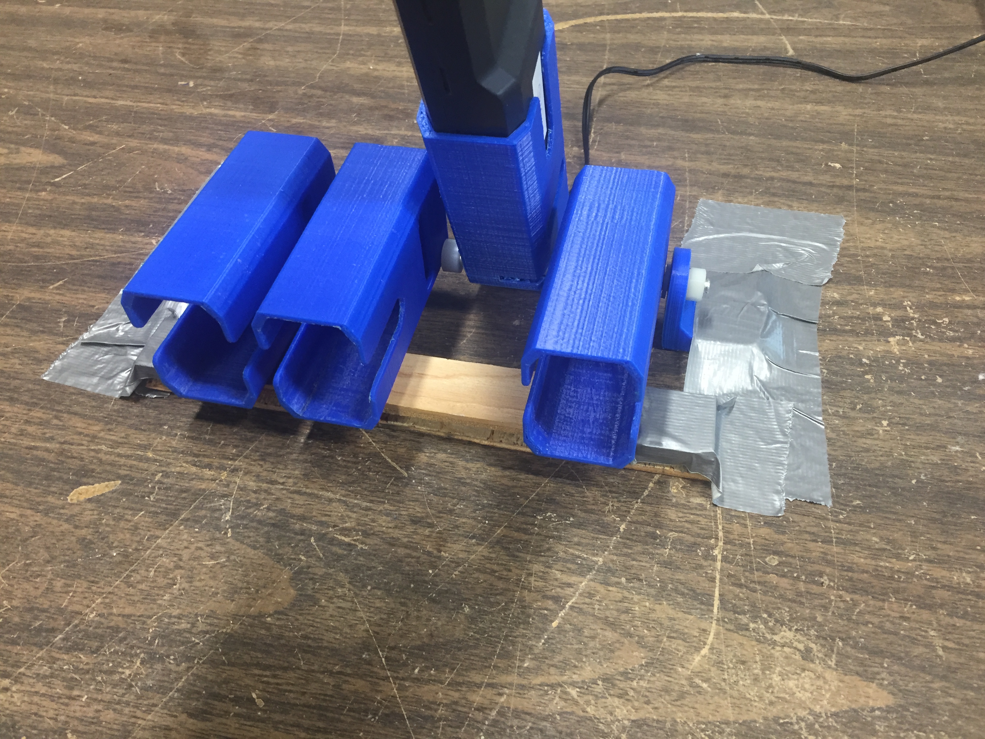

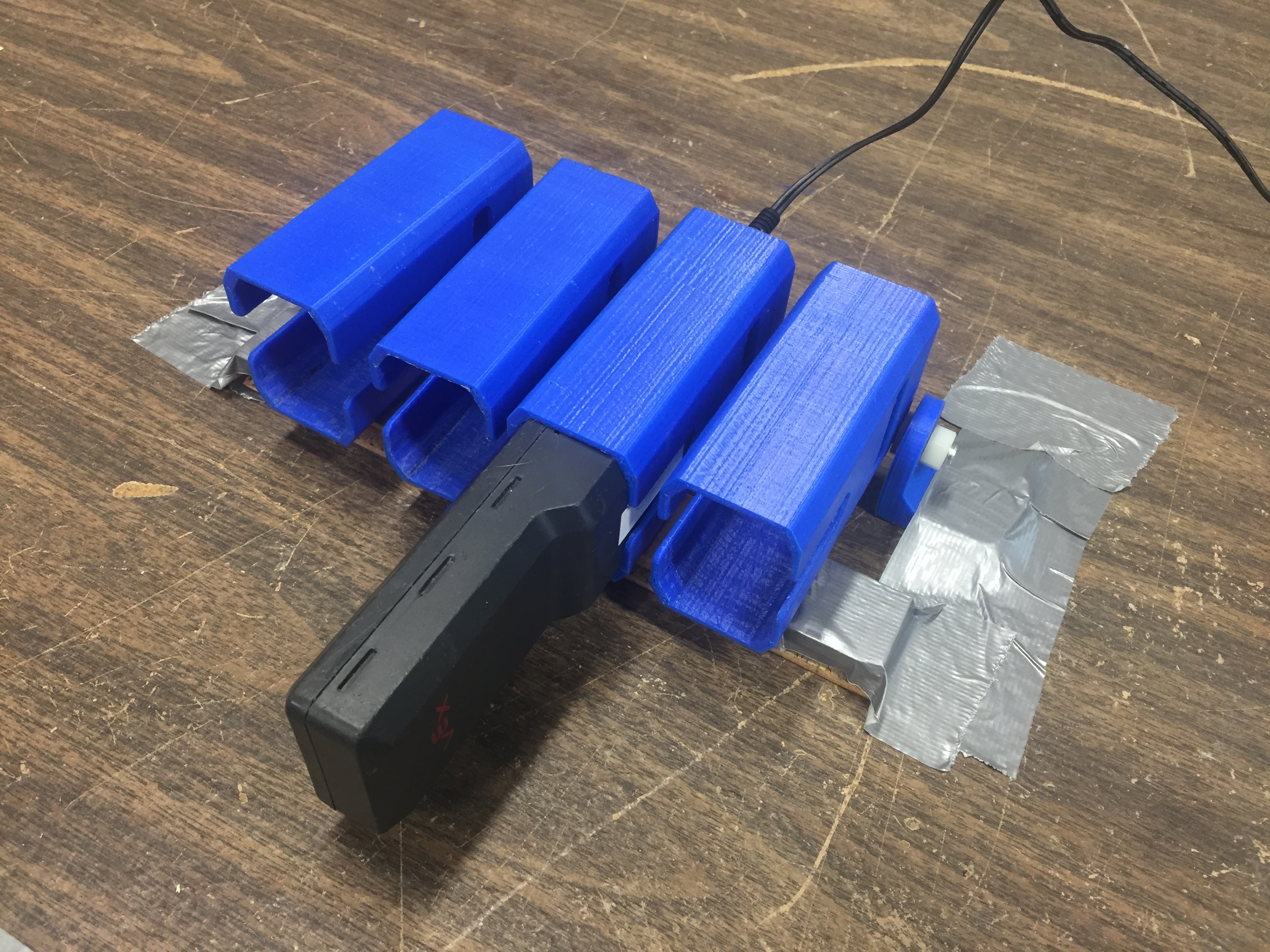

I was trying to come up with a compact way to charge our V5 batteries in a suitcase, and came up with what I think is a pretty nice solution and wanted to share it with you all.
Essentially it is a sleeve that fits over the V5 Battery, and has a hole where the V5 Charger port is hot-glued into. When you slide the battery into the sleeve, it charges. I intended for this to be modular, so I added a hole at the bottom. This allows you to mount multiple of these to a rod, and each individual unit can hinge up, allowing for easy acces. All, again, to fit nicely in a suitcase.
It fits a little snug on my printer, so you may need to scale it up by a percent or so on yours.
Here is the link to the STL files:
Here are some images of the print:
IMG_9687 IMG_9688 IMG_9686
V5_Robot_Battery_276-4811%20(4)

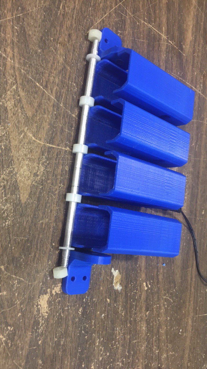

Not a bad idea. I’d use right angle though. Again, it’s SUPER easy to remove it if you use the hot glue in moderation.
Here’s some images of the final assembly.
image image image
#11
I love your idea! But I think it will be even better if lights are visible all the time.
Also, at the events they don’t give us much table space. Putting them battery up will save the space.
#12
You can see the lights, the quarter inch spacers allow it. Not as easily yes, but none the less you can still see them.
The intent, again, is to be in a suitcase, so I’m not designing for vertical efficiency, or ease of light visibility. It’s made for space efficiency.
