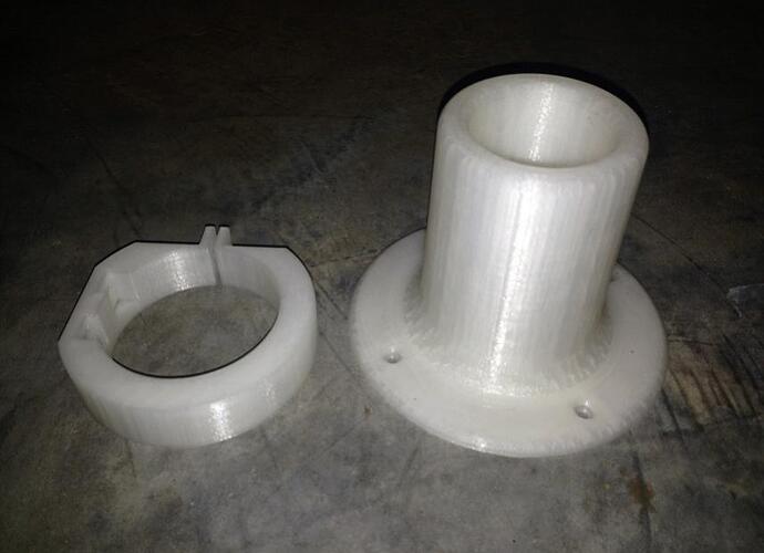

I never got around to showing this but earlier in the season we 3D printed a Skyrise base, Skyrise loader and post collars. The whole team was pretty excited about the idea of 3D printing field elements and we will more than likely be printing the elements for upcoming seasons.

That looks pretty good! Have you tried how the friction is on the base with sections? I could imagine that would be an issue if you wanted to use these elements with passive friction intakes.
Also, how strong are the collars/autoloader?
The base looks a little taller than the actual piece but it is still good use for practicing.
It’s really not much of a difference compared to the actual base.
We can bolt them down pretty tight and we’ve never broken one, even with the robot being aggressive with the posts.
The model is actually taken from the official field CAD distributed by VEX.
I don’t know maybe its the angle

Were you able to print without supports?
I am looking to print the same objects and I’m not sure if some of the overhangs are going to be too much for the printer to handle.
They can withstand all the forces that VEX robots could apply. We’ve also dropped the base a few times.
We didn’t use supports on either of the parts. However we had to modify the model by filling in the hollow areas.

So I printed the post brackets just fine. Copied them from the field CAD file provided by VEX. They print without any modification, other than flipping them upside down so the flat part prints first.
But the skyrise base is more difficult to print because in the model it has very thin walls which are not strong enough. I cannot figure out how to fill the hollow space in the model like you say you did.
Please help!
I used Autodesk Inventor to edit the model. But I created a sketch on the bottom face of the base and just extruded to the next surfaces.
I may be able to post a file later today.
Here’s the model of the skyrise base. It is in STEP format.

Thank you very much for posting the printable base. I already printed all the post clamps…now I can print us a skyrise base!
Update: I am printing my skyrise base right now! I will post some pictures of it, and the clamps we printed when completed.
