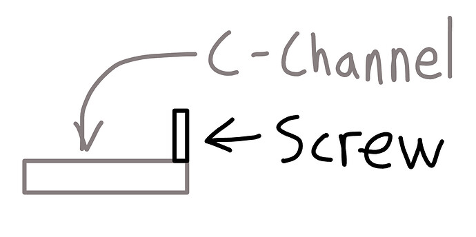

Its not a price thing for our team, we are not a school team, but our competition is on saturday and our robot is still not yet built.
In that case, a c-channel (or similar part) with a few screws should do the trick:
