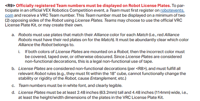

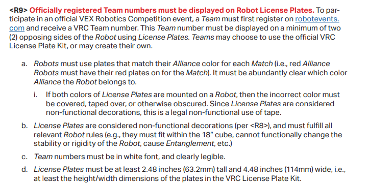

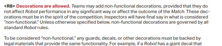

check out r7 r8 and r9 of the game manual
game manual
and here are some screenshots (Incase you dont want to or cant open the link
