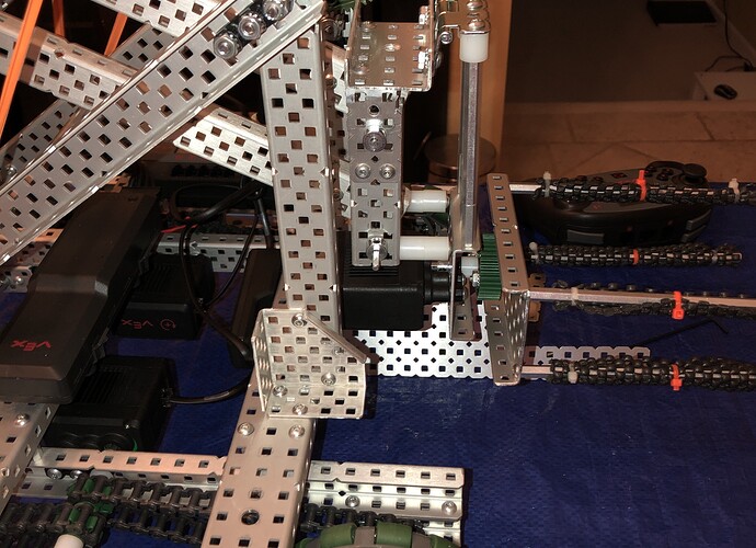

#8
Here’s a picture for anyone asking. The motor is getting stuck on one of our supports for the base. It starts out below the channel, able to clear it only if it moves straight up but it does not. Moving the whole thing forward helps but we don’t have much more room to spare for that.

#11
Looks like you’re powering it from only one side of the lift, is this correct? That would result in lopsided movement.
You could fix it by moving your motor out of the way of the lift, and then using a long (well supported) shaft and chain to power both sides.

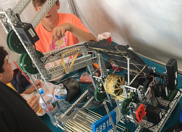

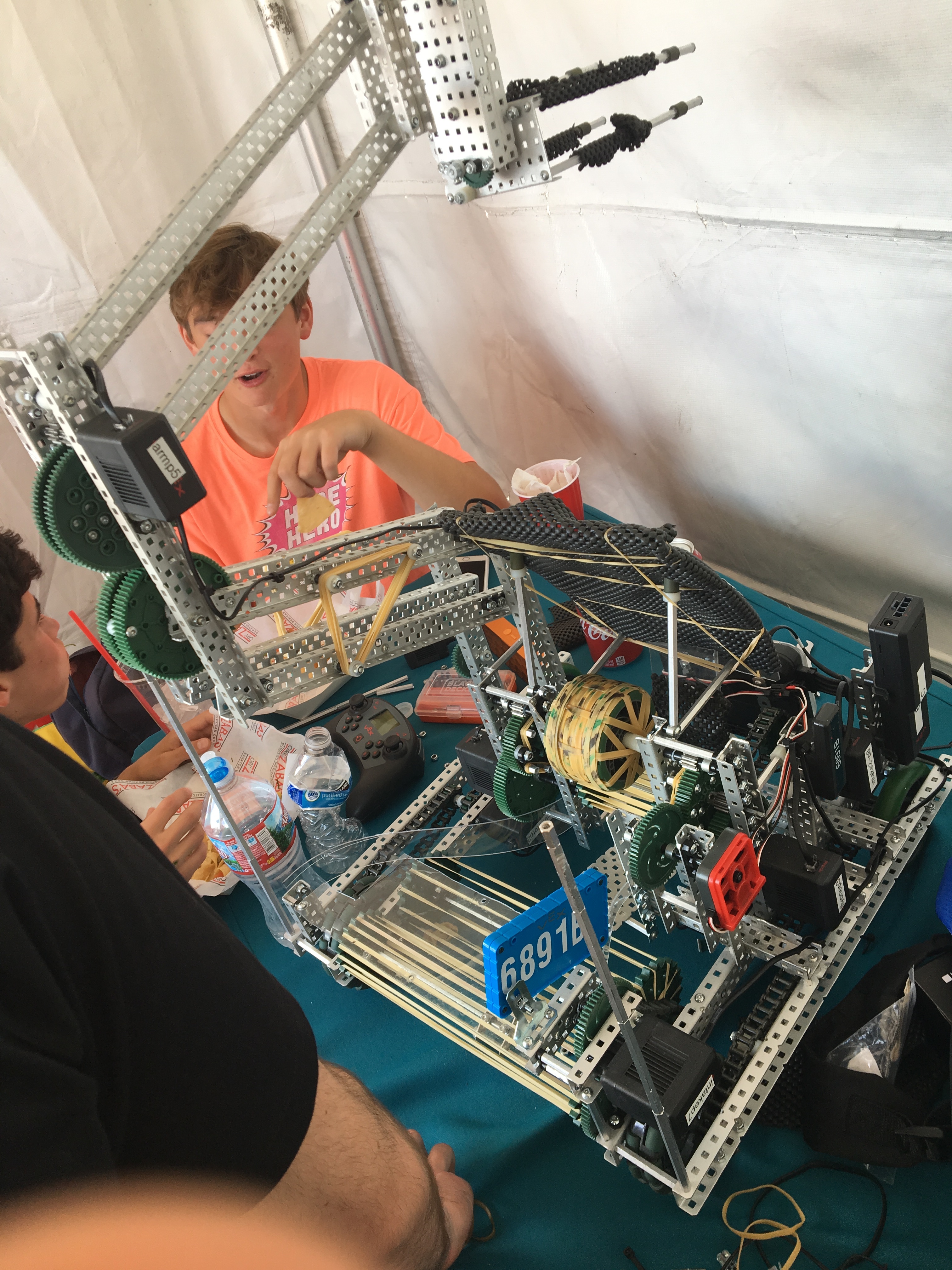

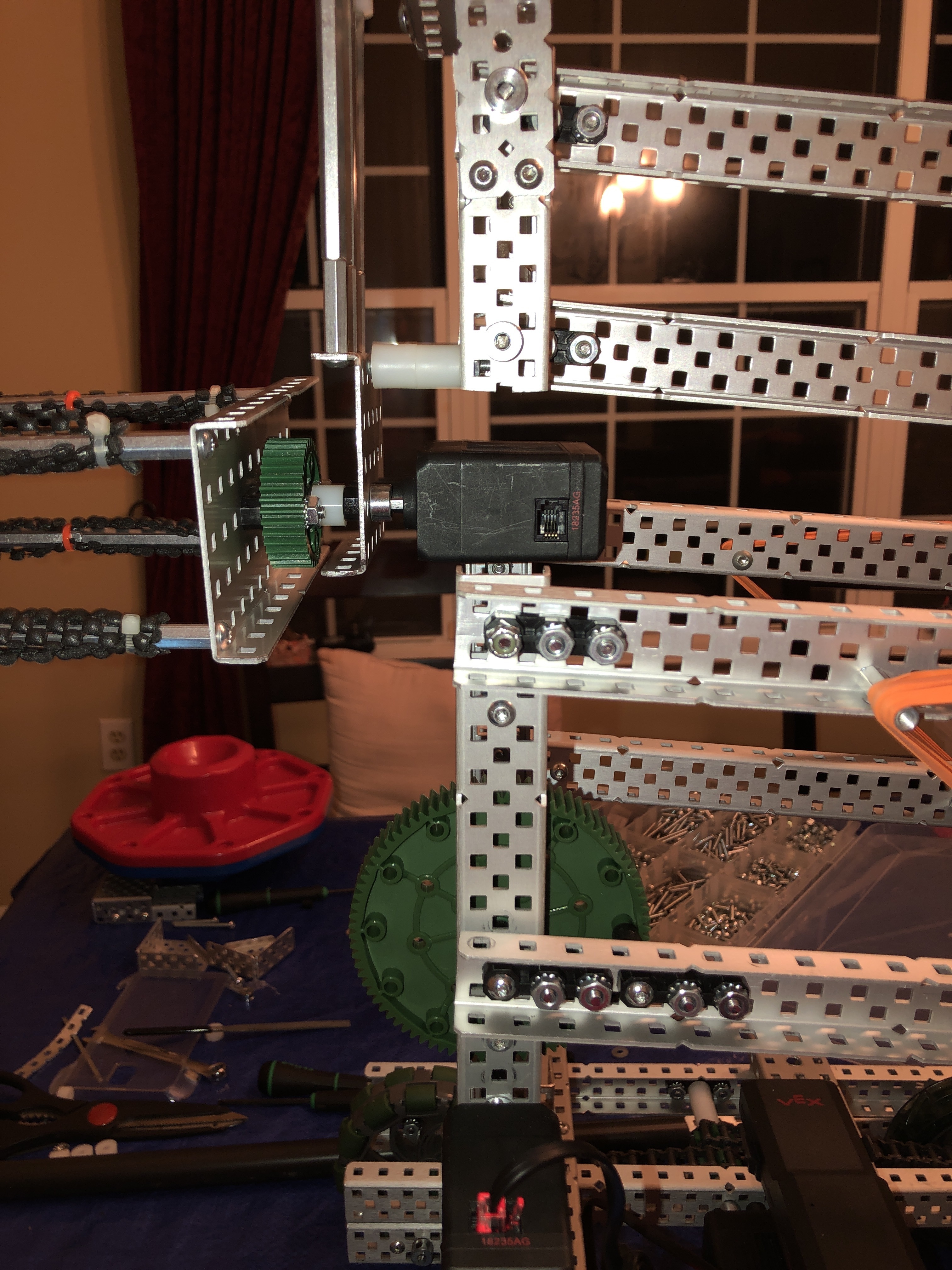

#15
You can power a dr4b with one V5 motor from the middle section no problem. See the attached picture of an early version of my teams robot which has this.
You could fix this issue by moving the motor. If you look at the cap claw in the attached picture you can see it is attached to a gear box, and the motor is mounted on the same side as the claw but above it. You can’t see the motor in the picture because we had taken it off, but it works.
#16
That makes sense. We will try moving the motor to a similar position. Thank you for the help!
#17
Make sure that you make the gearbox tall enough that when you are flipping the cap it doesn’t hit the motor. I used gears in that one, but a chain & sprocket might work better. I think I also had that one mounted on a hinge so that it could flip out.
