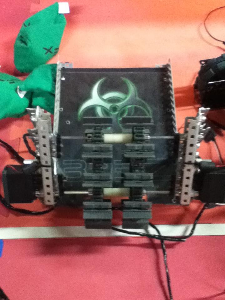

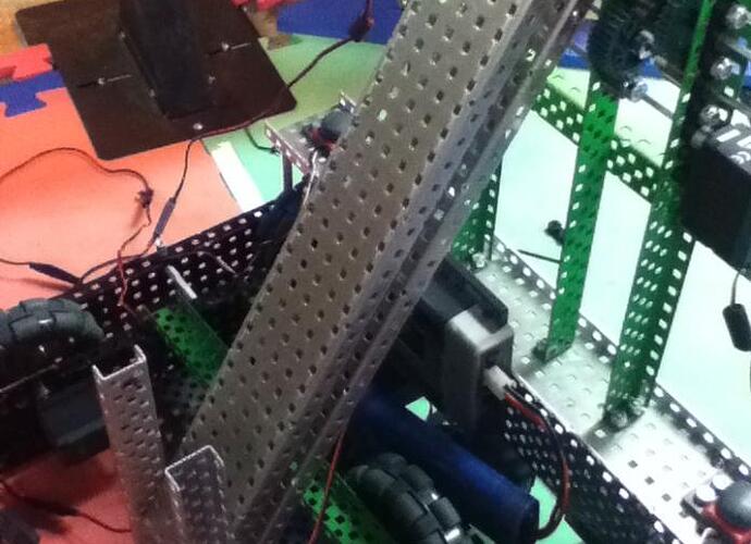

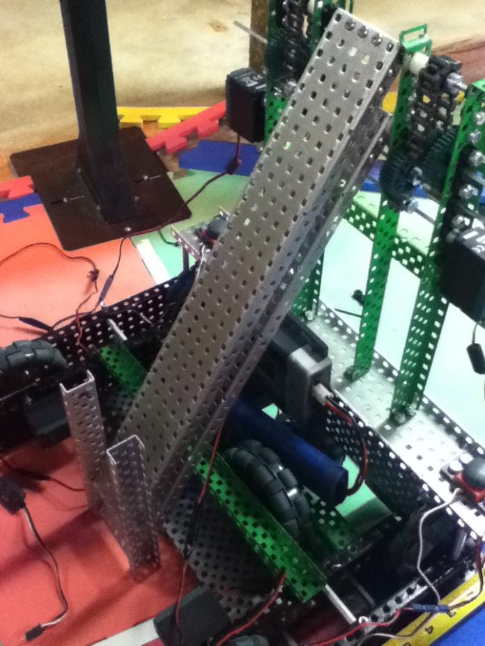

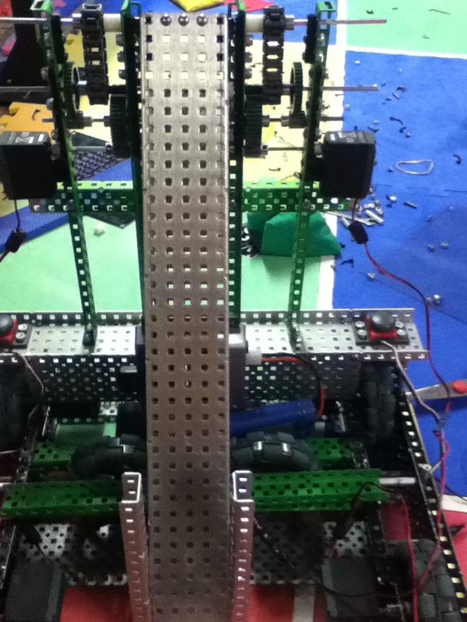

Alright, I was going to wait to reveal the whole thing, but I need some help. We changed our Chain Bar to a 4-Bar. We can’t figure out how to attach the intake. I have 3 pics for you.
We have about 3" forward till the 18" limit. How would we put the intake on, with a good angle (not the arms starting angle)?

Well when you do a single 4 bar, you really have to have the table at the arms angle. That’s one of the reasons Owen and I stayed away from the single 4 bar and just did a 4 bar on each side. Also, how did you attach the 4 bar to the axle which will power it?
So there is no way to get the intake at a smaller angle than the arm? Well I stuck the axle collars on each axle and screwed a screw through the metal arm and into the axle collar. That kept the collar tight on the axle.

No I’m pretty sure there isn’t because the 4 bar restricts how angled the table can be.

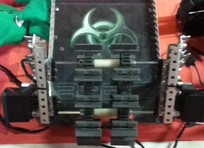

If our intake was lexan, I would need to cut a hole for the “tower” thing at the end of the intake. If I did that, I would have a big gap in the middle, maybe I can just have that “flap” be the same angle as the arm, and when the arm came up, the flap would fall down giving the intake more room…

I would suggest creating two towers on either side, instead of one in the middle, as it gives you ALOT more room for intakes.

I assume the “tower” thing you refer to above, are the 2 vertical bars at the front of your 4 bar arm? Your lexan intake ramp would need to fit over the top of these, so you would need to cut them, leaving only 1 hole extending above the top arm bar pivot hole. Attach 2 pieces of aluminium angle on the underside of your lexan, spaced so that you can bolt them to the top of the vertical front bars of the arm. You could then fix a 45° gusset on each side (or some other structure to create a triangle) to help hold the lexan ramp at the desired angle.
Can you make the lexan ramp any shorter at the back? (do you require the current full length to hold your full capacity of sacks?) as the shorter you make it, the shallower you can set the angle of it without it hitting the top of the arm (bearing in mind the lexan still has to reach the ground at the front).
If the lexan ramp is still too steep to operate well, you could consider lowering your tower so the top arm pivot point is at approx 10 inches. This will make the arm angle (and therefore the lexan ramp) a lot shallower. You would lose the ability to score the high goal, but you would gain the ability to drive under the troughs.

Another idea is to have it so that the front of the intake just sticks even further forwards (but folding back to fit in size). That’s what we did for our Worlds robot and it worked well, though to be honest, it meant the turning was pretty horrible as the front would swing so much :confused:

Yet another idea is to have something similar to what Oats (2941) had last year when they had a single set of arms (and like what 1107B used on their first robot). In this way you would start out with one single set of arms at the back, but they aren’t full length. From the ends of those, you build outwards, and then continue the arms as now two sets of arms, wide enough to fit the intake inside. Again, I will look for some pictures to aid the description. :slight_smile:

Lucas came up with the “fourked bar” (forked four bar) idea post RWC last year. At the tower end, it is a short (~ 4 inch) single bar, but then there is a wide, cross-bar bolted to it and a piece of aluminium C channel arm fixed to both ends. It is the shape of a set of 2 pronged forks that wrap around either side of the intake. It allows the intake to be set at whatever angle you want.
Advantage - don’t have to worry about keeping 2 separate towers and arms in sync. Also, it was unique last year, which appealed to the boys, as they did not want to do any direct copying.
Disadvantage - it had to be reinforced with steel angle at the tower end, especially the cross bar which deformed under load on the first build. Not a big concern though, as this added weight is near the tower end of the arm.

A little off topic, but you may want to support the towers of the two bar more. Once you add any weight to the end of the two bar, the whole thing may just topple over, and then it won’t matter how you mount the intake. :stuck_out_tongue:
Like the other commenters, I would suggest you use a four bar, and that you use the normal C-channels to lift. The fat C-channels weigh more than 2 regular C-channels combined (since the normal ones have the middle holes), so you’ll actually be saving a little weight.

Hmm… It sounds like you are putting the load of the arm on the axle itself. This has been known to cause severe shaft twisting… I would suggest bolting the arm to the sprocket/gear that is powering it. That way the shaft does not bear the rotational load of the arm, all it does is keep the gear and arm in place.
The advantage of switching to a linkage arm is that it’s easier to apply elastic, which makes it able to lift a lot more weight. For the sake of simplicity, I would have two towers and two arms, with the intake in between. It’s lot simpler and easy to build, and when your intake is mounted firmly, it helps keep the two sides in sync.

This robot has a 4-bar lift with a center arm. We’ve always preferred 2 arms for stability, but it does reduce the width of the intake, if that’s important to you.
