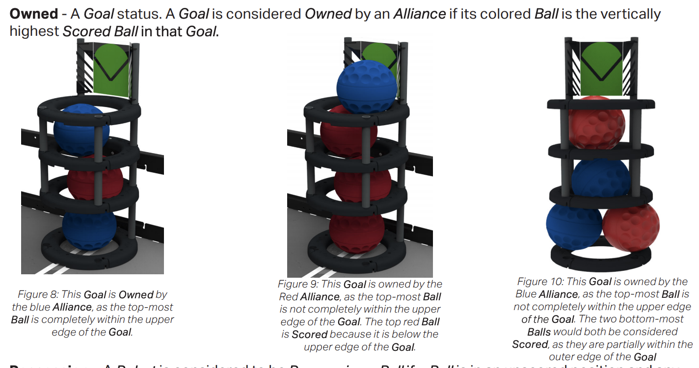

there is only one row. rows are determined by 3 owned goals in a row. In regular matches, a goal is owned when your color is on top.

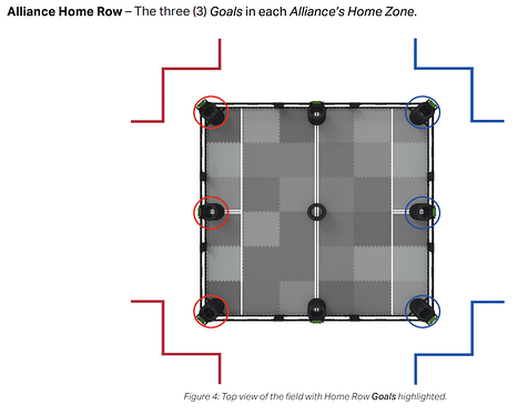

  1. WP have nothing to do with individual matches. It is a metric used to rank teams. You get 2 for winning a match, 1 for a tie/home row, and 0 when you lose a match
  2. I don’t get the wording of this so I’ll go over the whole thing. If all of the Goals in your Alliance’s Home Zone are Owned by your alliance then you get 1 wp from the autonomous. You can also get autonomous points from winning the autonomous

O, and if an alliance has the top ball corresponding to their color, do they get 1 or 3 points??
Thanks and sorry for so many questions.
And what are alll the ways to get win points?
you get no points for an owned goal. read the manual, it explains in depth how all the scoring works.
Ok,. One more question. Does “tank drive” mean that it is using omni wheels or standard or can it be both?
In the video, it said that if you score the top ball, you get all of the points.
