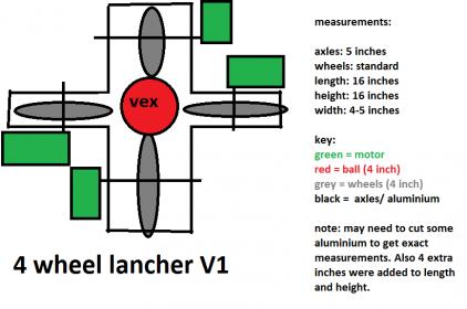

I’ve built a prototype and it works ok. I just need to increase the RPM of the motors. Which gear ratio would work best? Also here are one of my sketches.
[ATTACH]9362[/ATTACH]
With 4 wheels you could have halved the RPM requirement. Start with a 7:1 ratio to make the build easier and see what happens.
Is that the case for a 4 wheeled launcher? I understand that a ball in a single wheeled launcher has to roll twice as far as a two wheeled launcher assuming a no-slip condition, but what changes from a two wheel launcher to a four wheel?
it is the same speed requirements as a 2 wheel launcher. a good and simple ratio to start with would be a turbo motor to a 7:1 (speed) with 5" large wheels. it might not be perfect, but it should be able kick the ball pretty far. (theoretical 1680 RPM).
Well, if all wheels contact the same, each wheel contributes more kinetic energy to the ball.
But from the picture, it seems only two wheels will be touching the ball. :D:eek:
From an energy standpoint, that’s true. But from a geometric standpoint, it wouldn’t matter if you had 2 flywheels or 4: you would still need those flywheels to impart the same final tangential velocity to the ball because the final tangential velocity of the flywheel (= ball velocity) is what gets the ball to the target.
A single flywheel must impart a tangential velocity of twice the speed of the 2 flywheel configuration because of the geometric constraints. Of course, you have to think about kinetic energy when aiming for that final tangential velocity.
I guess the confusion stems from “At what speed must I run my flywheels before launching the ball?” vs. “At what speed must my flywheels be running when the ball is finally leaving the launcher?” Those will be two different values because the ball sucks up energy as it passes through the flywheels, so the flywheels slow down as they accelerate the ball.
So there are two major constraints to consider: the kinetic energy constraint (“How do I store enough kinetic energy in the flywheels to make the ball fly?”), and the geometric constraint (“How do I get the ball up to the speed it needs so it makes it to the target?”)
To illustrate how those are two different questions: theoretically you could have two flywheels that each weigh 100 tons and are 10 feet in diameter rotating with a tangential velocity of 3 centimeters/second. Those flywheels would have plenty of kinetic energy to provide to the ball, but their tangential velocity could never get a ball to fly very far.
On the other extreme: you could have two thin styrofoam flywheels spinning furiously with a tangential velocity well above what a ball needs to fly across the field, but the styrofoam flywheels, because of their low mass, won’t be able to store enough kinetic energy to provide to the ball, so the ball would just stall the flywheels and sit there (maybe with its skin on fire).

I was rushing when I made that sketch. Each wheel will be the same distance apart from the center.
